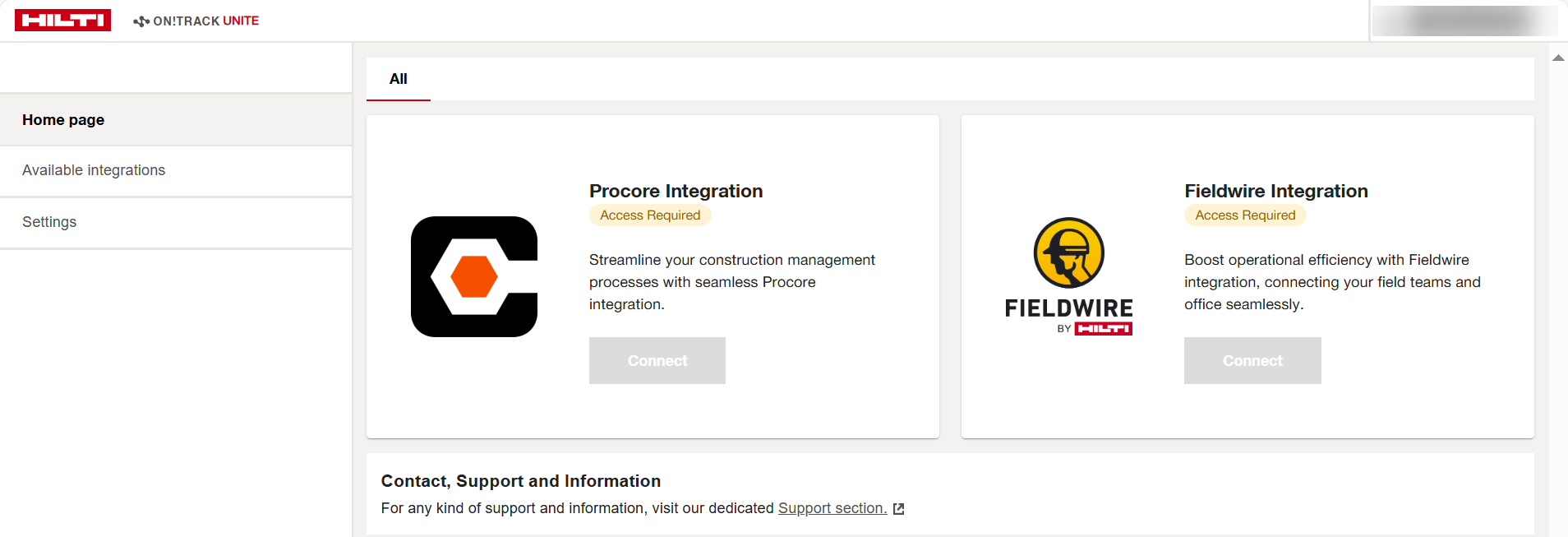

Landing Page
The landing page displays all available integrations (connectors) in the "Built for You" (B4U) portal, each clearly labelled with relevant details such as:
Access Required:  As the label indicates, access to this integration is restricted. To request access, contact the Hilti Support team. The Connect button remains disabled until access is granted.
Access Granted: Once access is granted, this label appears, and the "Connect" button is enabled. To proceed, click the "Connect" button to establish the connection.

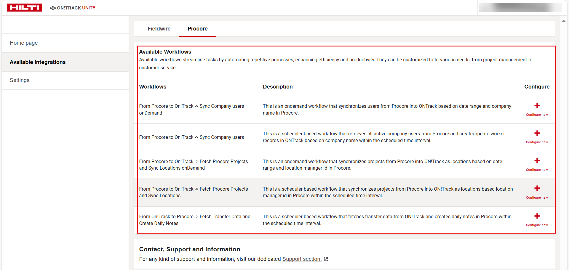

Available Integrations
This page showcases all the available workflows for the selected integration. To get started, simply click the ‘Configure New’ button below.
Please note that the ‘Configure New’ button will only be enabled once the following prerequisites are met:
A successful connection has been established for the requested integration (connector).
A connection has been established with the On!Track Connector via the Settings page.

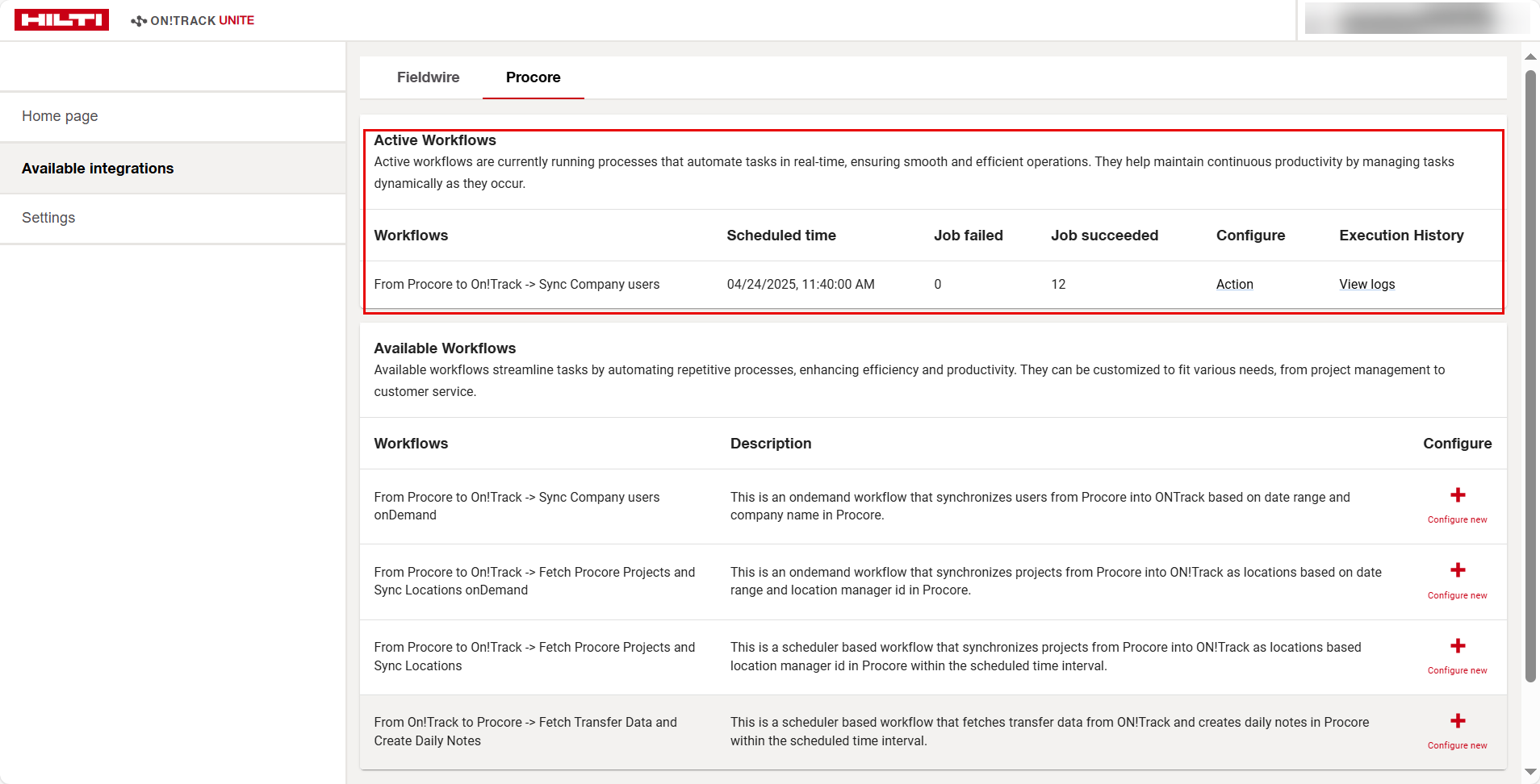

Active Workflows
This section, located on the ‘Available Integrations’ page, displays the workflows configured by the user.

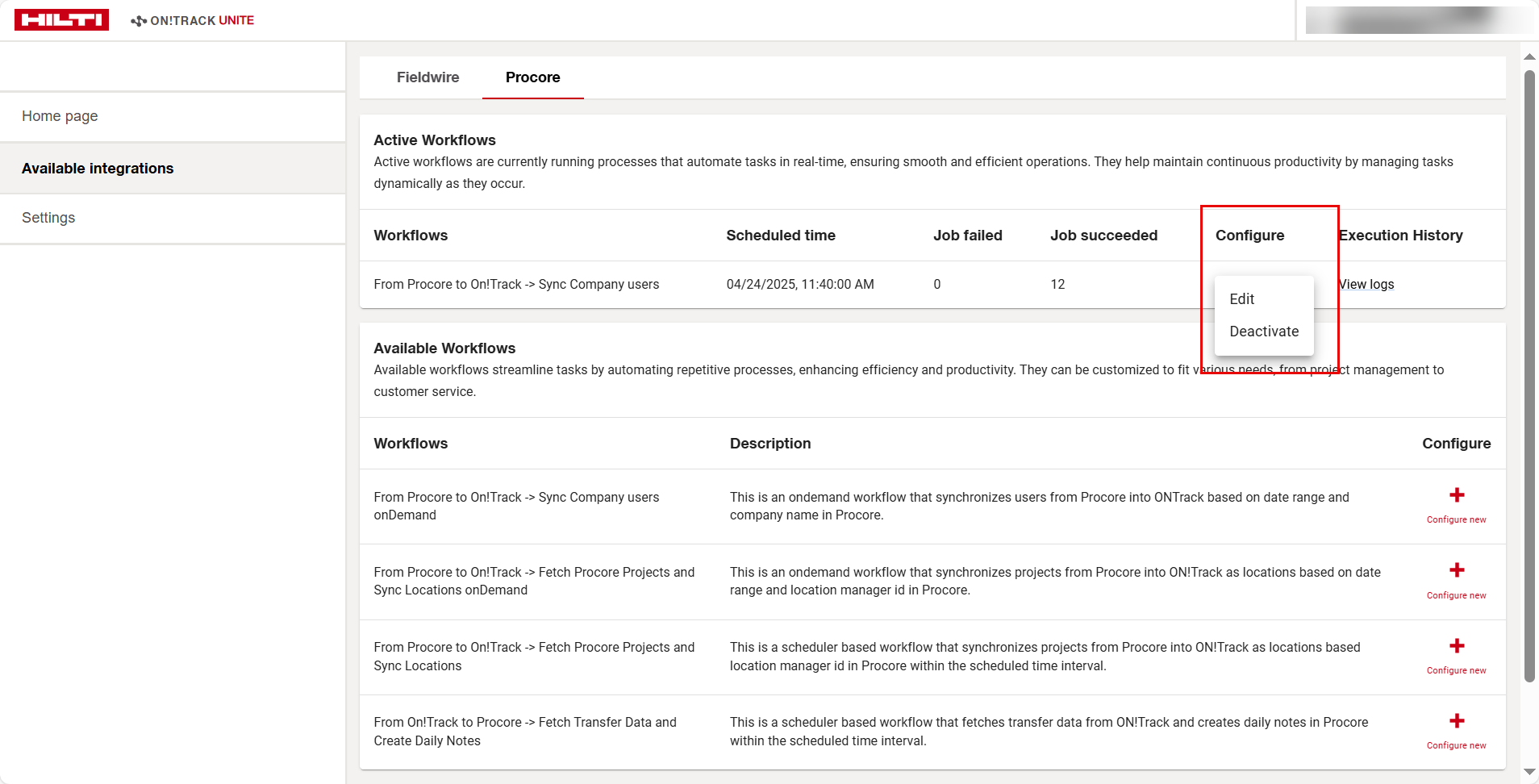

For each active workflow, two operations are available. Click on ‘Action’ to access the following options:
  • Edit: Updates the workflow configuration.
  • Deactivate: Disables the workflow. Once deactivated, it will no longer appear in the ‘Active Workflows’ section but can be reconfigured from the ‘Available Integrations’ section below.
Note:  The Active Workflows section will only be visible once at least one workflow has been successfully configured.

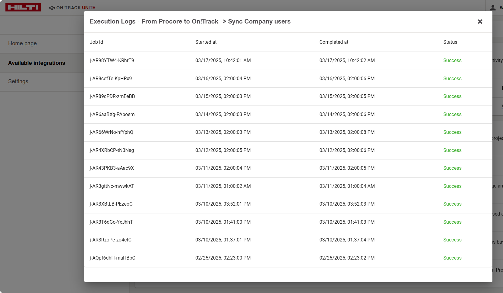

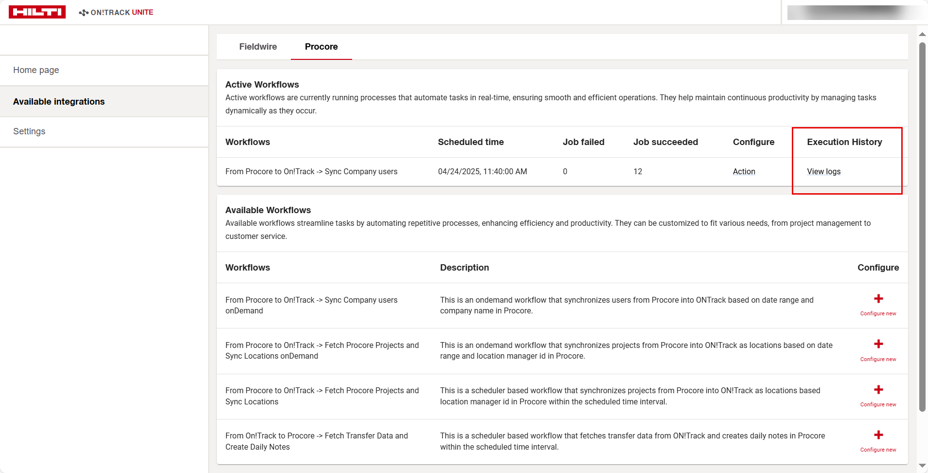

Execution Logs
This page shows the job run history for each workflow, accessible through the ‘View Logs’ link in the ‘Active Workflows’ section.

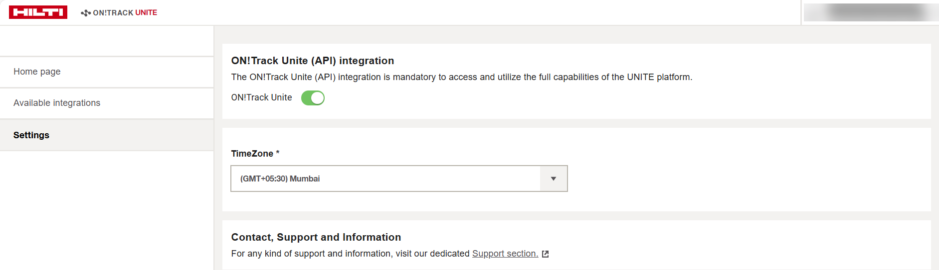

Settings
This page comprises the following that must be configured as soon as the user gains access to the requested integration:
ON!Track Unite: This toggle establishes a connection with the ON!Track application must be enabled before configuring any workflows.
TimeZone: To ensure consistency, the timezone must be specified before configuring any workflows. Workflows will execute according to the selected timezone.
