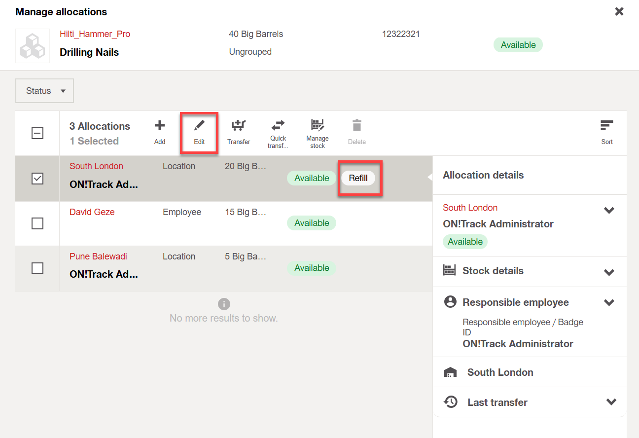

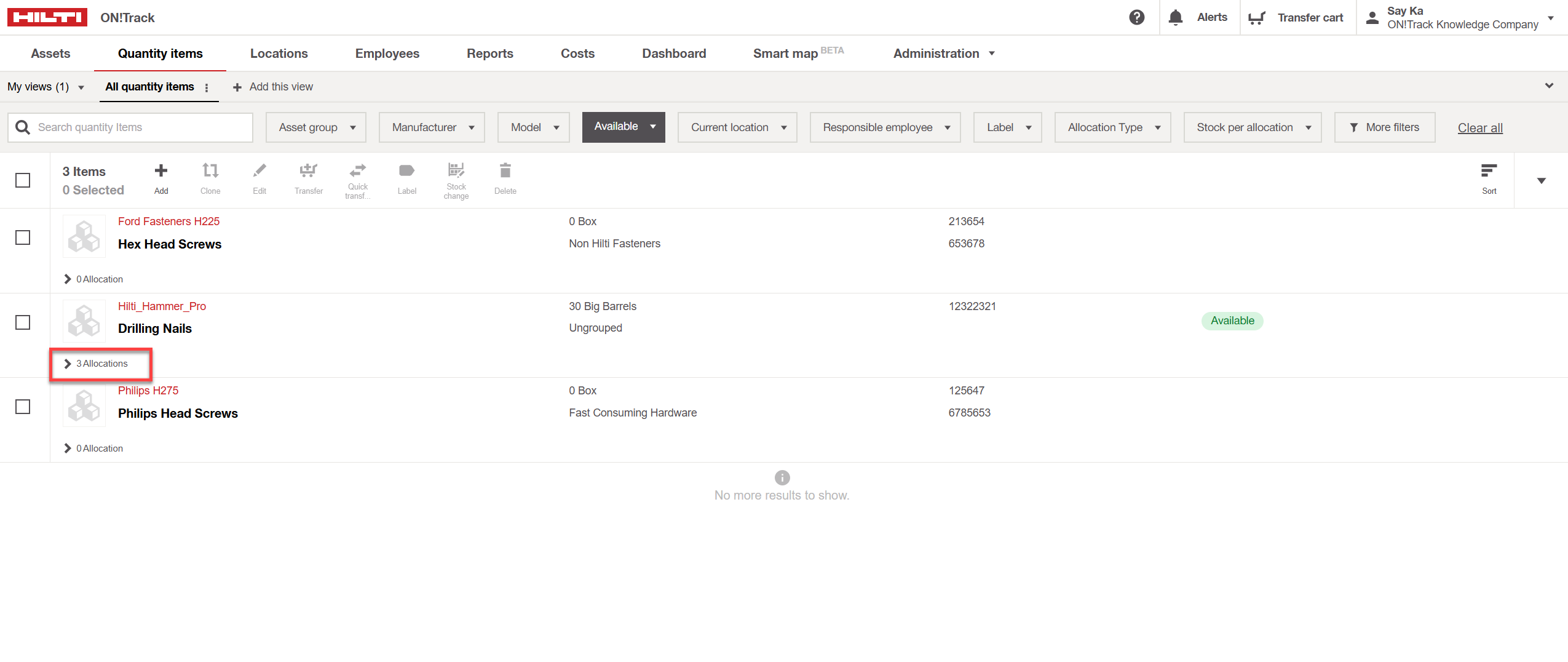

  • In ON!Track, go to the "Quantity items" tab and click on the existing allocations of the selected consumable:
  • Select the allocation and click on “Edit”.
    Note: Thanks to the Refill badge, you can easily check if the consumable at its designated location is part of the Refill service.

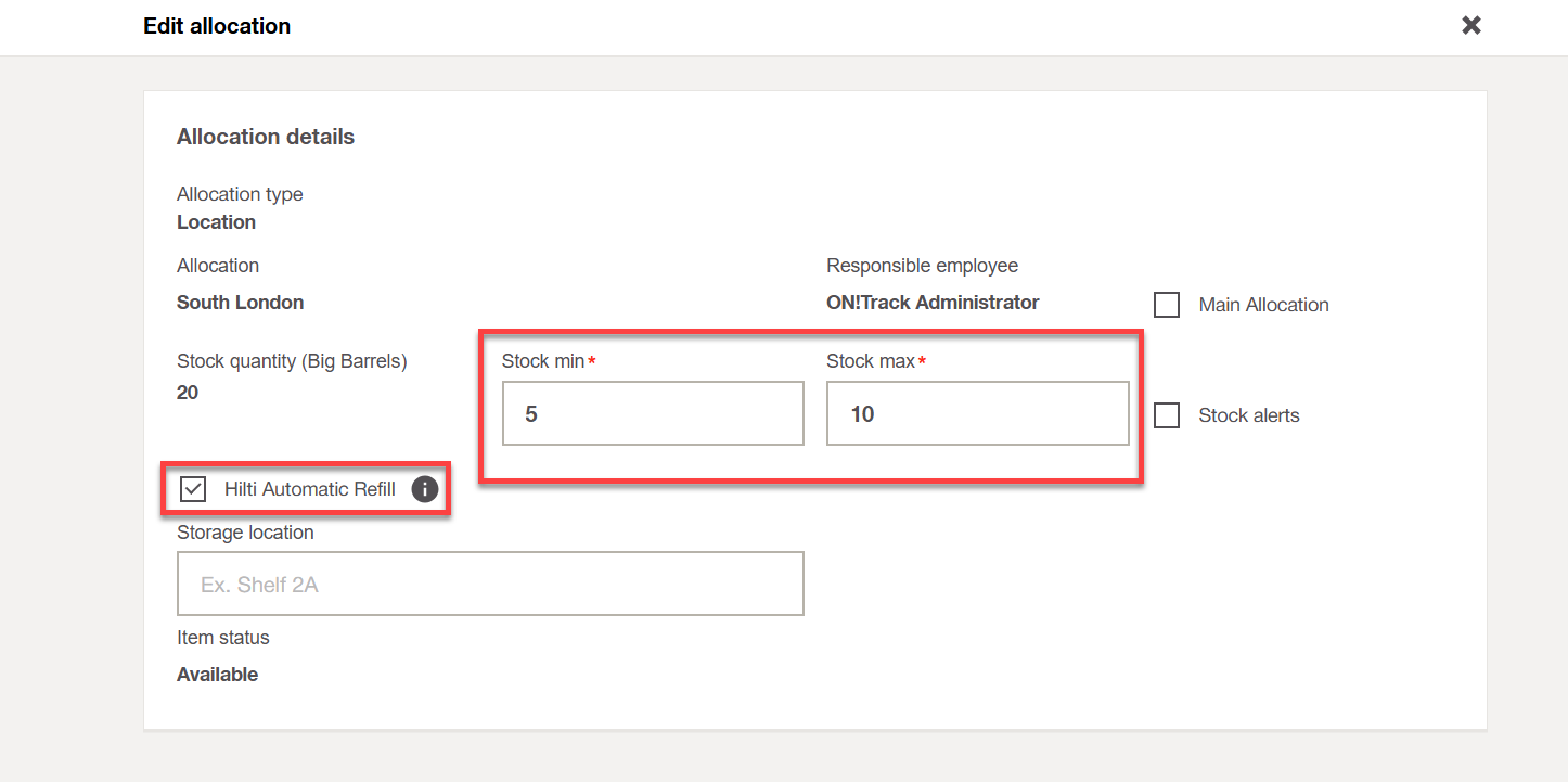

  • Check or uncheck the “Hilti Automatic Refill” box to enable or disable the service.
  • Change your desired stock levels. The item will be reordered as per your defined Refill settings and it will be refilled up to the maximum.
  • The stock levels are maintained in stock units. If the stock unit is different from the order unit, set the min and max as multiples of the Quantity in the package (Pack size).
Note: the location to which the quantity item with switched-on Hilti Automated Refill flag is allocated needs to be enabled for Refill. To check your enabled Refill locations, please contact your Hilti representative.
