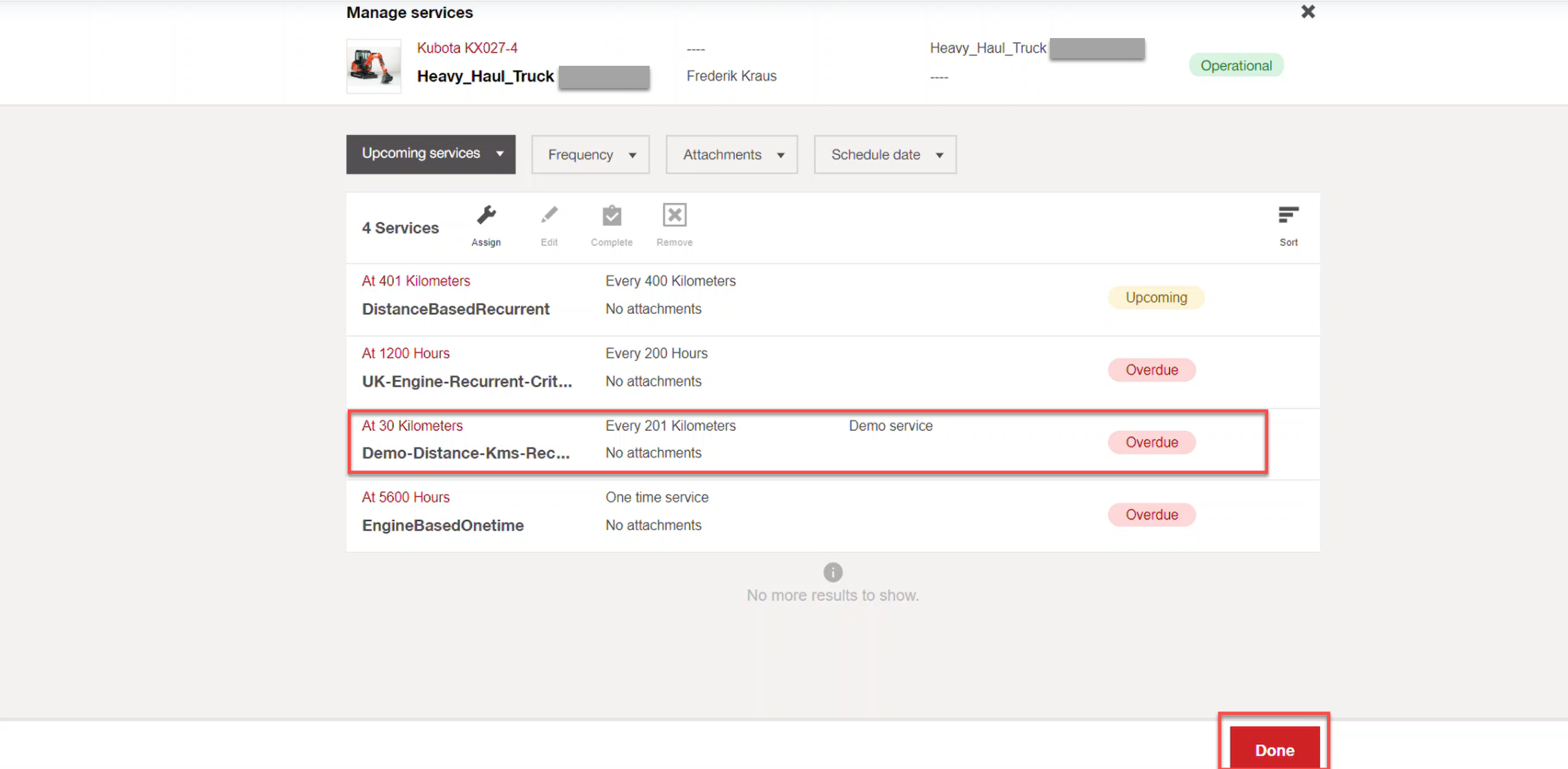

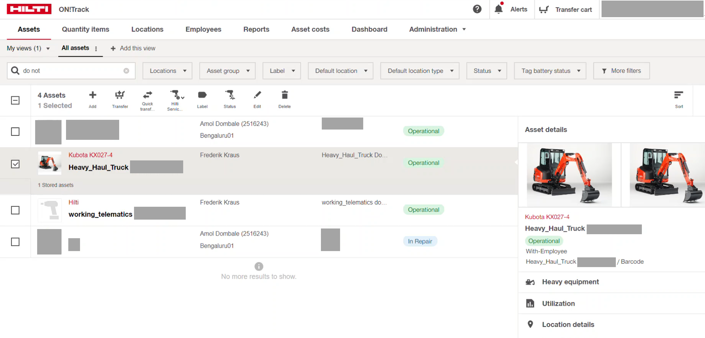

- Go to the list view "All assets" and search for the designate heavy equipment you want to edit the assigned service for.

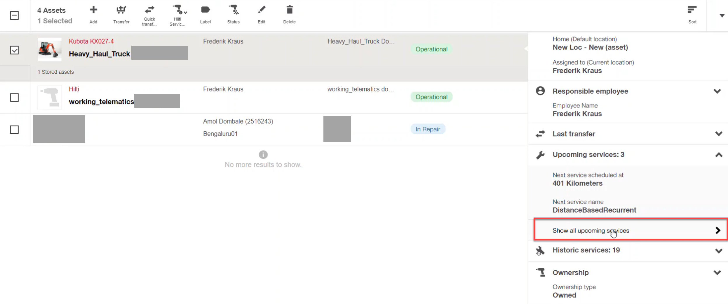

- Scroll down to the Asset Details section and open the tab called "Upcoming Services".

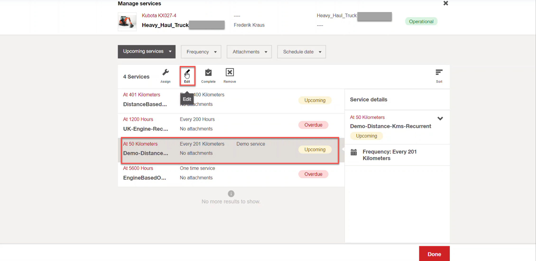

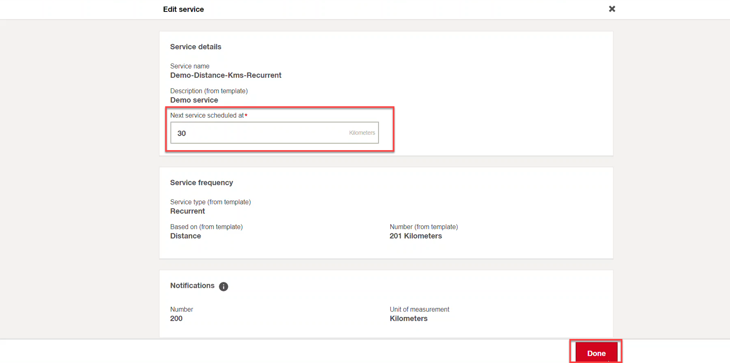

Click on "Edit" for the selected service and edit the required details.
- You can also reschedule the service from this edit page.
After confirming the edited service, ON!Track directs you to the upcoming service section, and you can see the updated service next to all other upcoming or overdue services for the selected heavy equipment.
