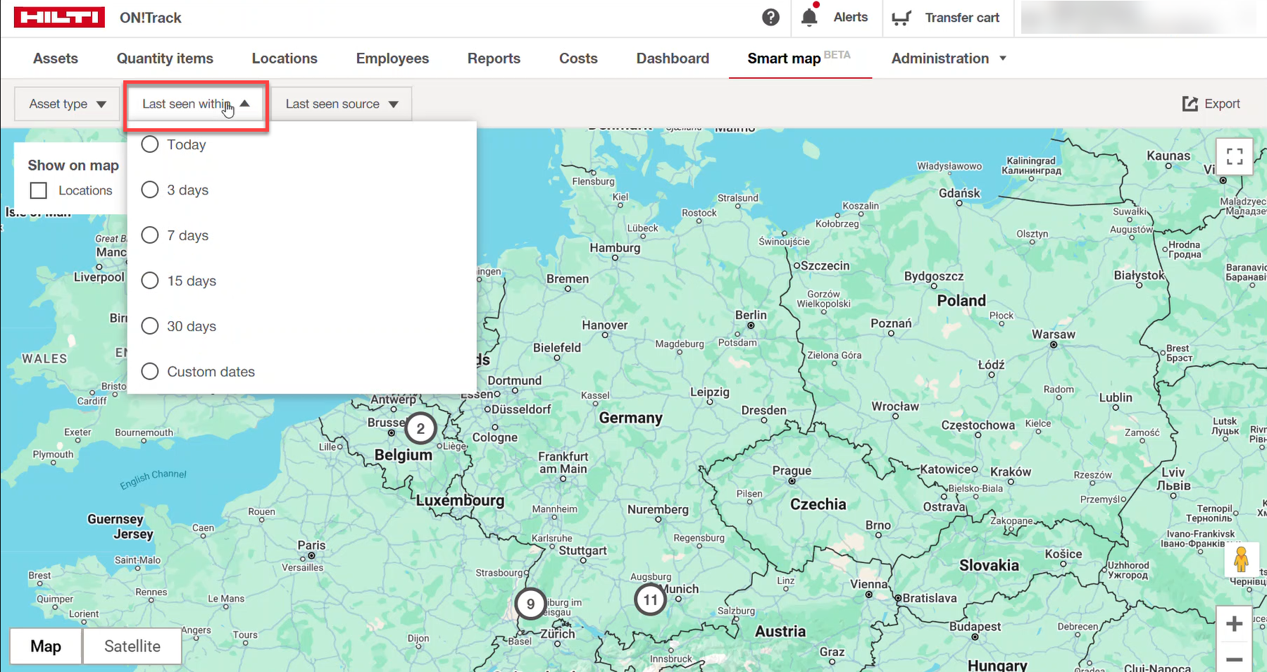

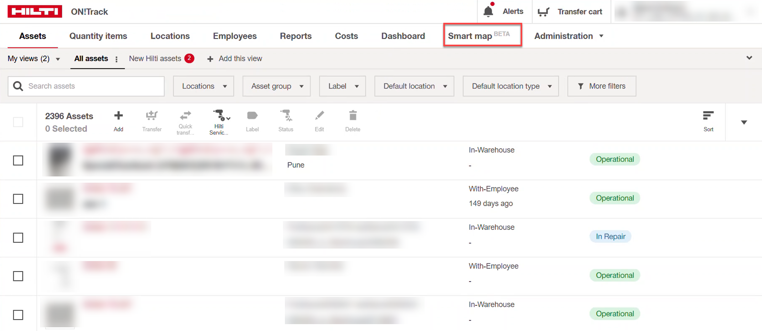

  • Select the Smart Map tab on the screen.

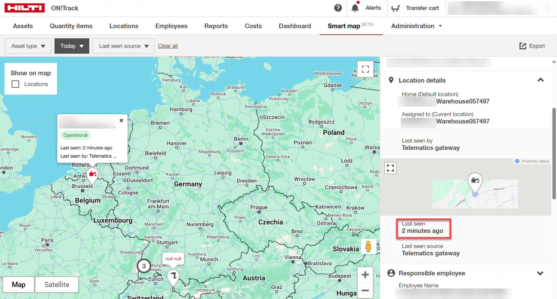

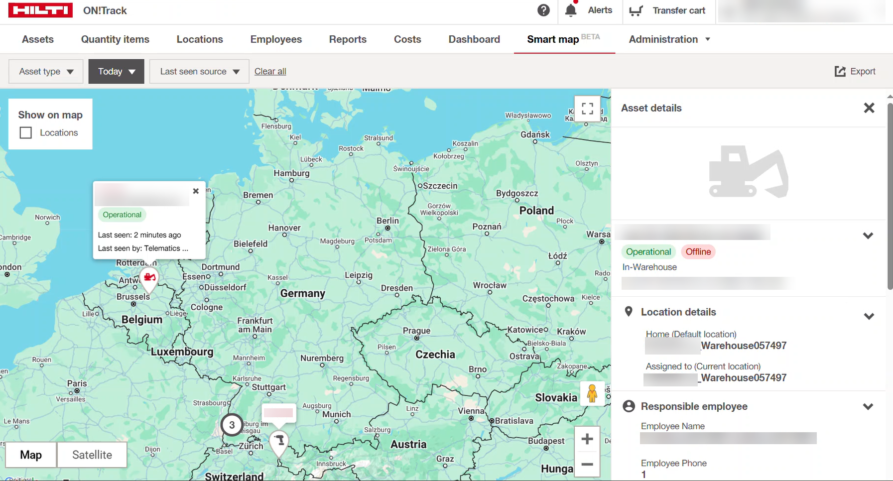

  • Choose the last seen within (select the required date range - Today, 3 days, 7 days, 15 days, 30 days or Custom dates) (for this article, we select "Today" date range) and zoom in to find the desired location on the map.
  • Select the desired asset to view its details.

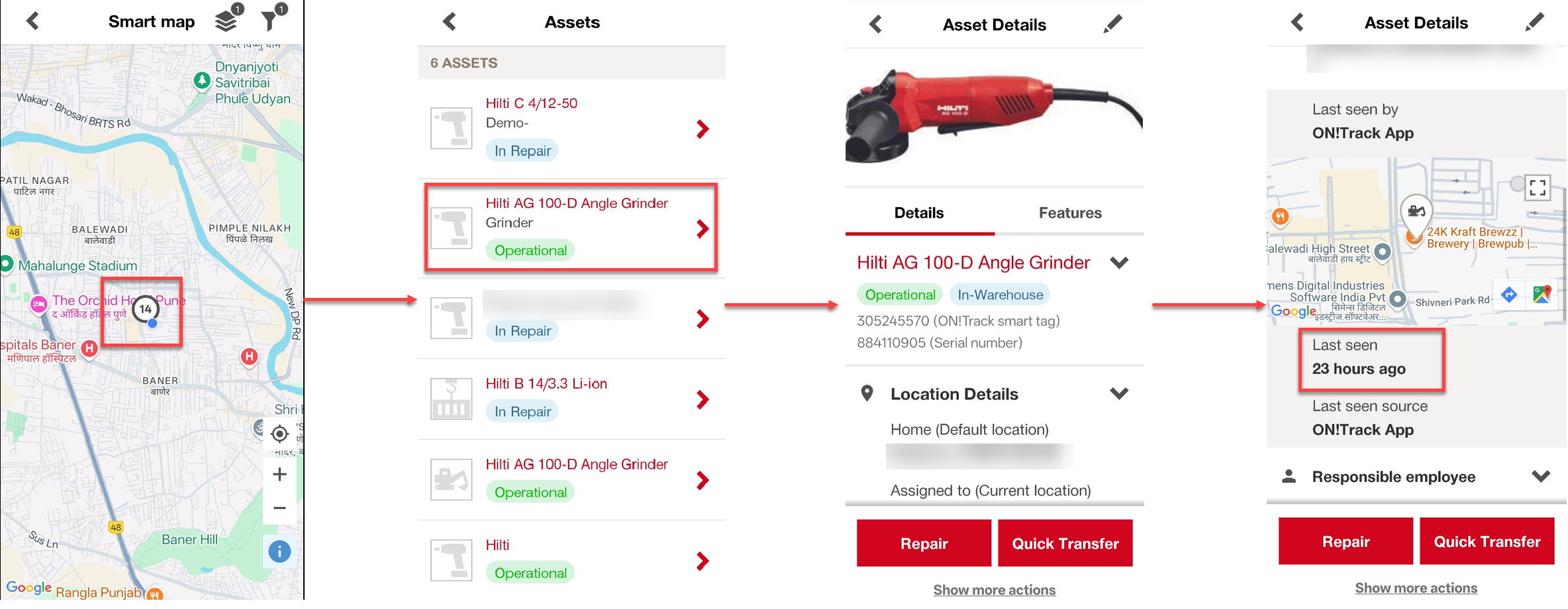

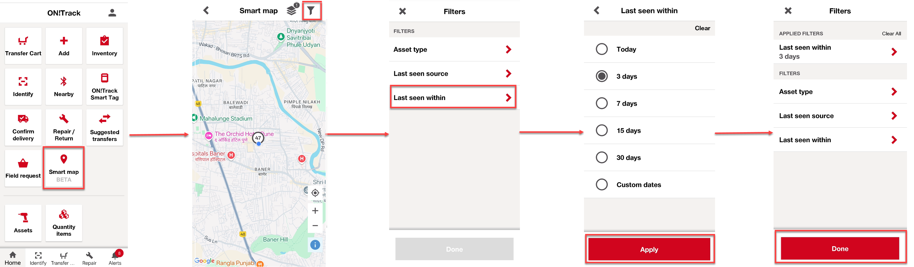

On Mobile Application:
  • Open Smart Maps, click on the filter option, select the last seen within filters, choose 3 days (for this article), click Apply, and then select Done.
  • Zoom into the smart map, select the desired asset, and view its details.
