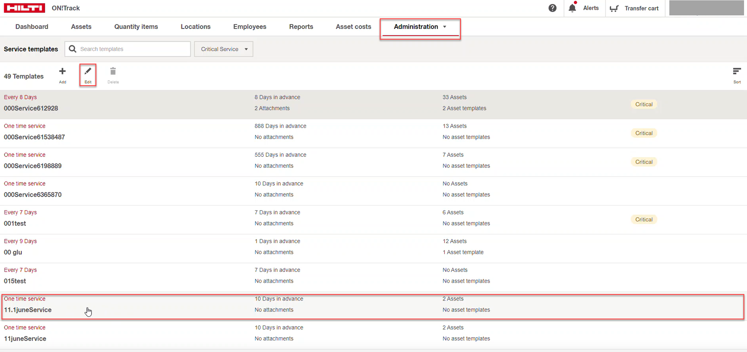

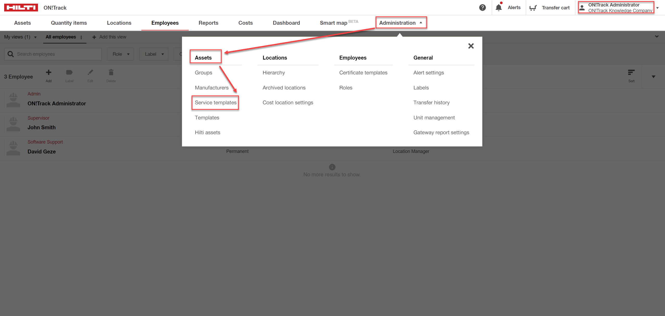

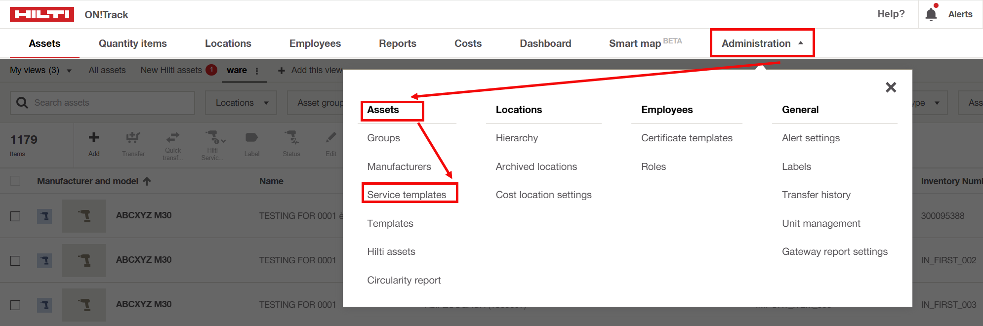

  • Click on the "Service Templates" from the tab Administration --> Assets.
  • Here, you can view and select the service template you wish to modify.

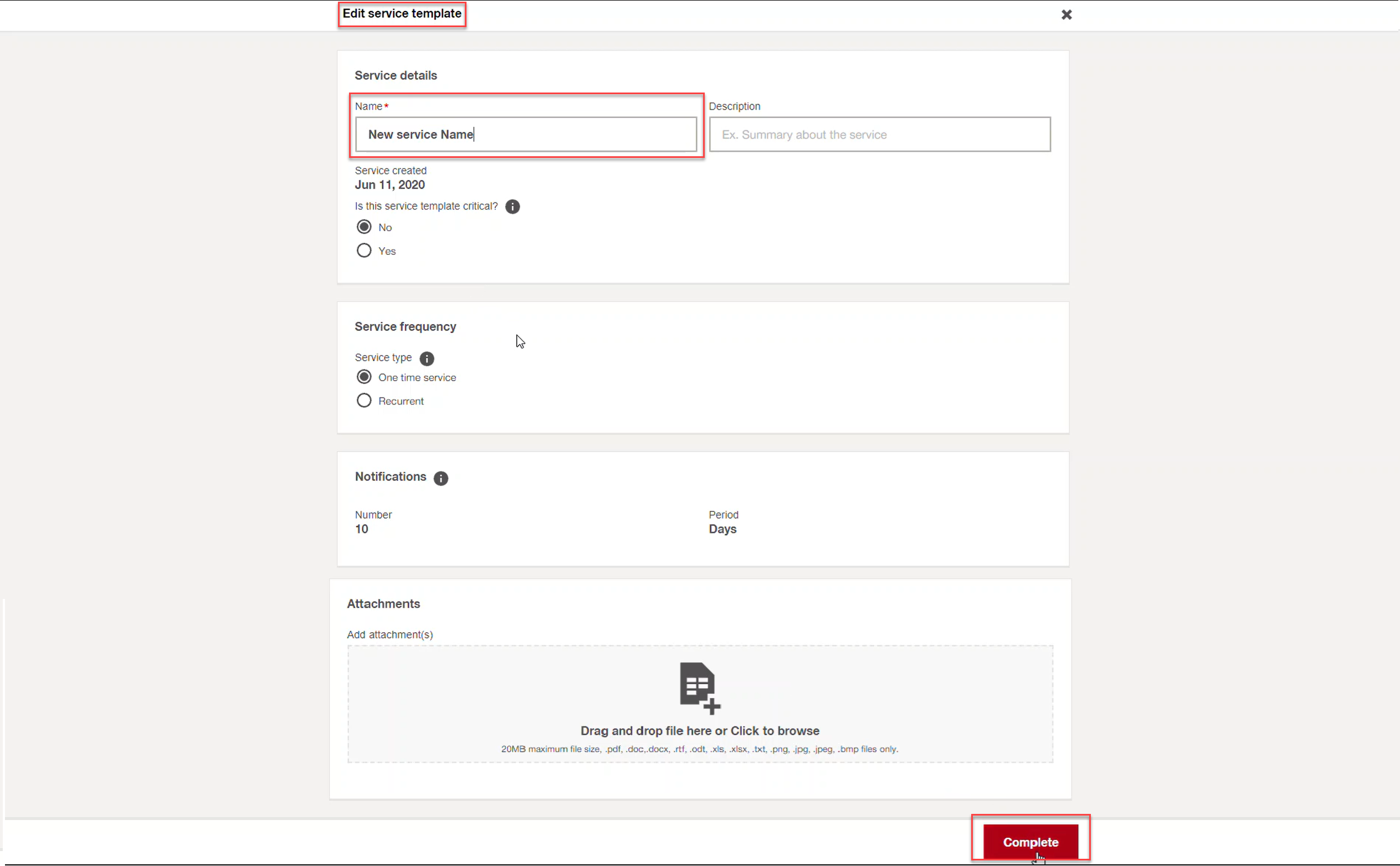

  • Edit the Name, Description, Service Frequency, Notifications, and Attachments you want to update. Then, click "Complete" to save the modified service template.
  • The Service Template will be updated in the service template list.
