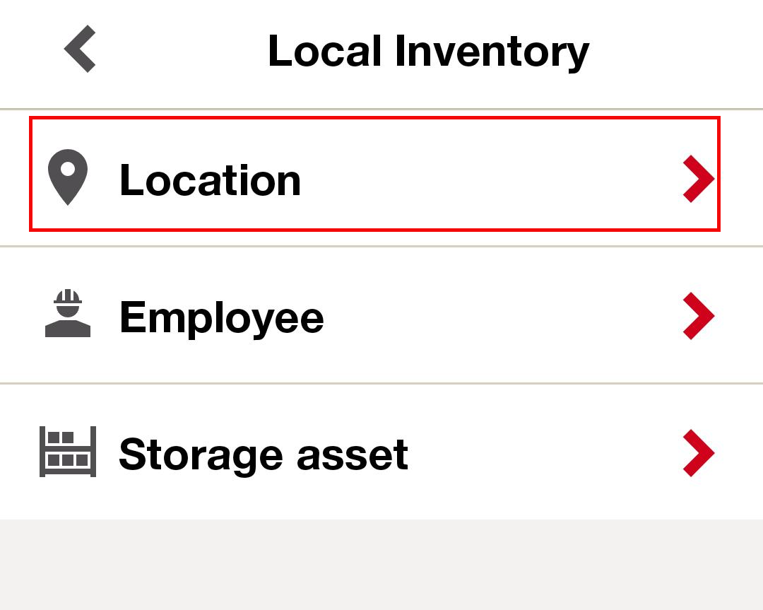

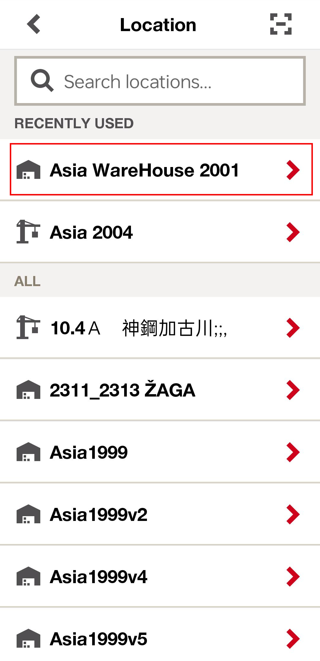

Inventory checks can be performed for a Location, Employee, or Storage asset. In the example below, we'll perform a simple inventory check for a warehouse using the iOS version of the mobile app (the process is the same for Android).
Steps to Perform an Inventory Check

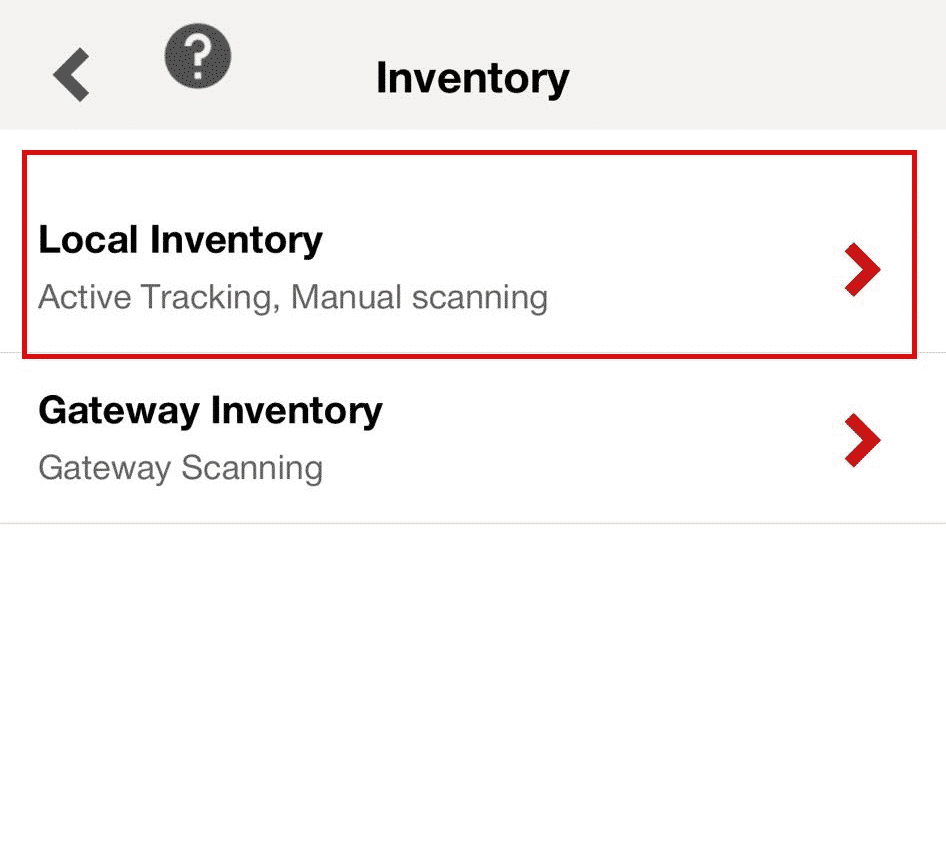

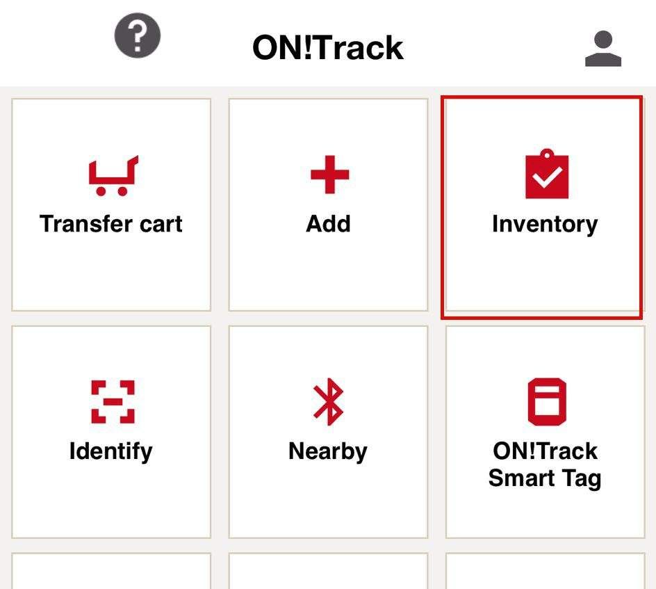

  1. Initiate the Inventory Check: Open the ON!Track app on your mobile device and start the inventory check for the desired location.

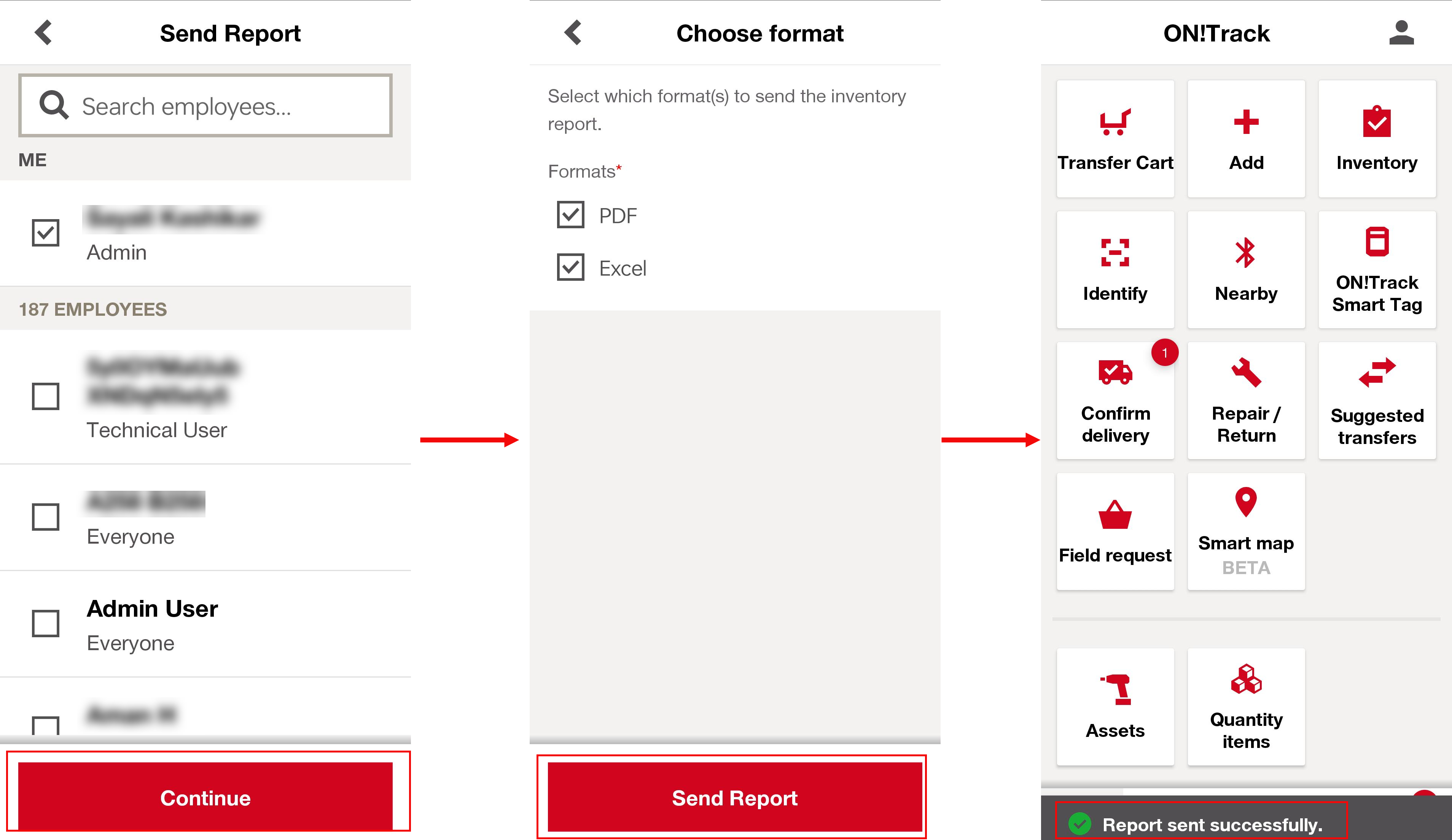

  4. Submit Inventory Check: Once the check is complete, you can select who you want to send the report to and submit the report.
Receiving the Report
After submitting the inventory check, the designated user will receive a report via PDF. This report will include details of what was Found, Not Found, and Unexpected.

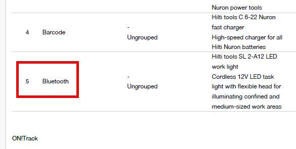

Assets with Smart Tags
Assets with smart tags will be automatically scanned during the inventory check. If found, they will be added to the Found or Unexpected lists and will be marked with "Bluetooth" under the Check method in the report.
