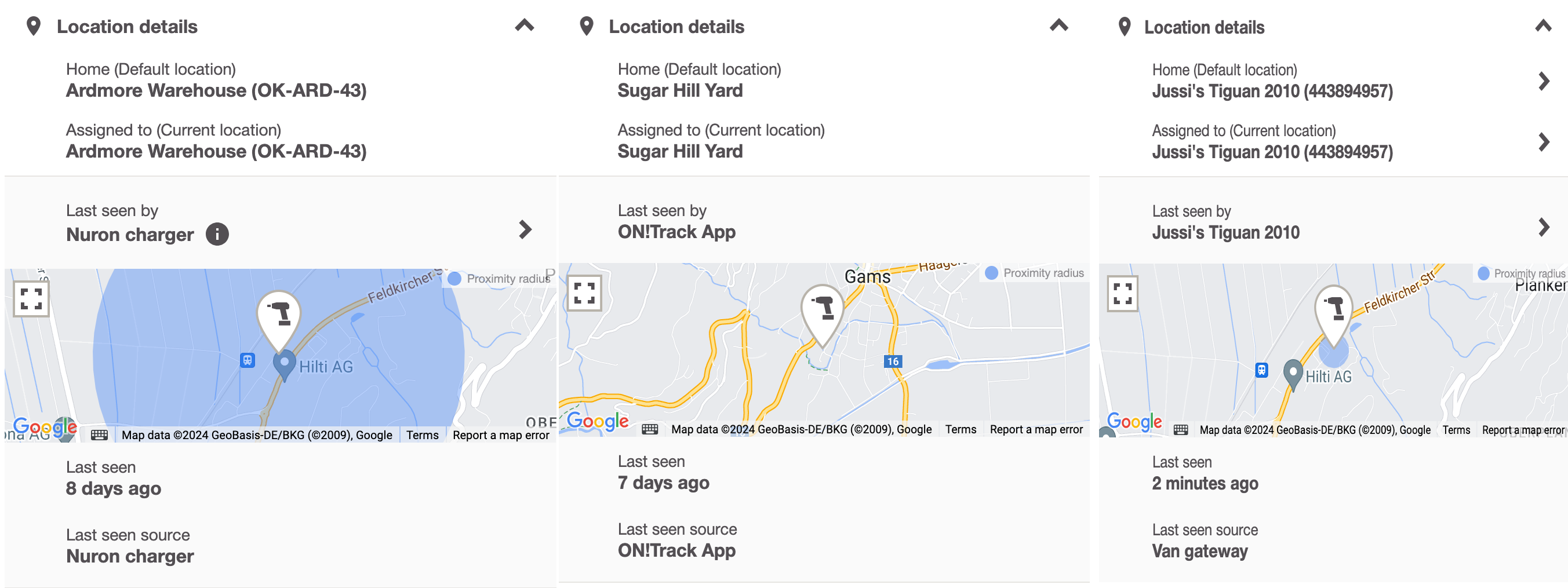

Note :
Sensor tags scanned by third-party van gateways from a different user are labelled with the source Global BLE Network.
  Stationary gateway Vehicle Gateway Telematics gateway ON!Track mobile app Nuron charger Global BLE network
Last seen by Name of the warehouse or jobsite or container to which the Gateway is assigned to Name of the vehicle on which the Vehicle Gateway is installed  Name of the heavy equipment on which the telematics gateway is installed  ON!Track app Name of the charger that the tool's battery was last charged with
No name is shown.
This location update is based on tracking of the tool by a vehicle or telematics gateway that belongs to the Hilti Cloud Services
Last seen e.g. 5 mins ago e.g. 5 mins ago e.g. 5 mins ago e.g. 5 mins ago e.g. 5 mins ago e.g. 5 mins ago
Last seen source Gateway Vehicle Gateway Telematics gateway ON!Track app Nuron charger Global BLE network
Accuracy
Logical location
very accurate as the address is entered by the user
GPS location
Accuracy supported up to 200m
GPS location
GPS location
GPS location
Accuracy supported up to 6000m
GPS location

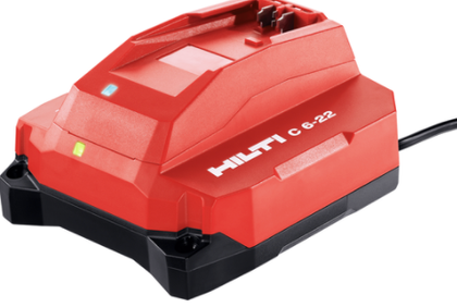

Nuron tools and batteries have a unique form of active tracking that is integrated into the tools themselves. This method, known as 'Last Charged Location,' updates the location data whenever the battery is charged, although it’s less frequent and less accurate compared to Sensor tags and gateways.
How It Works
  • Unique IDs: Each Nuron tool and battery has a unique identifier.
  • Usage Information: Tools transmit usage data and their IDs to batteries during use.
  • Charging Process: Batteries send data, including their ID and tool usage info, to chargers during charging.
  • Cloud Communication: Chargers equipped with communication modules send data to the cloud.
  • Location Updates: The cloud updates the 'last seen' location of tools and batteries based on charger locations.
  • Continuous Tracking: This process ensures periodic location updates even without active Sensor tag tracking.
