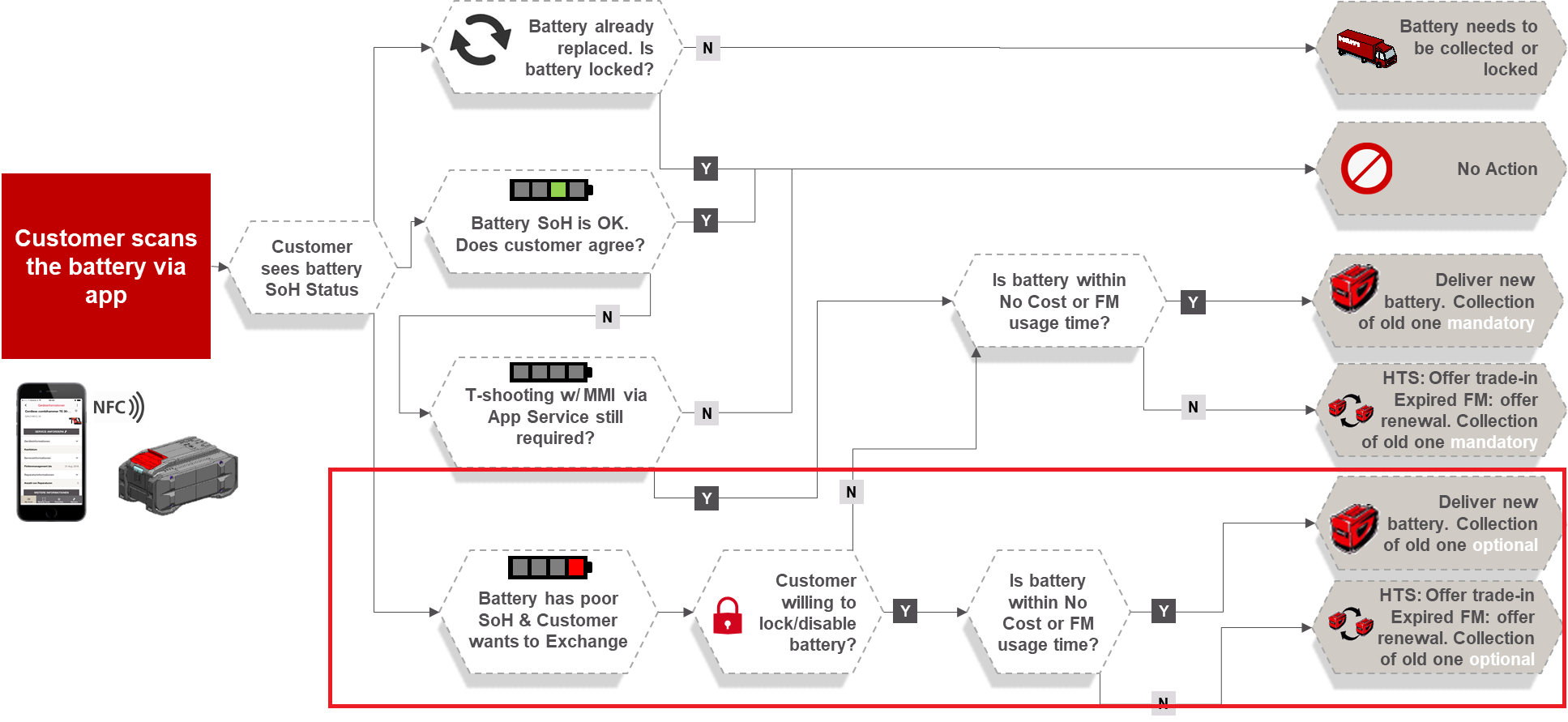

This flowchart provides a detailed overview of battery health, exchange, and locking.
