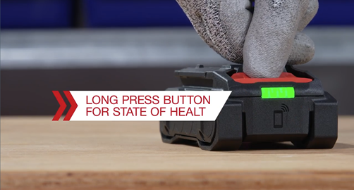

  • Take a Nuron battery and long press the button on the battery for >3 sec.
  • The battery will start the algorithm to check its SoH.

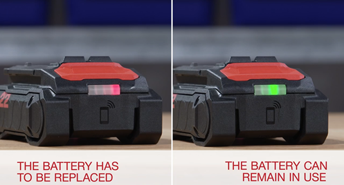

  • When ready the battery will display one of the following options
    • A green solid LED - Everything is fine!
    • A red solid LED - Battery is end-of-life!
