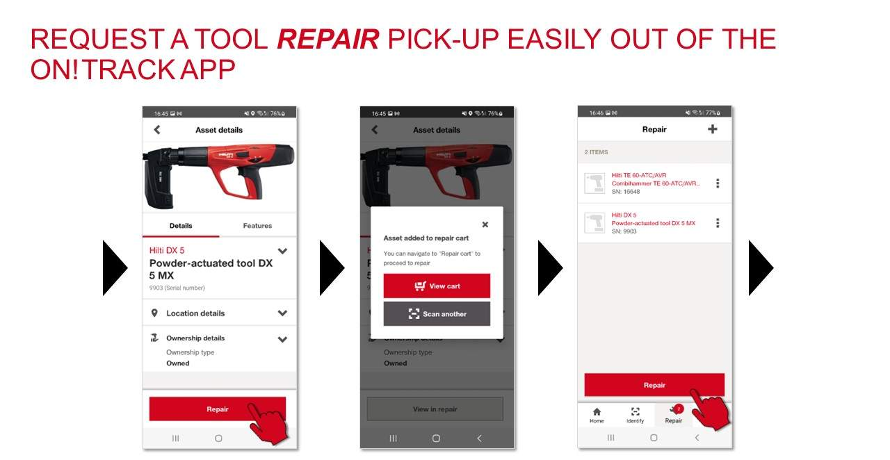

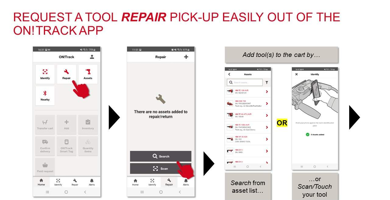

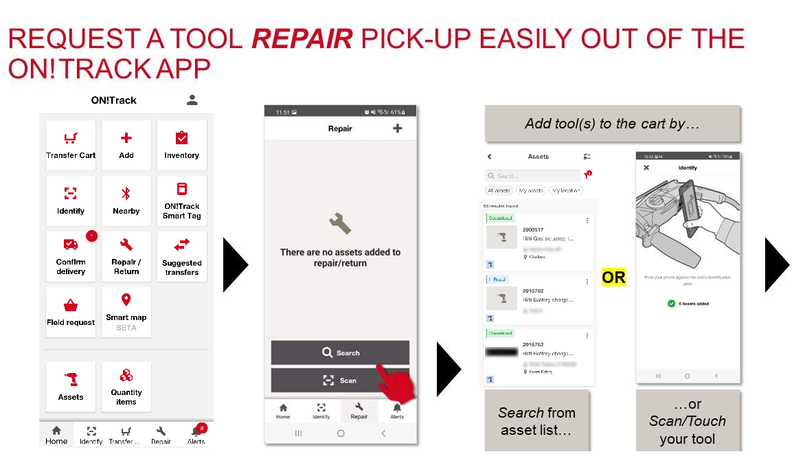

  • Identify Your Tool:
    • Select "Repair".
    • Find your tool by searching the list of assets, filtering, scanning the QR code, or scanning the NFC tag on the rating plate.
  • Request a Repair
    • Once the tool is identified, select "Repair" to add it to the Repair cart.
    • Repeat the process for any additional tools if needed.

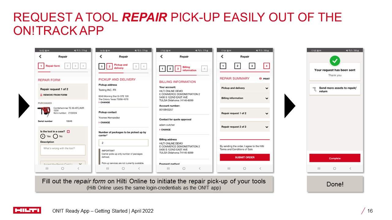

  • Complete the Repair Checkout
    • You’ll be directed to the Hilti website to complete the repair process.
    • Specify where you want the tool collected from and delivered back to, and describe the issue with the tool.
    • For web users, this redirects to the Hilti website. For app users, the website is rendered within the ON!Track app for a smoother experience.
What happens next?
  • Once the repair request is submitted, it will be created in Hilti's repair request system, and a courier will collect the tool from you.
