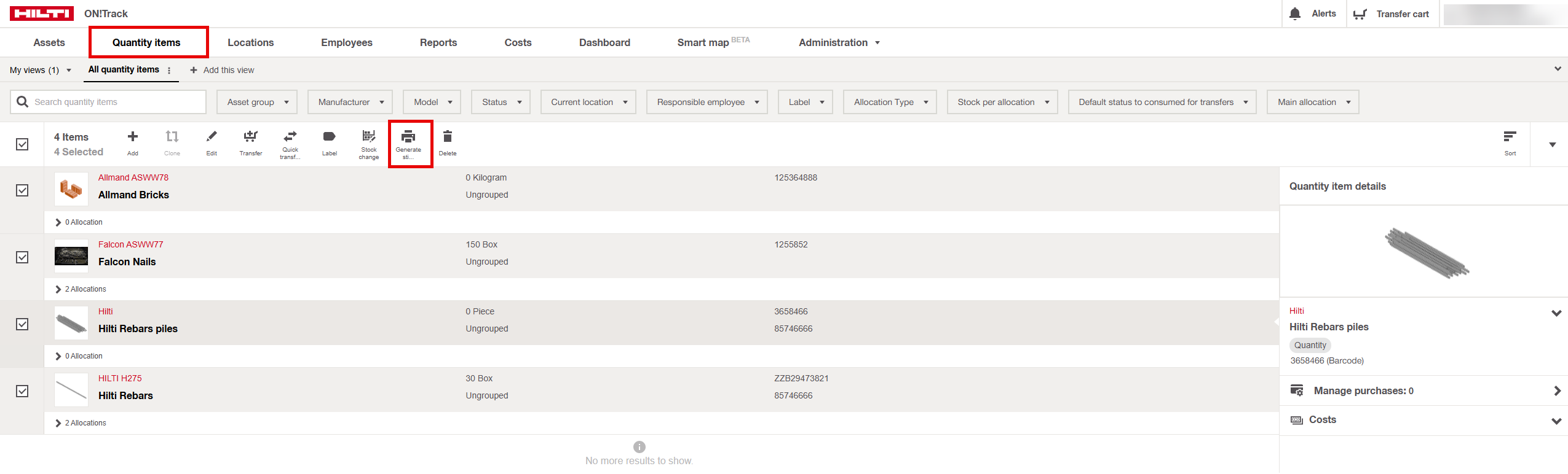

Step 1
  • Go to the Quantity Items page. Select the items you want to create labels for, then click 'Generate Stickers'. The sticker screen will open.

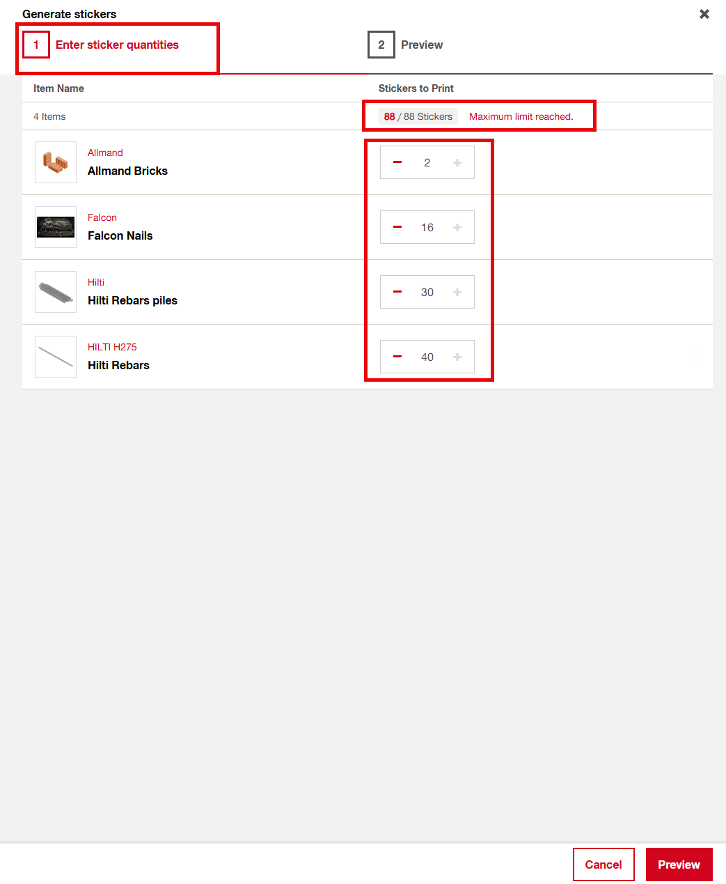

  • You can select between 1 and 44 items at a time.
    • If you select more than 44 items, the Generate Stickers button will be greyed out, and you will see: 'You can select up to 44 items to generate stickers'.
  • By default, 2 stickers are created for each item.
  • You can increase or decrease the number of stickers for each item using the + and – buttons. Each item must have at least 1 sticker. (maximum 88 stickers per PDF).

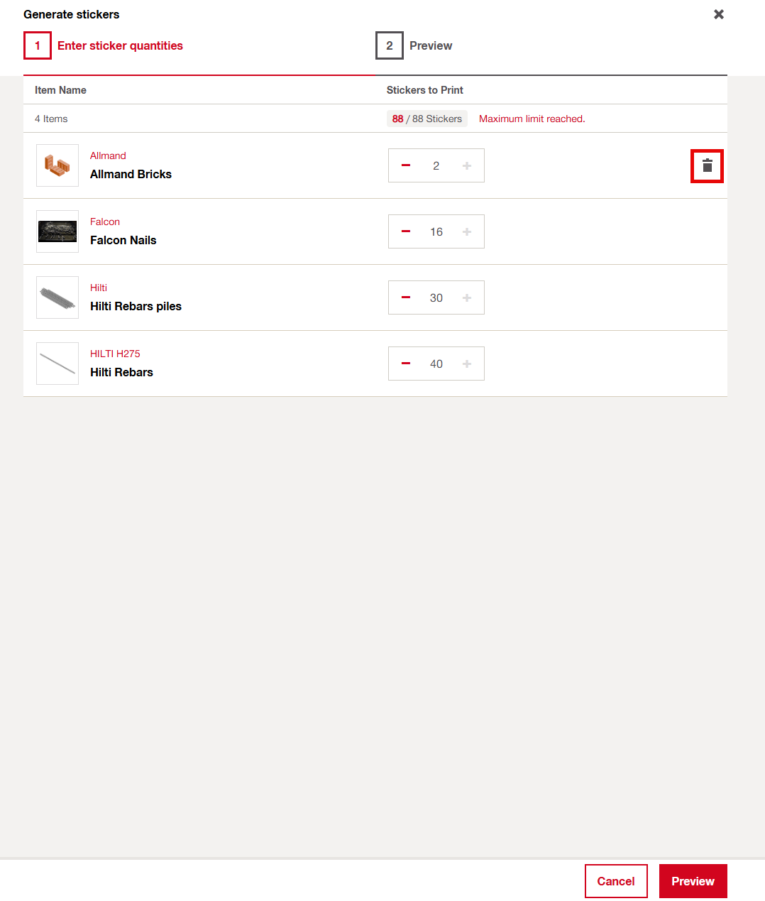

  • You can remove any items you don’t need.
    • Removed items are excluded from the preview and PDF.
    • If you remove an item during label creation and then cancel, that item will no longer be selected when you return to the Quantity Items page.
    • If you cancel, you will return to the page you started from. Your item selection will be kept, except for any items you removed.

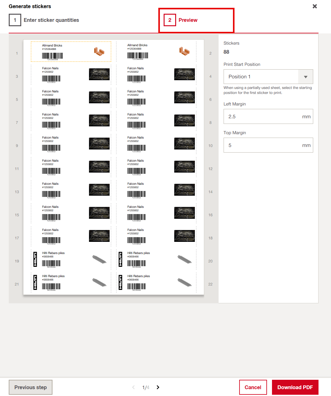

 Step 4
  • Always review the preview before printing and run a test print when using a new printer or label sheet.
Step 5
  • Set positions:
    • You can also adjust the number of stickers, starting position on the sheet.
    • Choose a start position from 1 to 21 to begin printing on partially used label sheets (If the first few labels on your sheet have already been used, choose a later starting position so printing begins from the next available label.).
    • Labels are generated in a standard size of 100 mm × 25 mm and provided in PDF format.

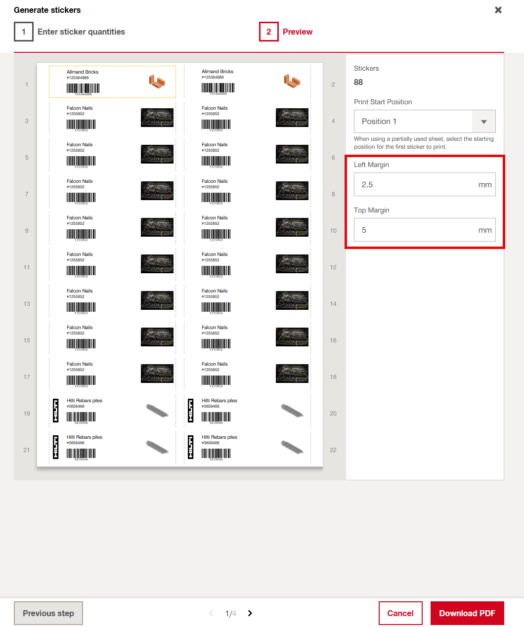

  • Set Margins:
    • Keep margins (0 to 15 mm) to improve alignment.
    • Default values: Left Margin 2.5 mm, Top Margin 5 mm.
    • If you enter a margin value outside 0–15 mm or leave it empty, an error message will appear and the Download PDF button will be disabled until you correct it.
Note: Changing the margin values does not update the preview. The margins you set will be applied when you download the PDF.

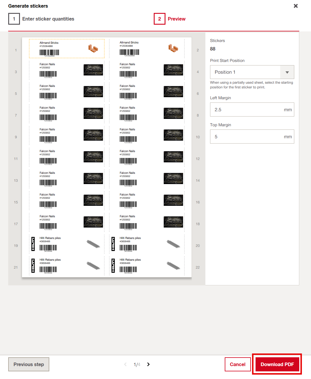

Step 6
  • Download PDF: Click Download PDF.

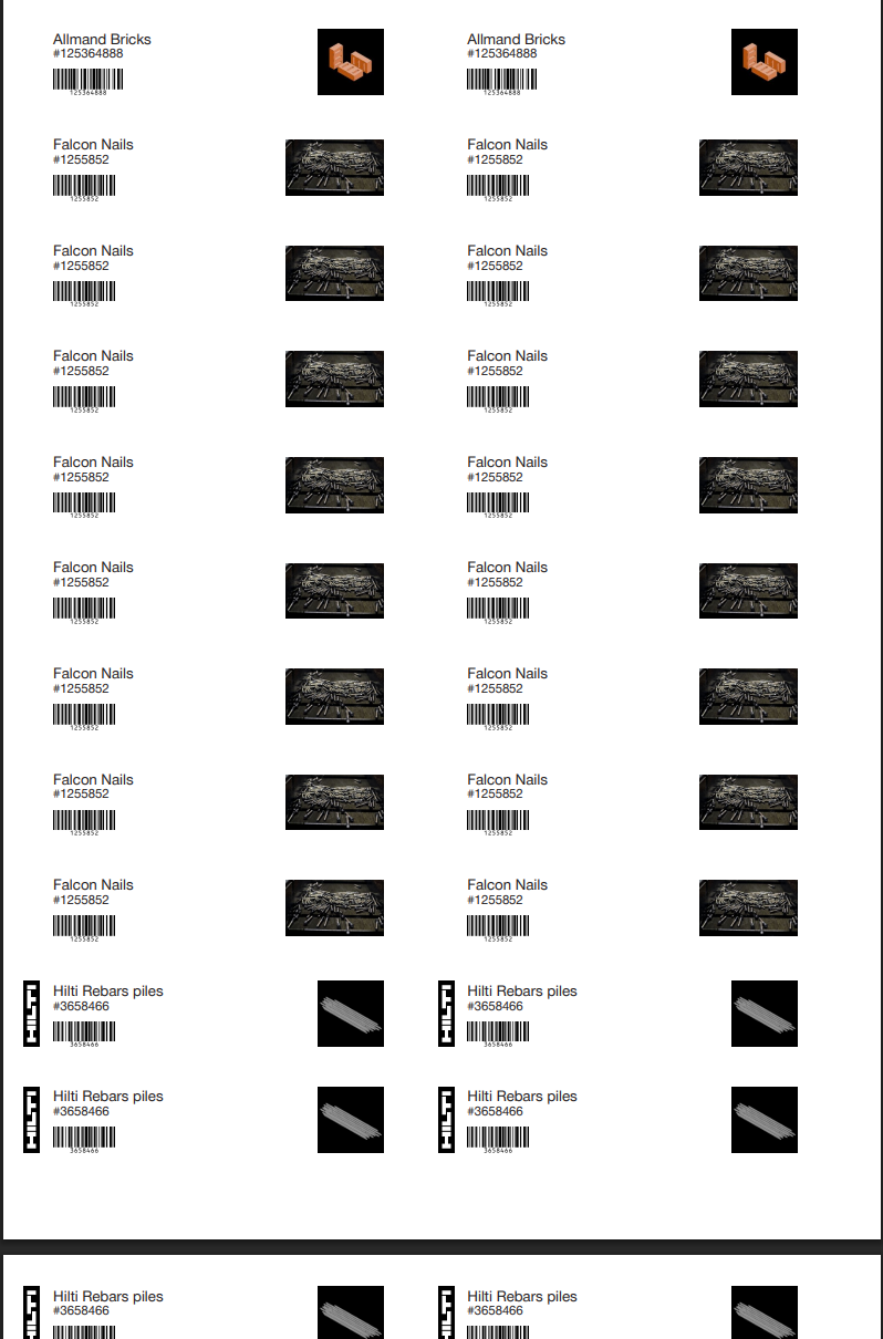

Step 7
  • Print at actual size.
    • If labels don't align with the sticker sheet, first confirm you're printing at actual size with 'Fit to page' disabled. Try a test print before adjusting margins.
  • Do not use “Fit to page,” and do a test print if needed.
Note: When using a new printer or a new type of label sheet, do a test print with a small number of labels first to check alignment.

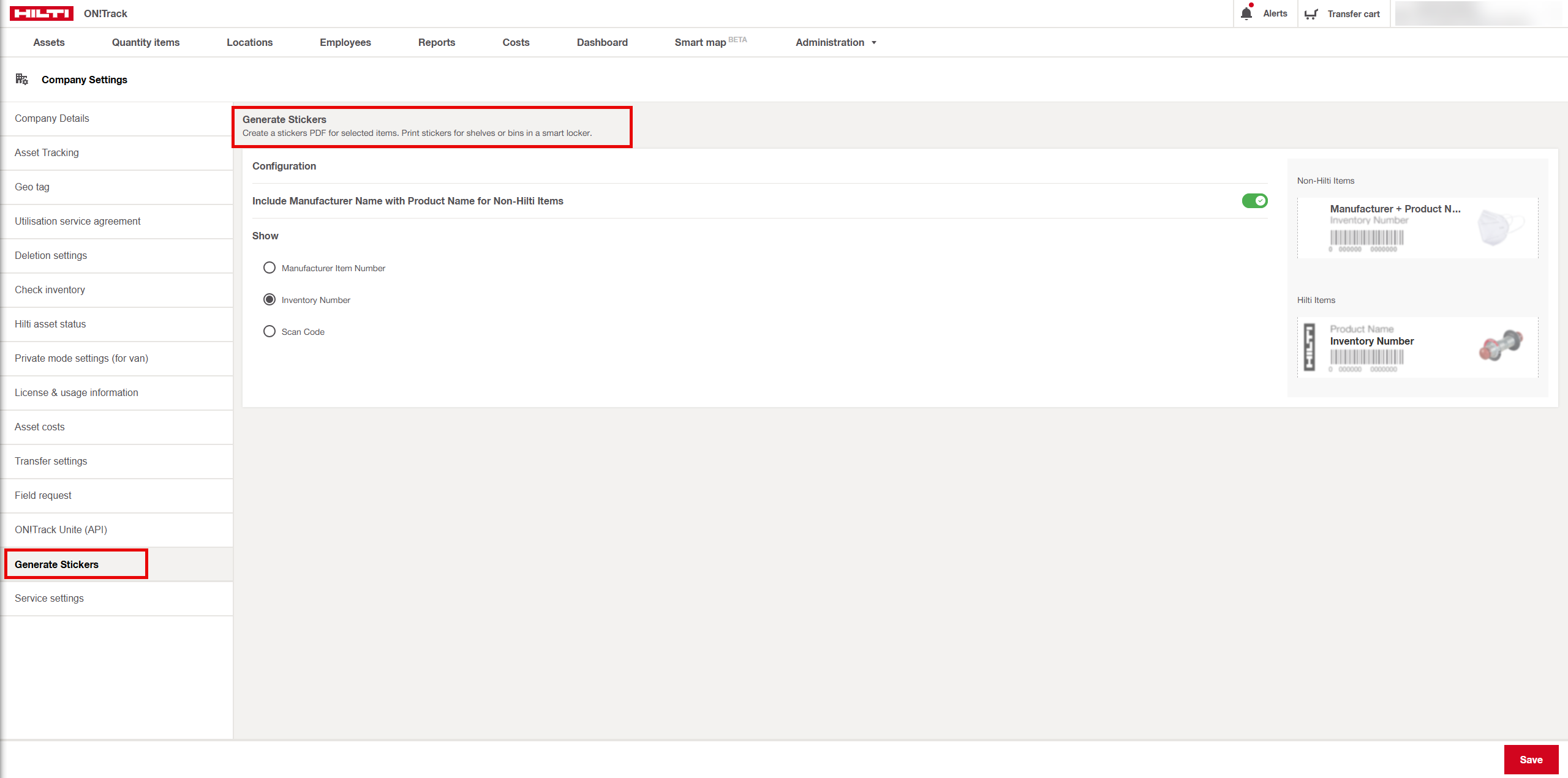

Company settings
Where to find Company Settings
  • Go to Company Settings.
  • Click on Generate Stickers.
If the selected identifier (e.g., Scan Code) is empty for an item, the system falls back to the next available identifier (Inventory Number or Manufacturer Item Number).
Once saved, these settings apply to all users in your company.
Admins can control:
  • Add manufacturer item details alongside the product name for non-Hilti items.
  • Replace the item number with the manufacturer item number, inventory number, or scan code.
