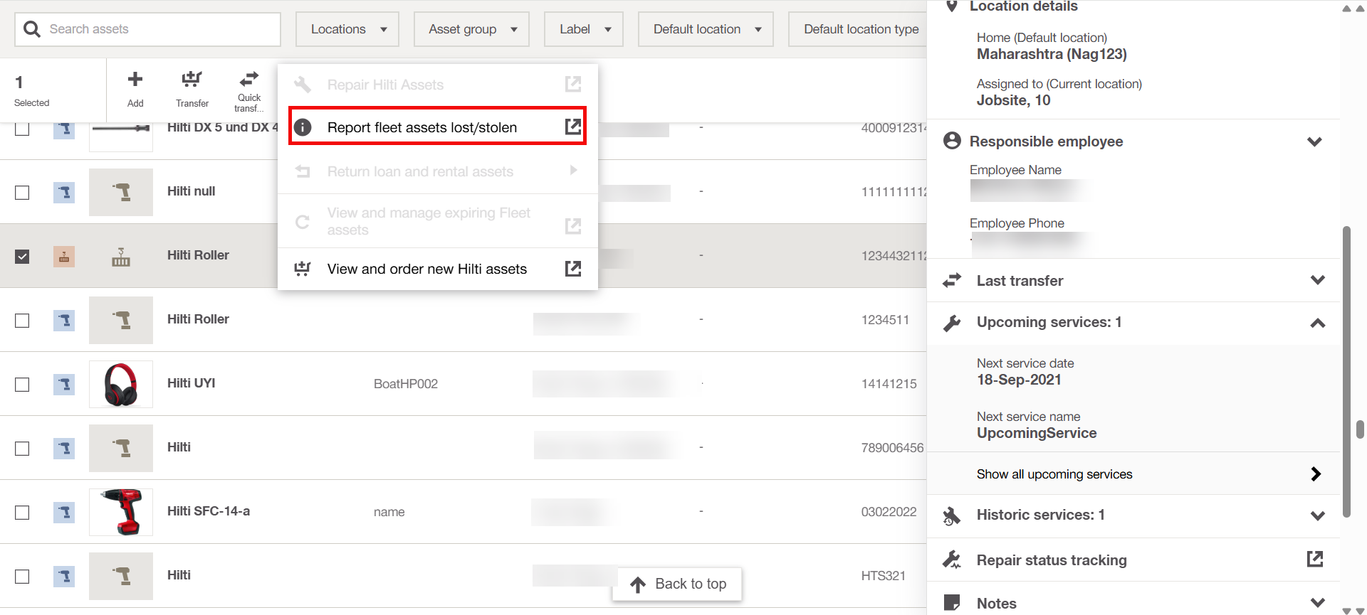

Via Hilti Services action menu

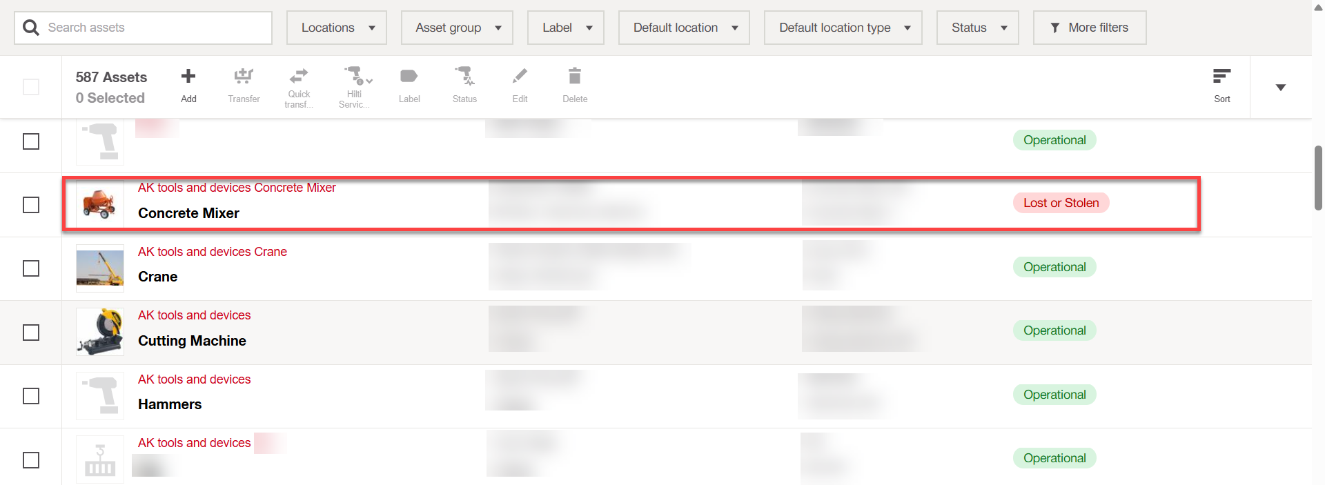

In the asset list view select the asset you want to initiate the search for.

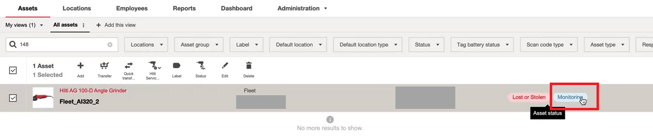

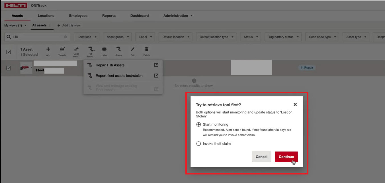

Change its status to lost or stolen and select the option to “Start monitoring”.
The asset will change its status to lost or stolen and a “monitoring” label next to it (visible in the asset list view).
The Hilti connectivity infrastructure will search for your asset, and you will receive a notification once it is located.

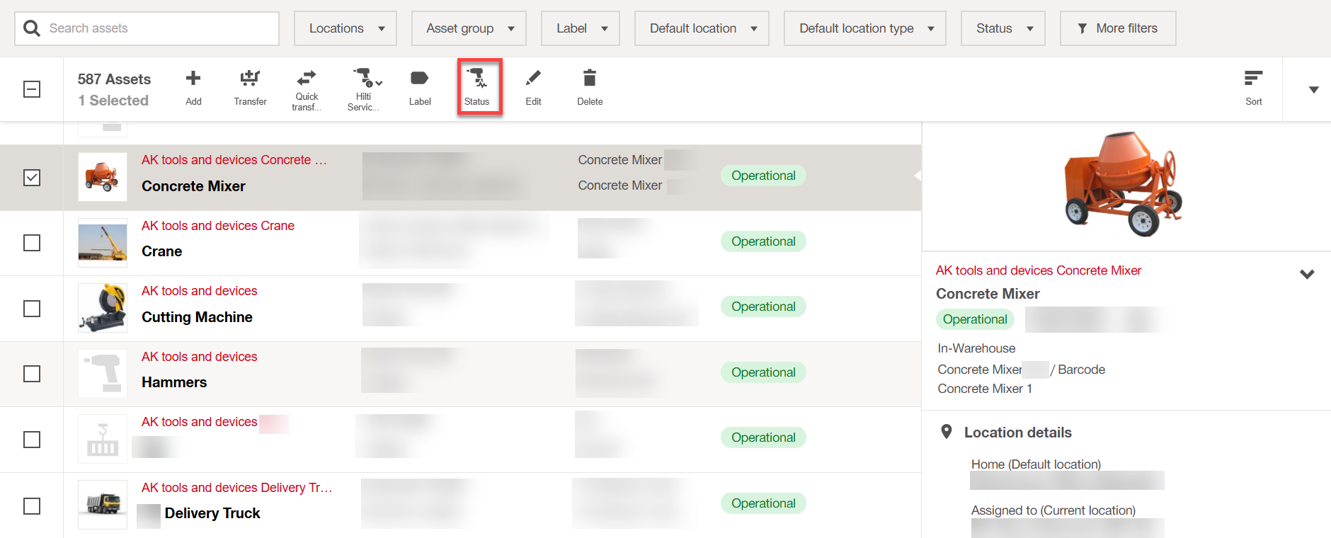

Via Status change

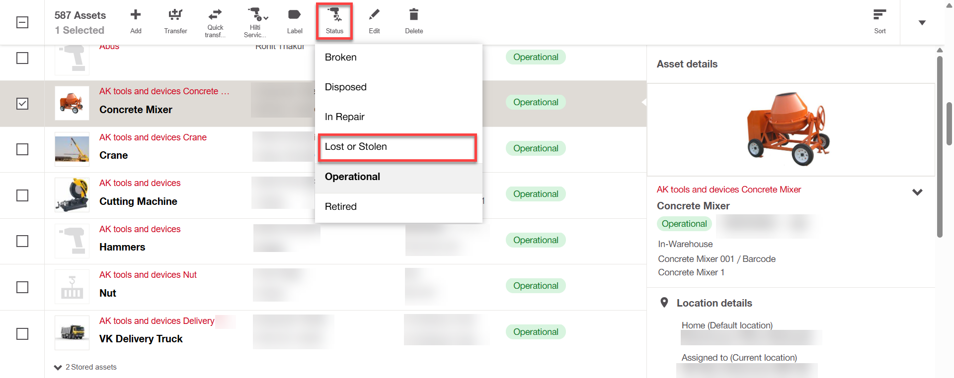

- In the asset list view select the asset you want to change the status for and click "Status Change".
From the dropdown click on the "Lost or Stolen" option.
- The asset will change its status to lost or stolen.
