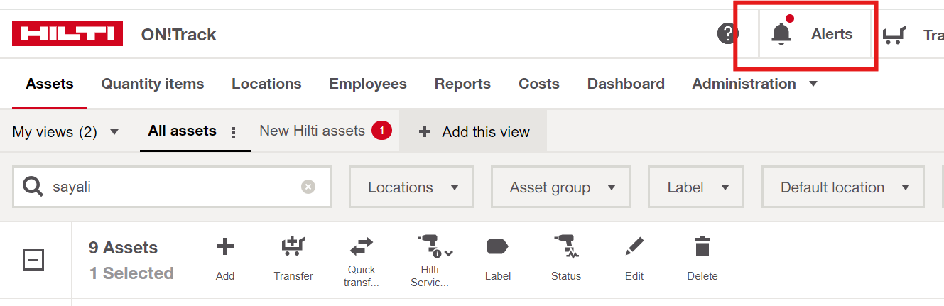

- Click on the bell symbol in the upper right corner to access the notification centre.
Navigate to the "General" tab to view alerts.
Depending on the search outcome and asset type, use the dropdown symbol on the right to take quick actions

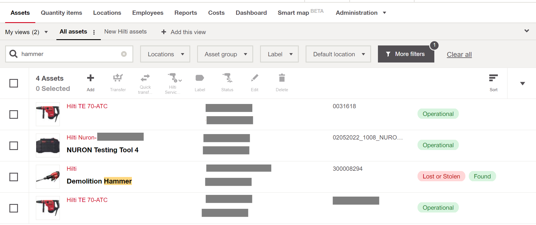

Option 2:
- Go to the asset list view and locate the specific asset.

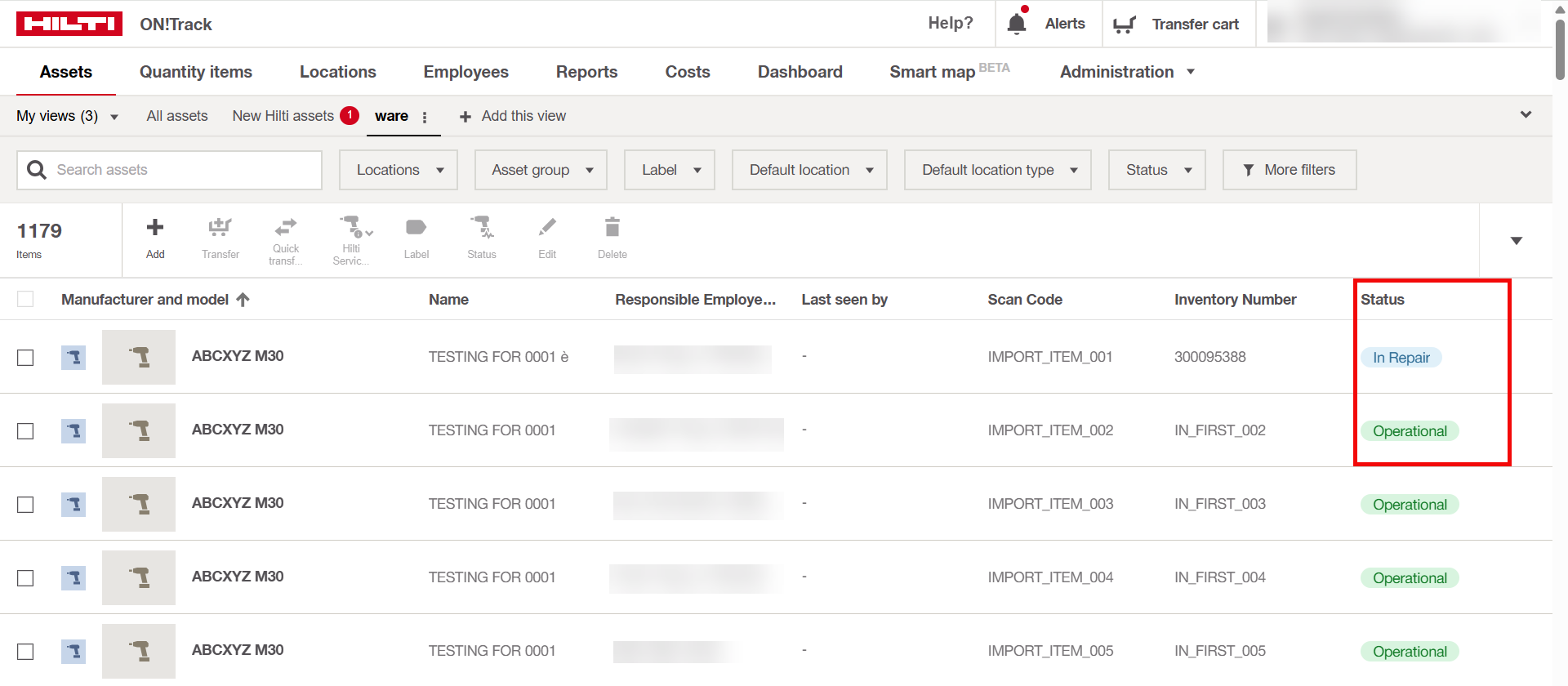

- Check the label next to the asset status for the search outcome.
Depending on the search result and asset type, access additional actions from the standard tab at the top of the screen.
