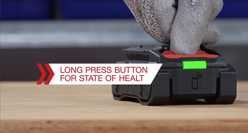

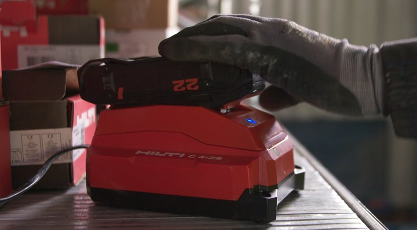

  • Having the battery at hand:

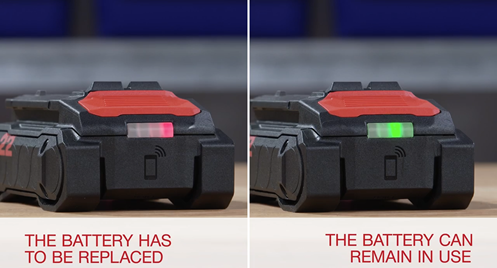

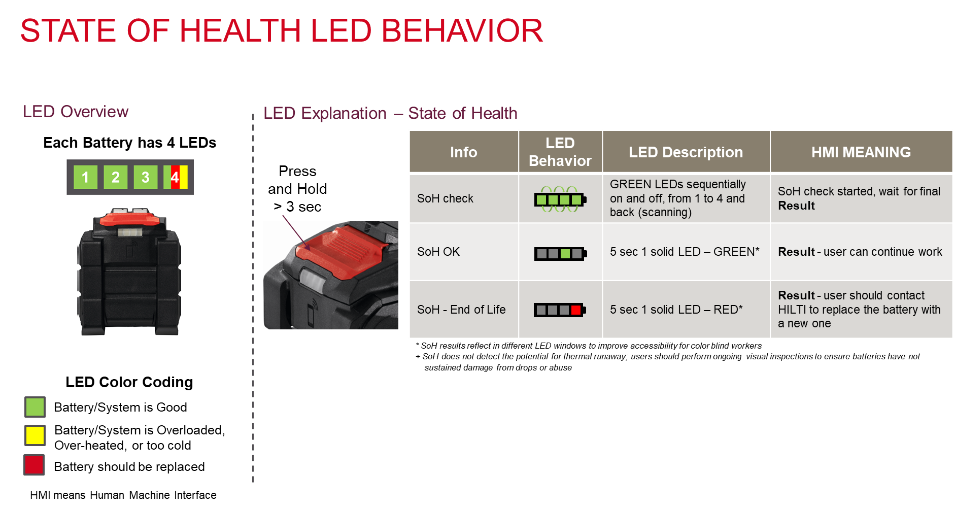

    • Long-press the red button on the Nuron battery for >3 sec.
    • The battery algorithm will check its State of Health (SoH). If the LED turns red then the battery is end-of-life. If it turns green, everything is fine!

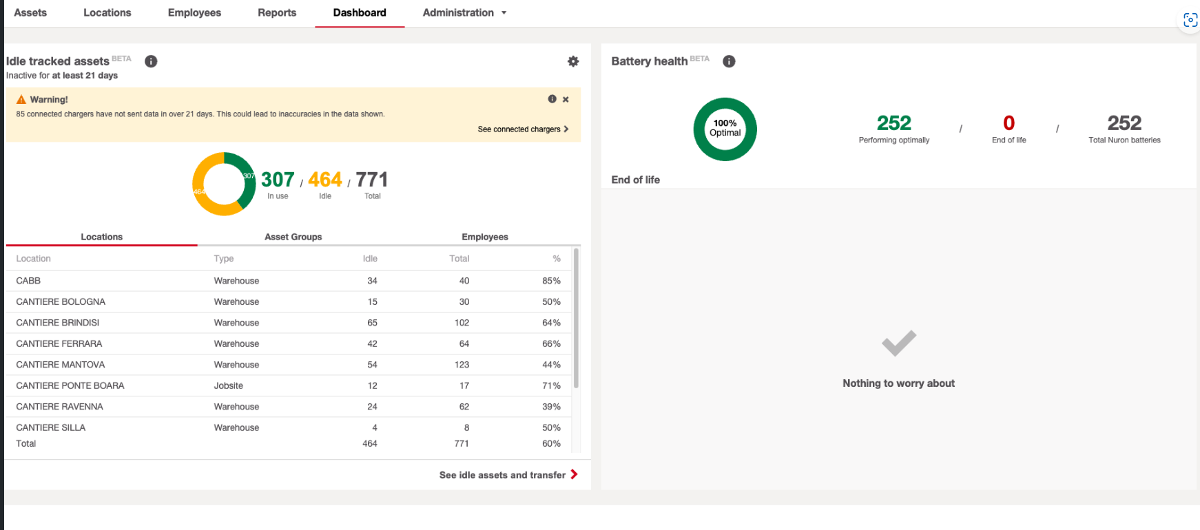

  • Battery alerts on the ON!Track web or mobile interfaces:
    • Regular Charging: Charge your Nuron batteries on a connected Nuron charger to keep the battery health updated in the Hilti cloud.image2021-12-2_21-43-26.png

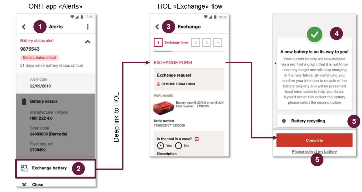

    • Battery Alerts:
      • Receive instant alerts in your ON!Track web or mobile interface when your battery reaches end-of-life. Check the "alerts" section (for all ON!Track users) or the "battery park" on the web dashboard (for ON!Track Ready / Lite / Pro / Enterprise users).
      • These alerts enable you to easily replace your Nuron battery once you receive a battery alert.
      • After successfully exchanging your battery, a new battery will be quickly delivered to your chosen destination.

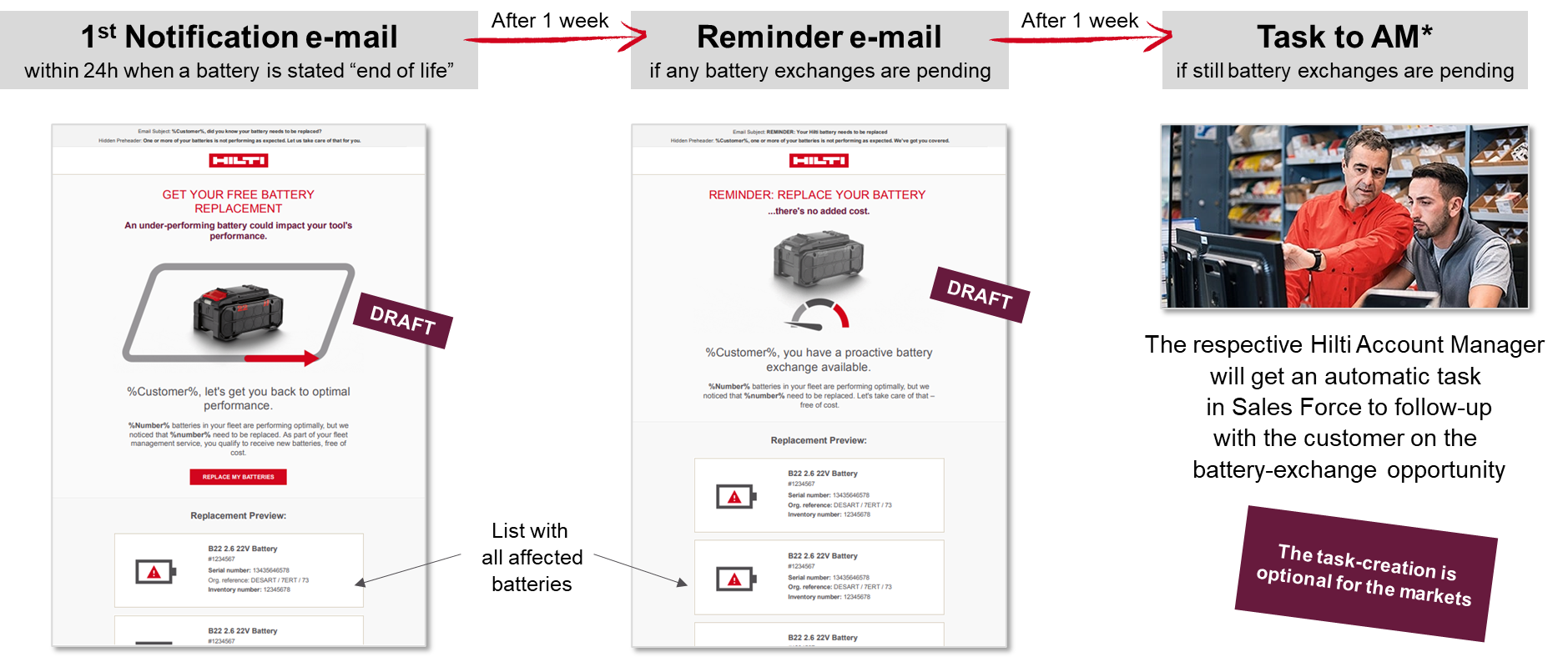

  • Proactive battery notifications via email:
    • In ON!Track, our Fleet Management users will receive proactive battery notifications via email. These notifications include a link that allows for easy battery replacement.
The final screens might look slightly different.
