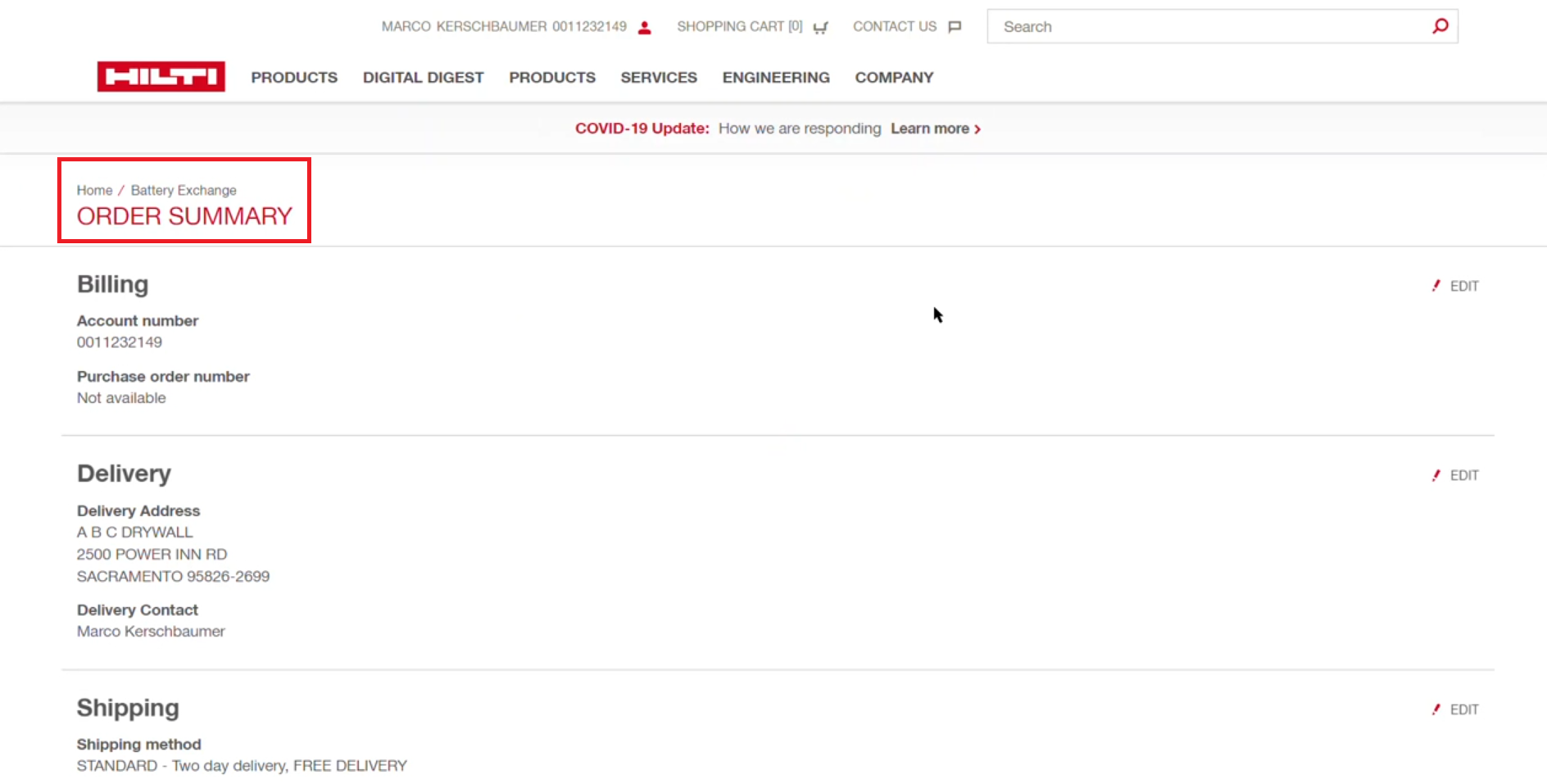

  • You will now get redirected to Hilti Online - please log in with your credentials if necessary.

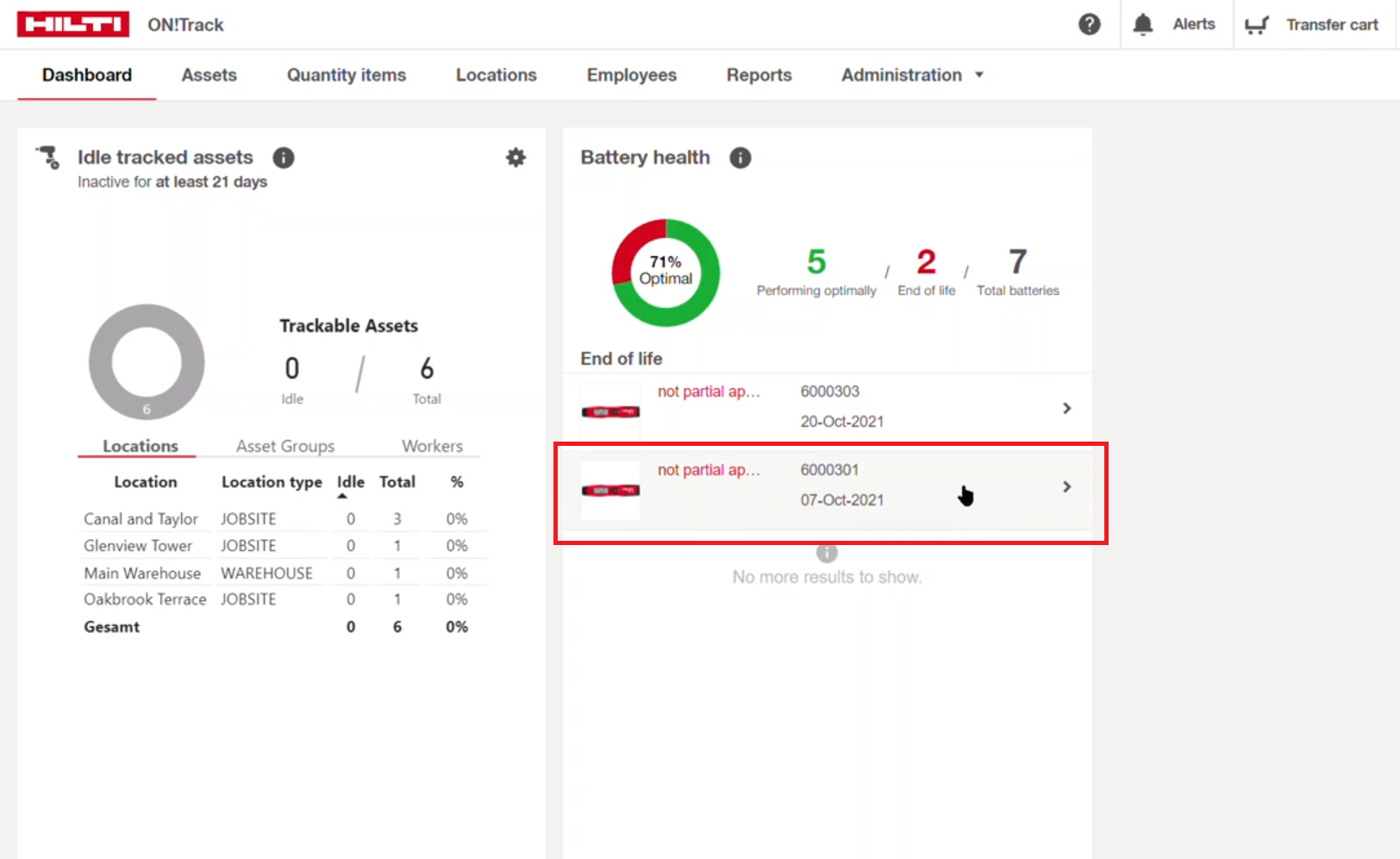

  • Select the end-of-life battery you want to exchange.

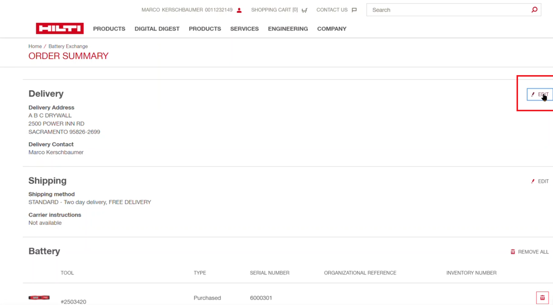

  • Click on the related menu button and follow and fill out the form to provide the necessary information i.e. billing or delivery address.

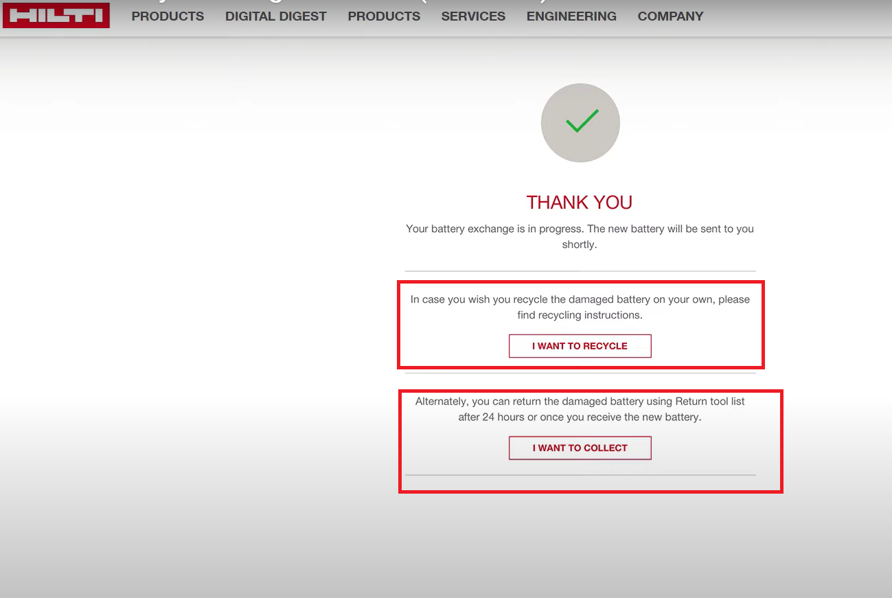

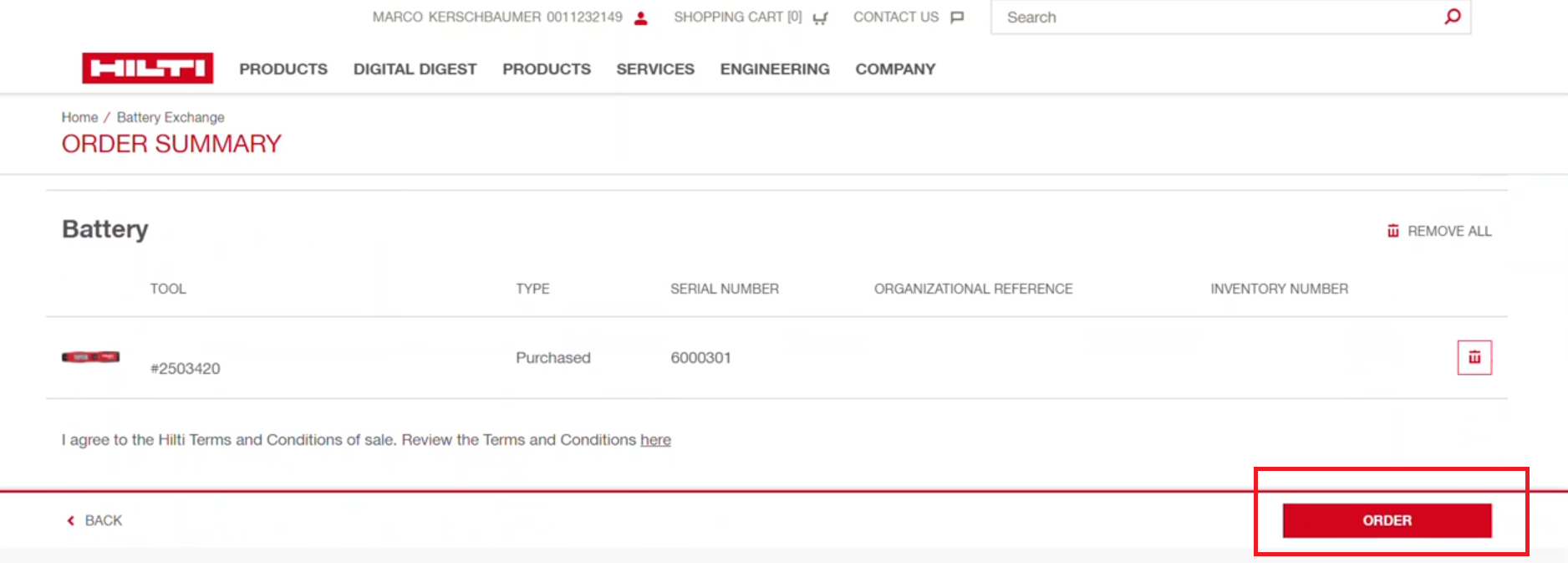

  • Click on “Order” - you will directly get a confirmation.
  • Please check the recycling options in the confirmation screen.
