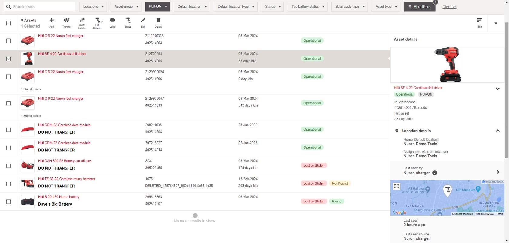

  • Search for Your Asset:
    • Click on the asset to select it.
    • On the right, under "Location", you can see the last charged location, how long ago it was updated (e.g., 2 hours ago), and the source (e.g., Nuron connected charger).

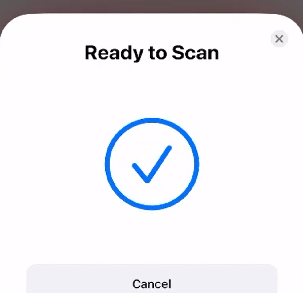

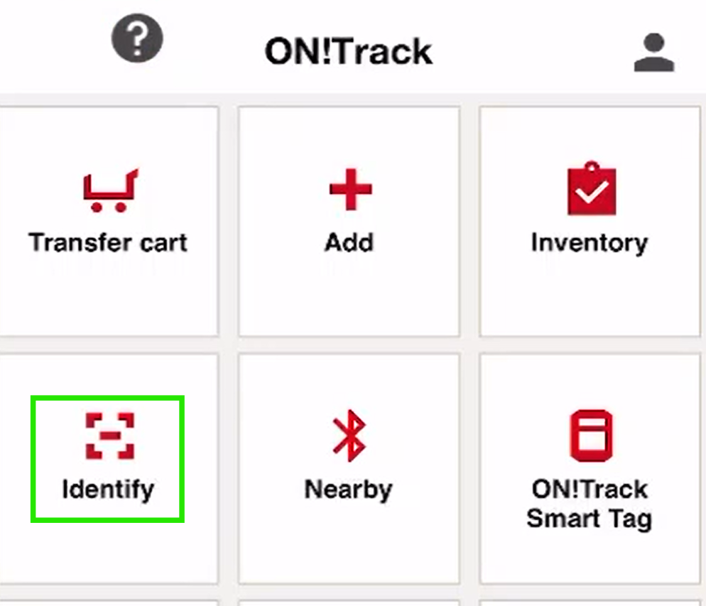

  • Use NFC Tag:

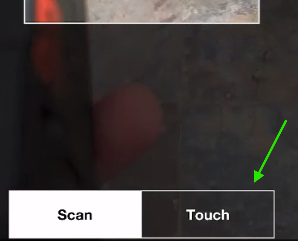

    • Click on "Identify" and select "Touch".
    • Scan the NFC tag on the battery to identify it.

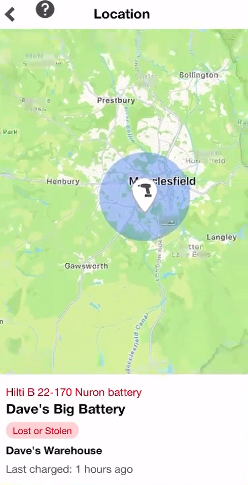

    • Scroll to the location to see the last charged location.
    • Zoom out to view where the battery was last charged.
