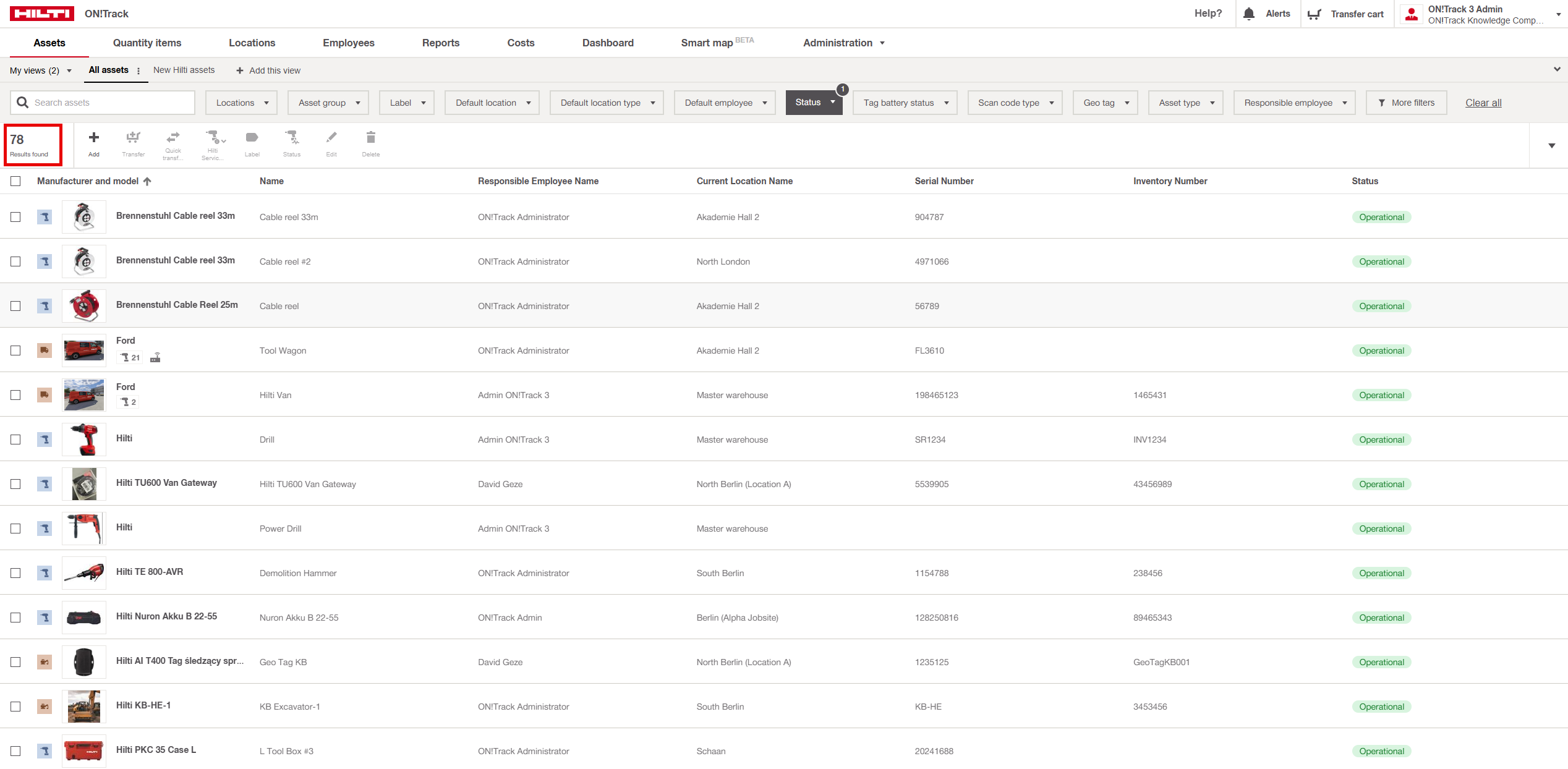

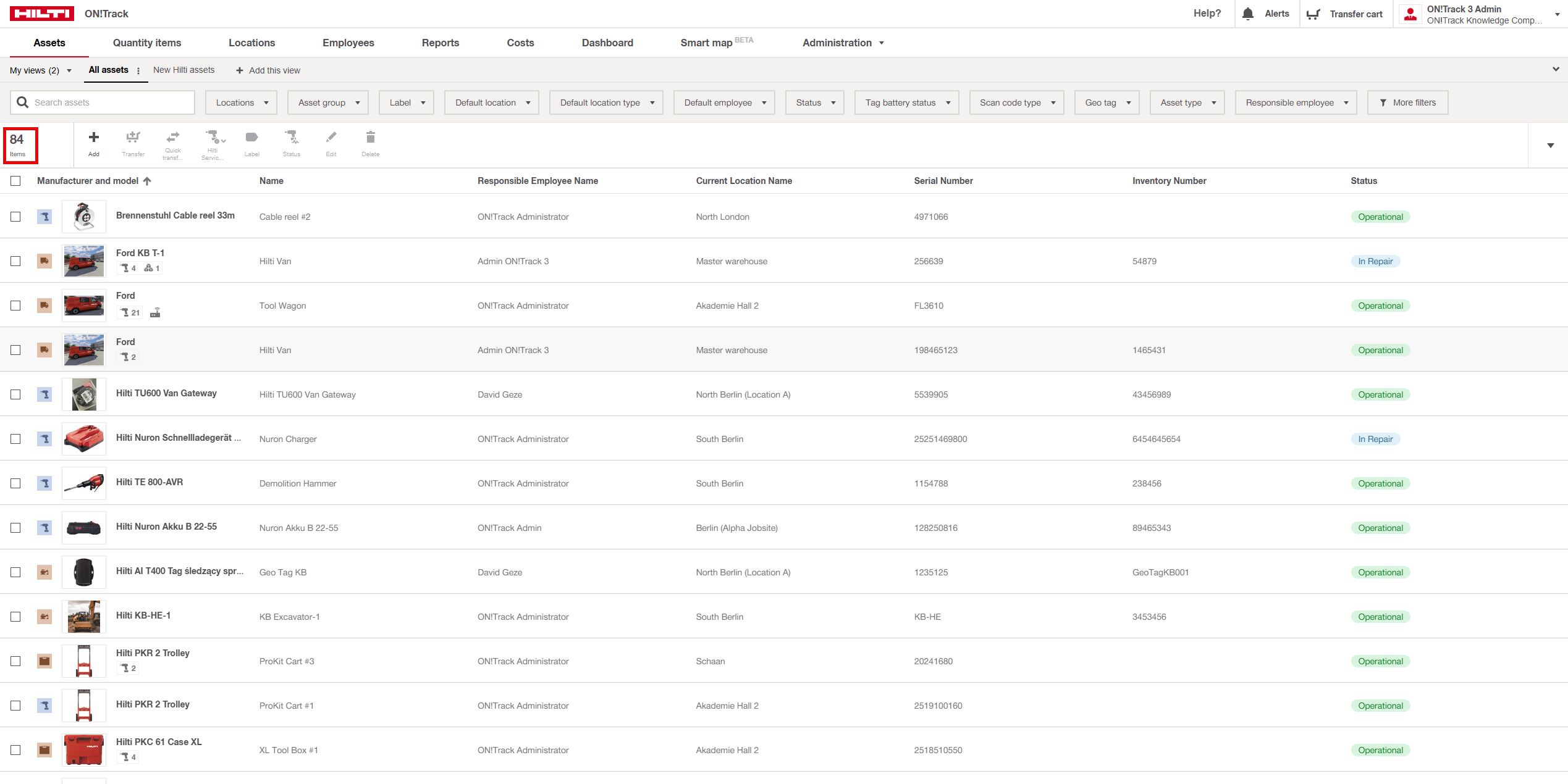

  • Open the Assets tab and make sure no filters are applied. Note the total number of items displayed (Count: 84)
  • Apply any Status filter. The count updates to show only the assets that match the selected status. (Count: 78)

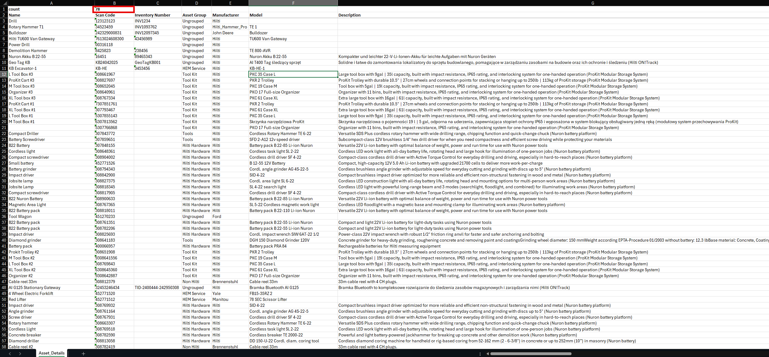

  • Export the filtered results. Verify that the number of exported records matches the filtered asset count.  (Count: 78)
