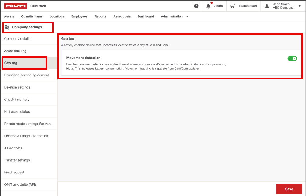

Prerequisite: Movement detection must first be enabled at the company level under Company Settings → Asset Tracking, and only then can it be activated per individual Geo tag.
By default, movement detection is disabled for all geo tags. You can enable it per device as you need it. It will work on any Geo tags.
  • Enable at company level (Admin only)
    • Go to Company Settings → Asset Tracking.
    • Enable the Movement Detection option.
  • Enable per Geo Tag

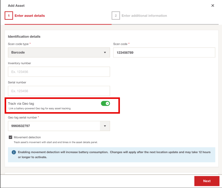

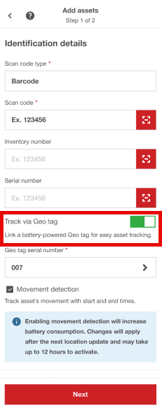

    • Navigate to the asset tracked with a Geo Tag AI T400.
    • Click Edit Asset.
    • Check the Movement Detection box.
    • Save.
  • The Geo Tag will download the new configuration at its next scheduled check-in (6:00 AM or 6:00 PM). Movement detection will begin working after that configuration update is received.

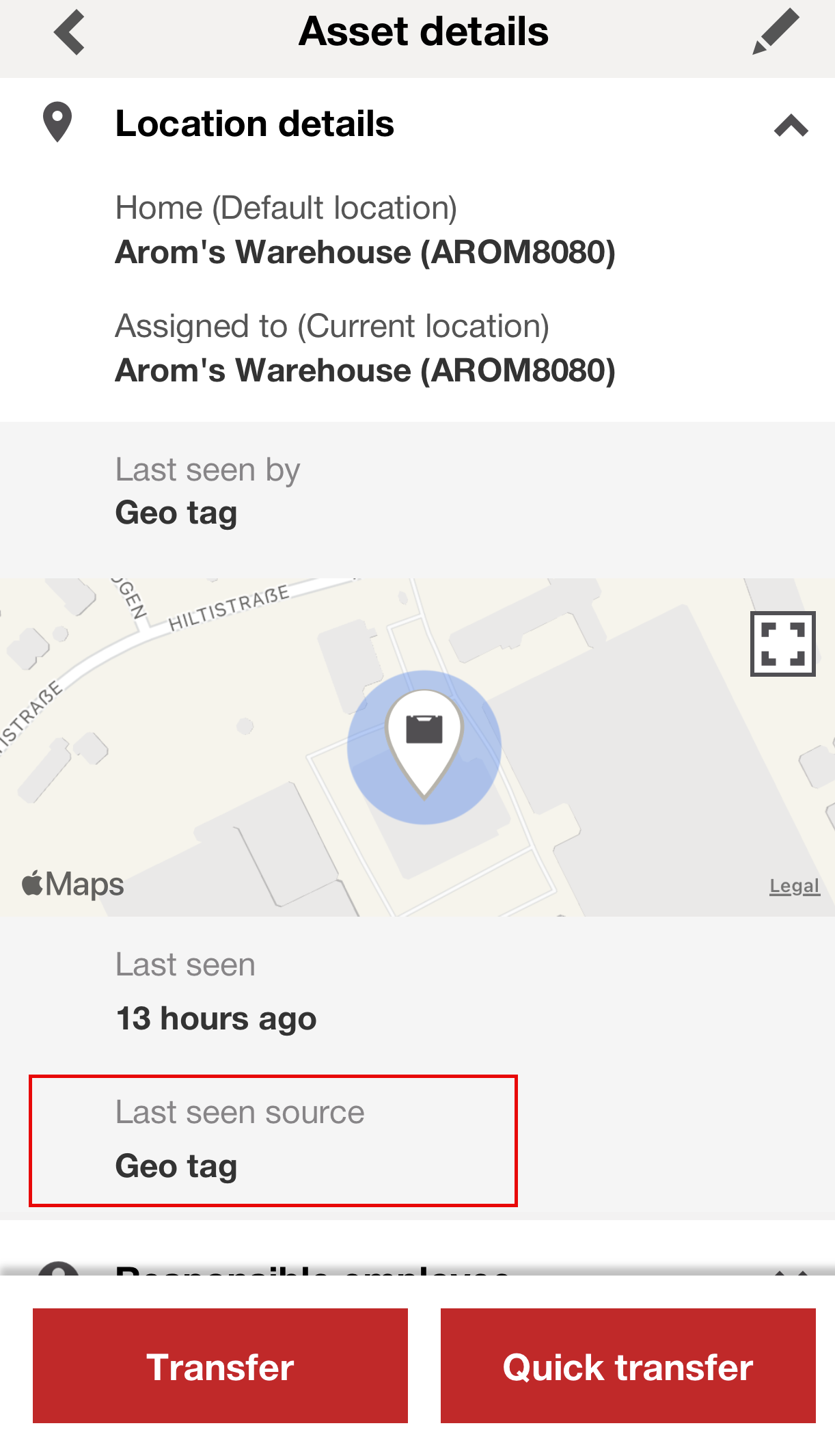

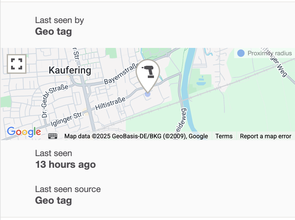

ON!Track View
In the asset details panel, you see the following segment:
And you of course have the pin on the map.
  • Admin step (company-wide): Movement Detection must be allowed/enabled in Company Settings.
  • User step (per asset): It is then enabled per geo-tagged asset (manual selection), because it can increase battery usage.
  • Activation Delay: After enabling, the state goes to "activating" and only becomes "active" after the first movement event is received. This can take up to 12+ hours (next scheduled connection at 6AM/6PM).
Where users see the movement information
Asset Details / Smart Map: Movement details appear as part of the asset’s geolocation information, with a dedicated Geo Tag area.
Status visibility: ON!Track can show whether movement detection is inactive / activating / active, and can display movement start/stop timestamps.
