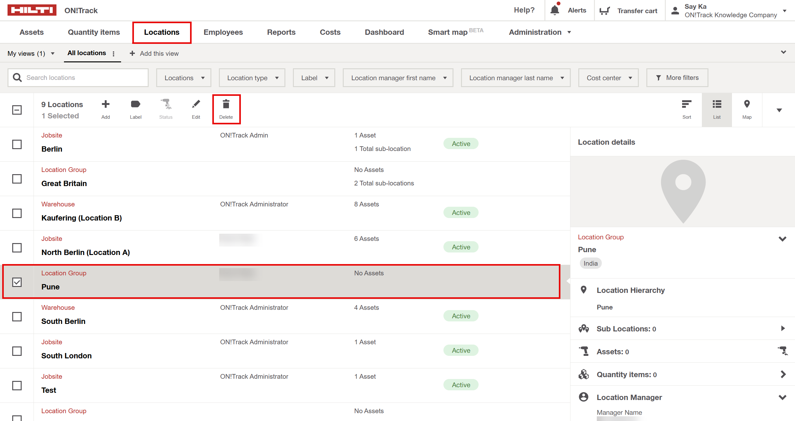

Instructions:
  • Navigate to the "location" Tab: Click on the "Delete" icon at the top to delete an location.
  • Click on delete to delete the location.
  • The location will be deleted from the location list.
