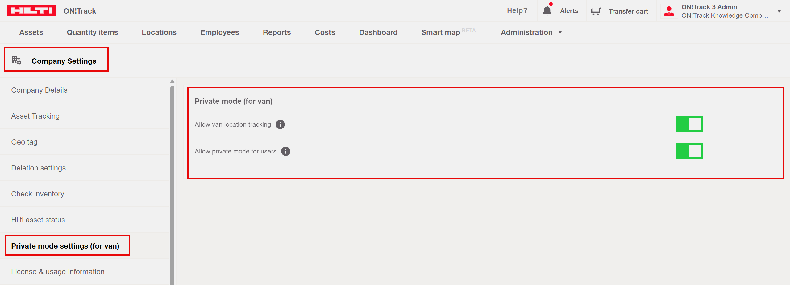

  • Company settings (Admin)
    • Admins decide if van tracking is allowed.
    • They can also decide if employees are allowed to use Private Mode.

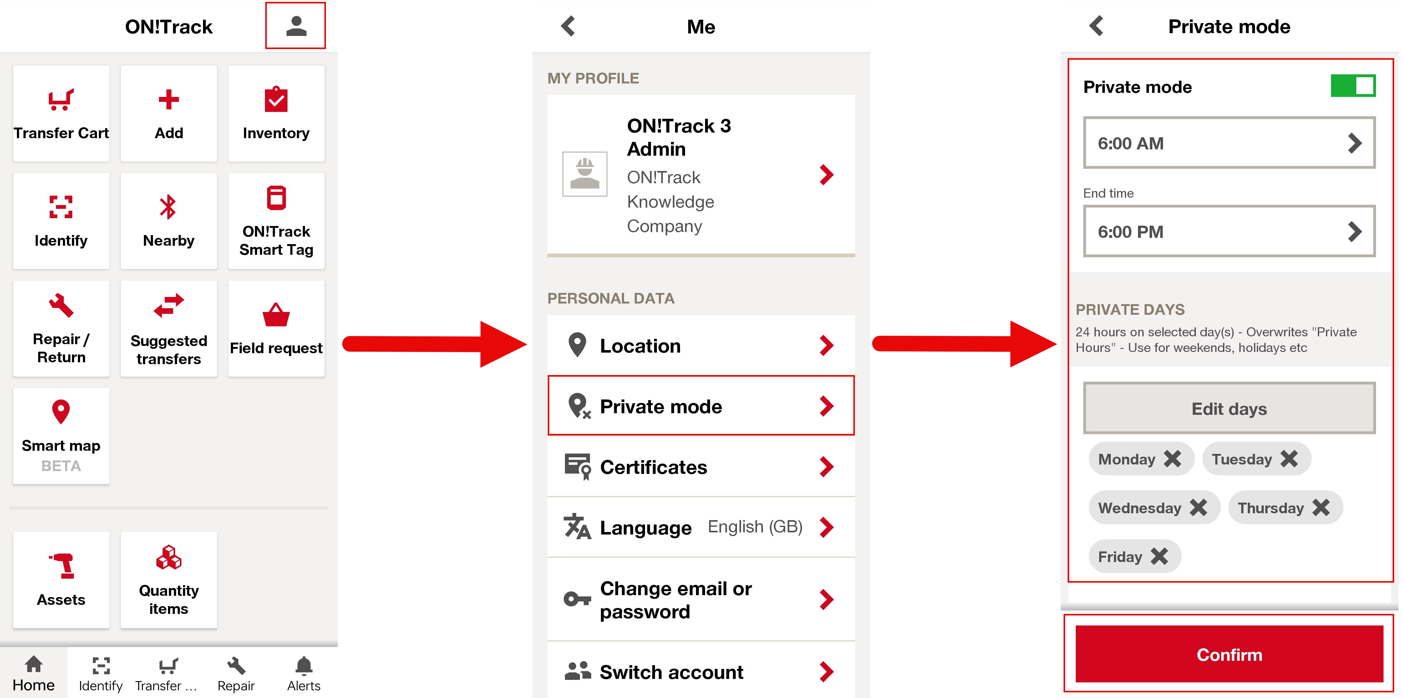

  • Mobile settings (Employee)
    • Employees can turn Private Mode on or off in the mobile app.
    • Go to User Settings and select Private Mode and turn it on
    • Set Private hours and/or Private days and select Confirm
      • Private hours (specific times of the day)
      • Private days (full days with no tracking)
