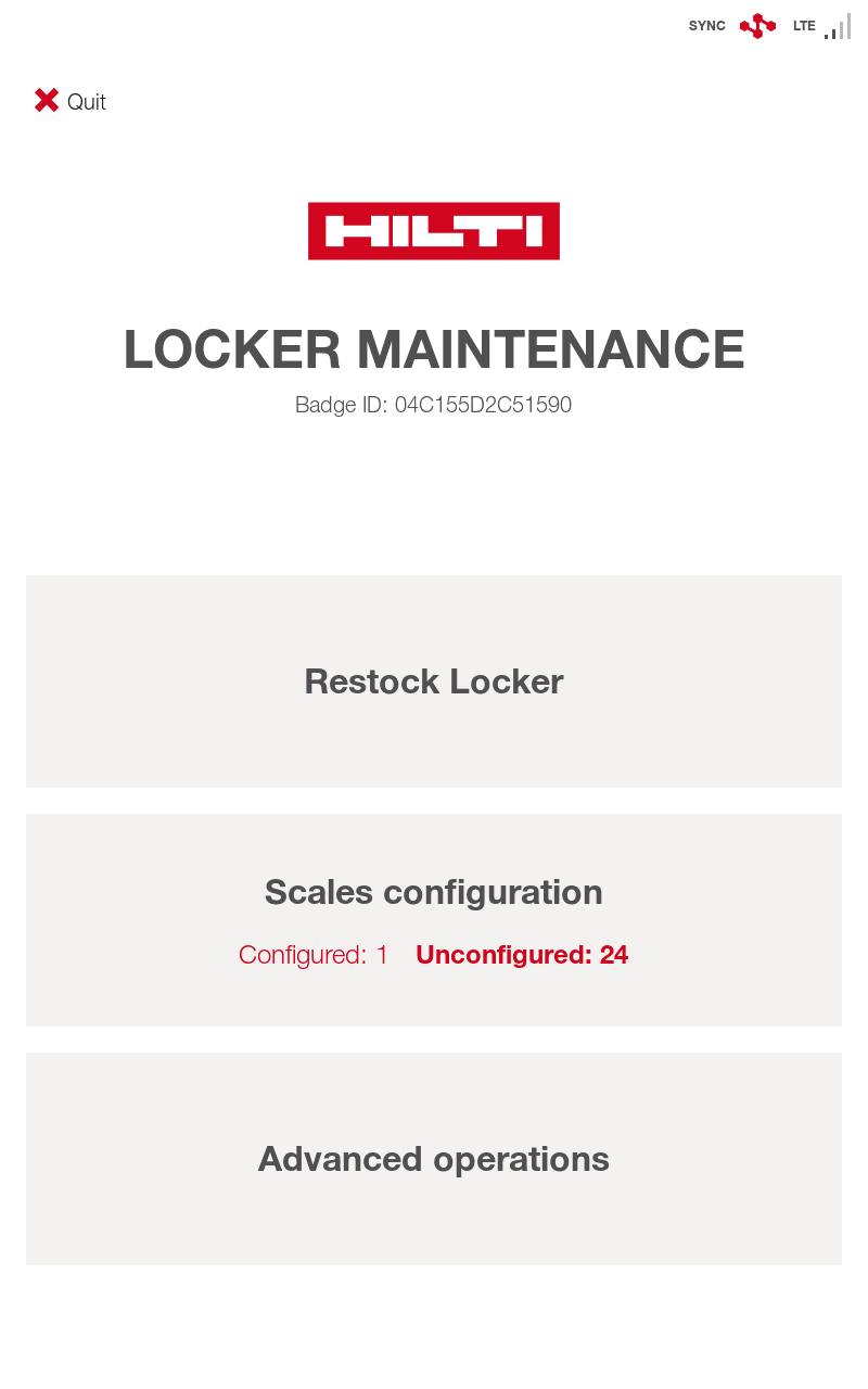

How to Access the Admin Menu
  • Hold the BLACK key fob near the locker’s RFID reader
  • The screen will switch to the Locker Maintenance menu.
  • You can now choose from several admin options.
Note: The Admin Menu stays open until you select Quit.
Admin Menu Options
Restock Locker
  • Opens the locker doors so you can refill items.
  • You cannot choose a cost center
Scales Configuration
This option opens the locker doors and lets you:
  • Change which items are stored on individual scales
  • Calibrate each scale to keep counts accurate
Advanced Operations
Use this option for additional updates, including:
  • Reauthentication - ⚠️ This will reset the entire locker to a factory‑like state. Use this only when the tablet shows “Not Authenticated.”
  • Syncing employees and locations from ON!Track
  • Calibrating all scales at the same time -⚠️ Triggering this action will perform a mass zeroing of all scales in the locker. This means: Every container will require a fresh calibration afterwards. The entire locker will be reset to its factory‑like calibration state.
Quit
  • Ends the admin session and returns the locker to normal mode.
