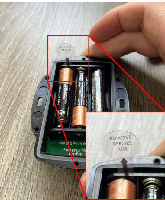

    • The Geotag comes with a SIM card and batteries already installed.
    • Activate the device: Remove the plastic rip strip as shown in the picture below.
    • Secure it: Tighten the screws to close the device. As the housing is plastic tighten the screws to hand tightness, do not overdo it.

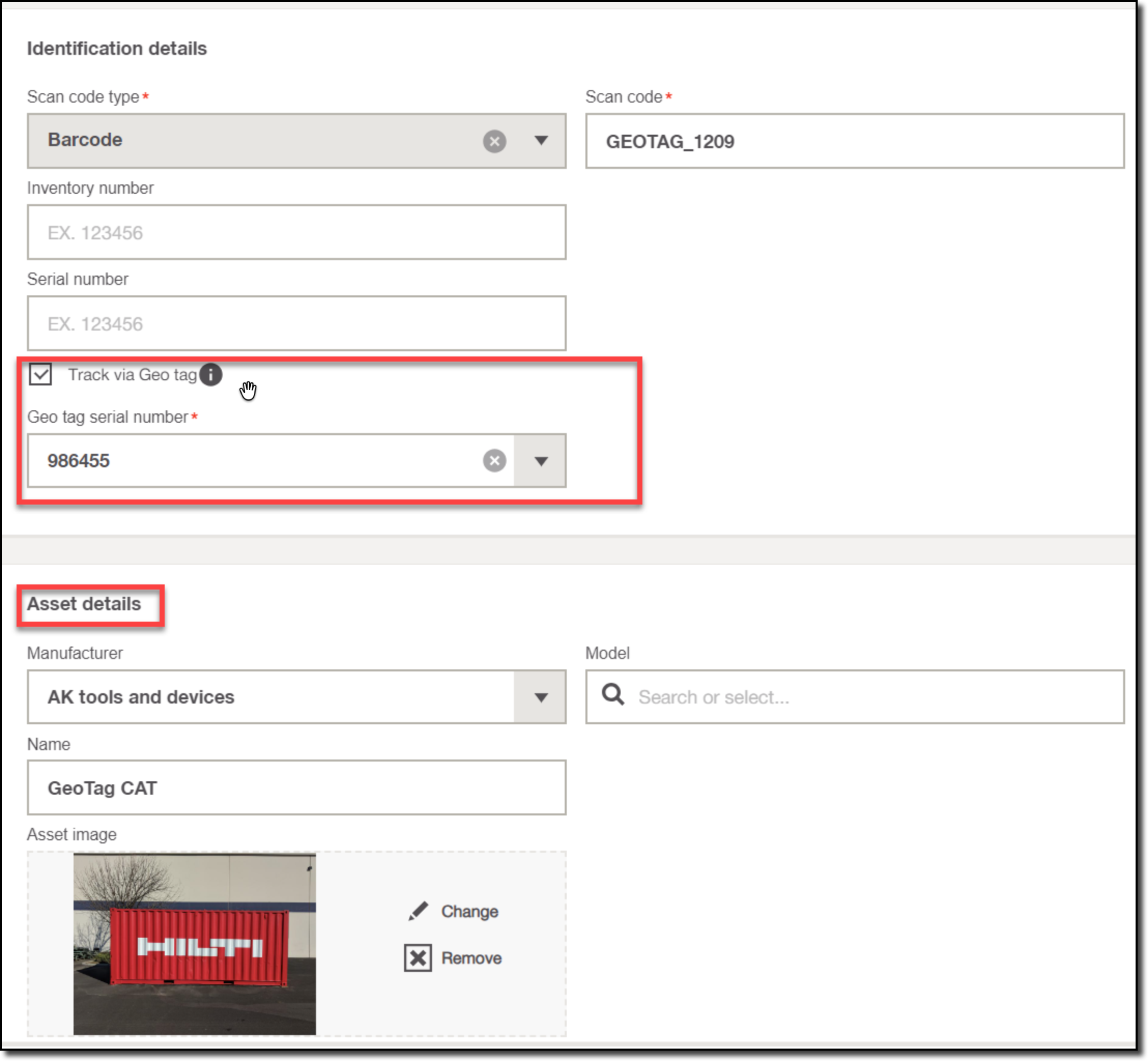

  • Onboard the Device to ON!Track:
    • Follow the steps to add an Hilti Asset or add an Non- Hilti- Asset or edit an asset.
    • Check the box for Track via GeoTag.
    • Enter the GeoTag serial number.
    • Finish the remaining steps to add or edit the asset.

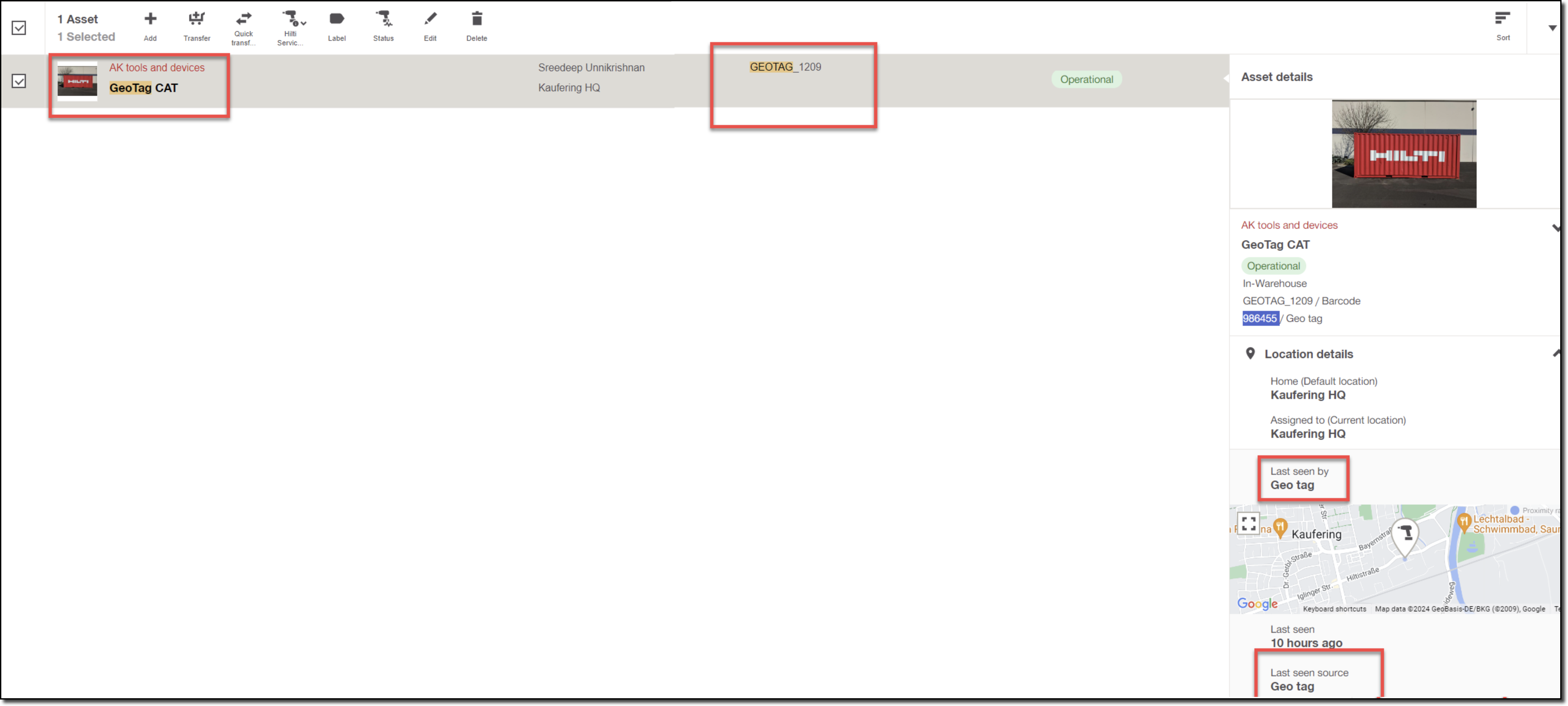

  • The geotag will be connected/added to the equipment.
