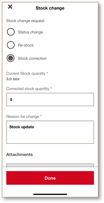

  • Transfer or Quick transfer and Restock:
  • Stock correction: Stock correction functionality to adjust the ON!Track stock levels to reflect the physical stock.
