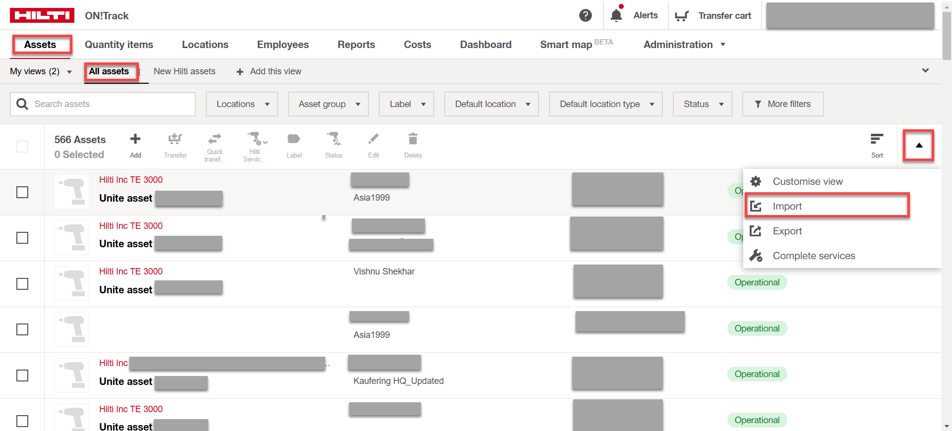

  • Click the arrow icon, then select "Import" to import the asset.

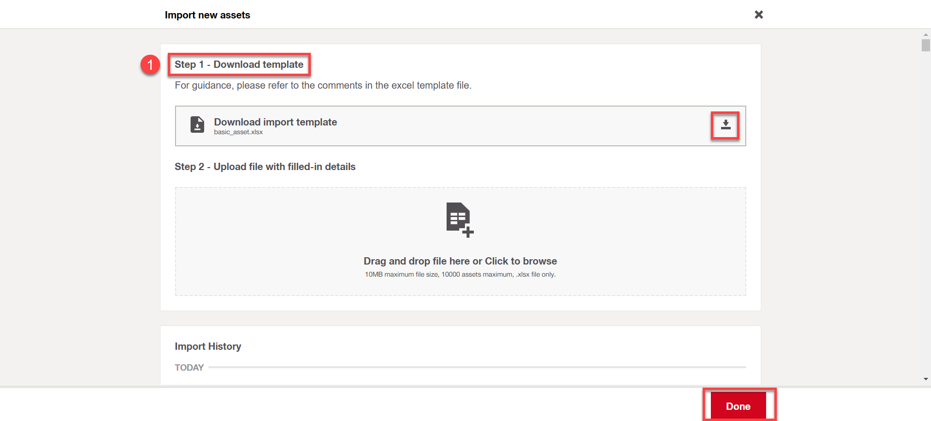

  • Complete step 1 by downloading the import template.

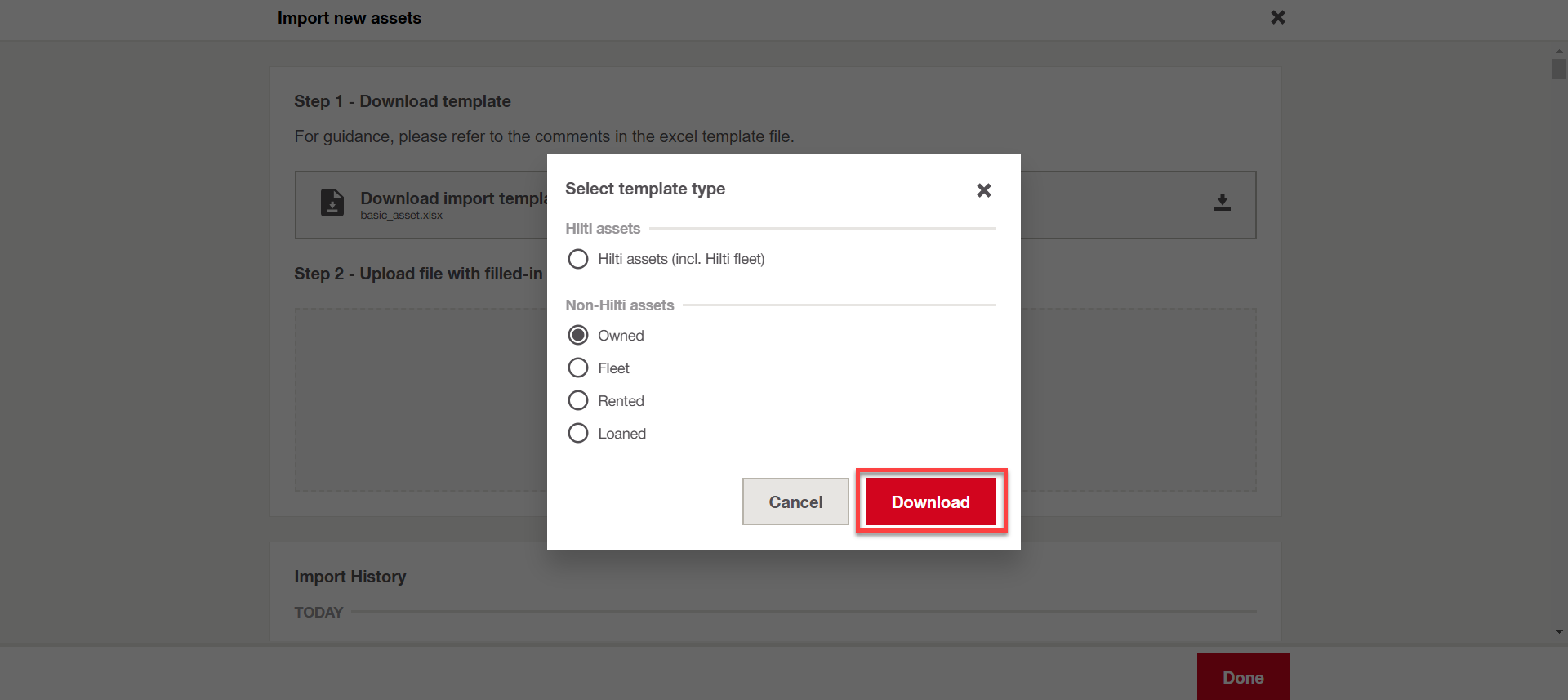

  • Select the template type for your asset, either Hilti or Non-Hilti. If you select Non-Hilti, specify whether it's Owned, Fleet, Rented, or Loaned. Then, click "Download." (For this article, we’ll focus on Non-Hilti assets.)

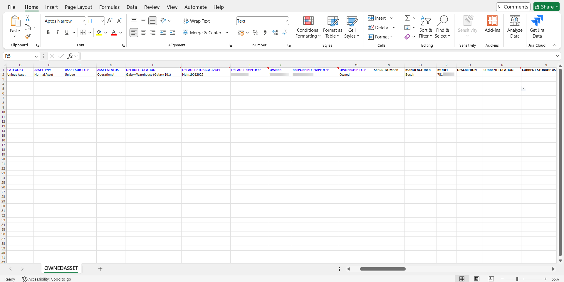

  • The Excel sheet will be downloaded, populated as needed, and clicked save.

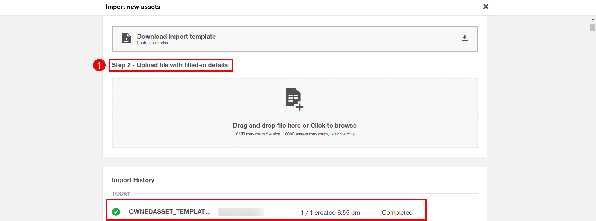

  • You can go to step 2, upload the Excel sheet, and click " done".

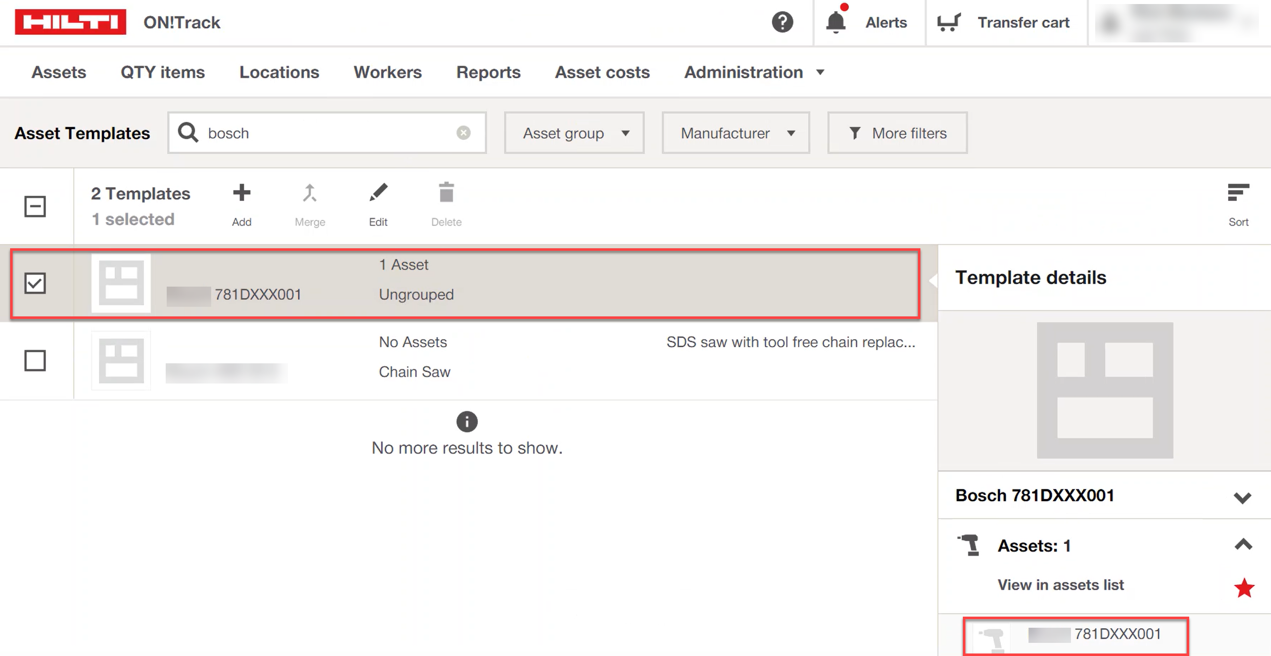

  • To check the asset, click Administration -->Templates and search for the required asset. You’ll see the asset in the template details under the asset template list.

  • Blue column headers = mandatory fields: If a column header is highlighted in blue, you must fill in its cells. Leaving them blank may cause errors.
