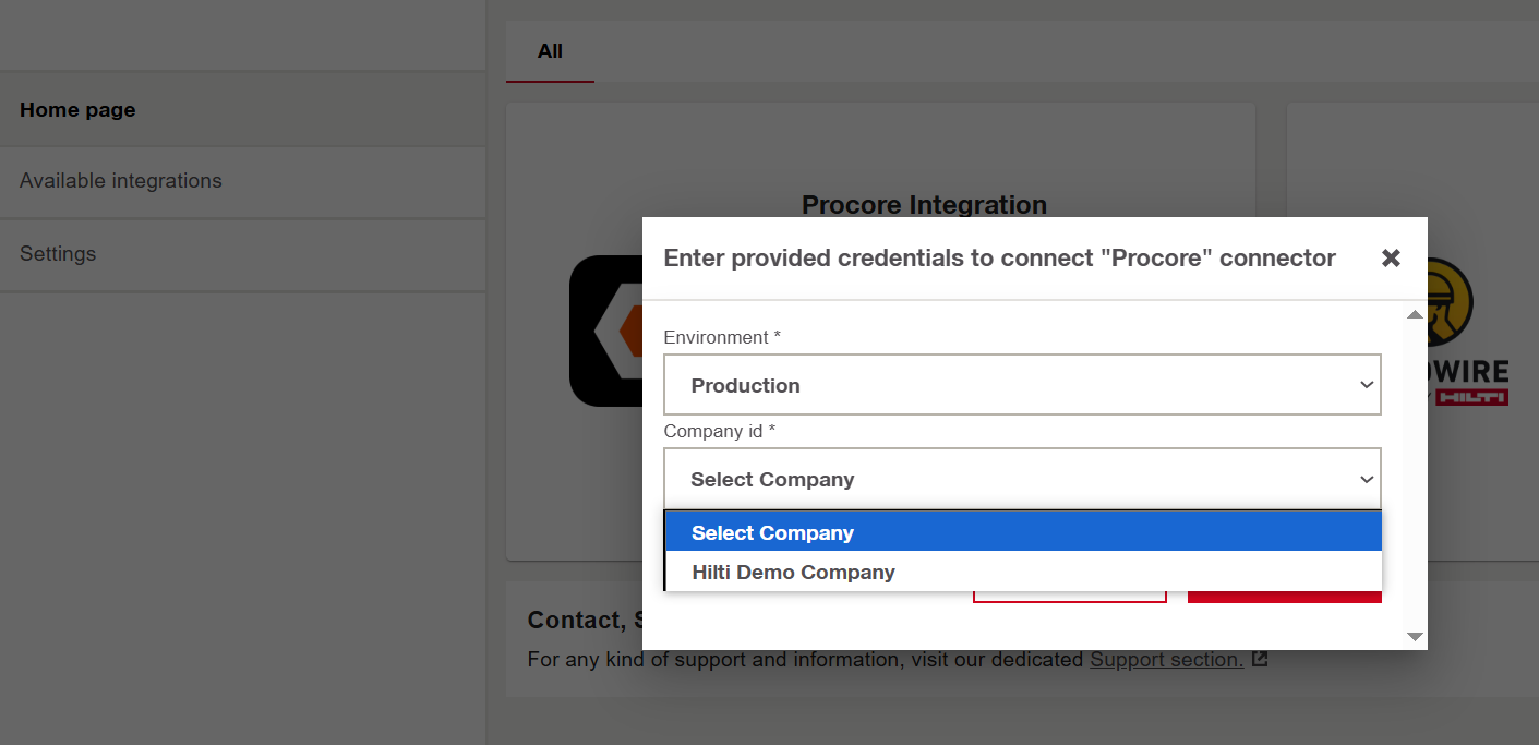

Connect with Procore Connector

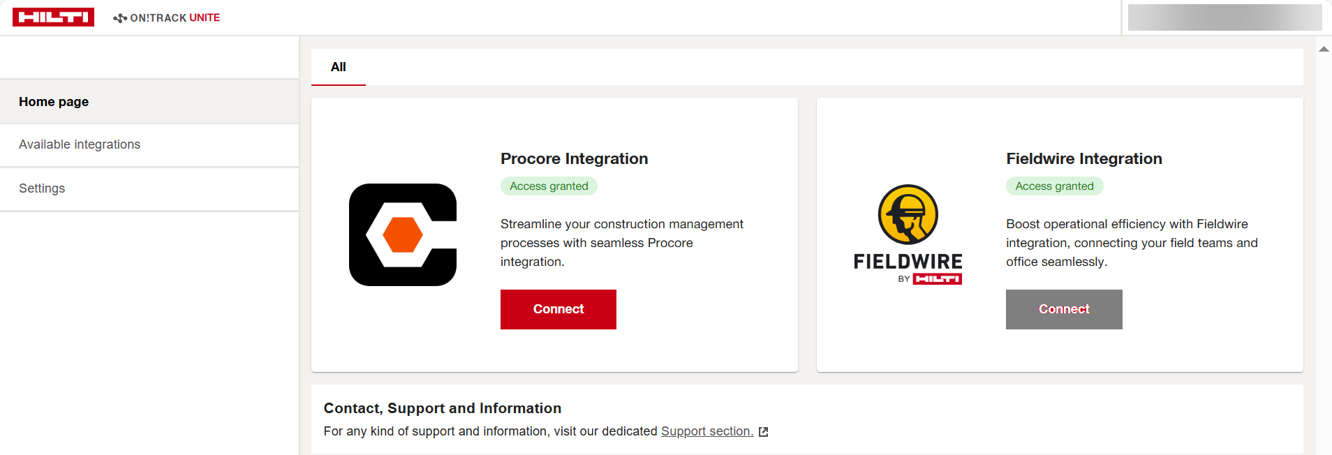

  • Click “Connect” to start linking your Procore account.

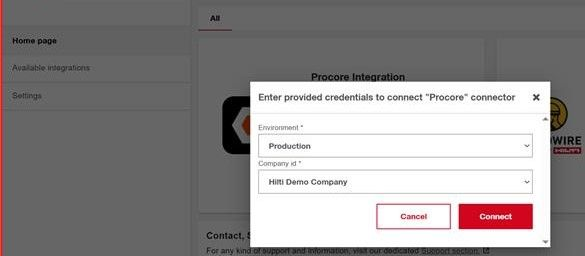

  • Choose your company from the dropdown list (these come directly from Procore).
  • Click “Connect” again to confirm.

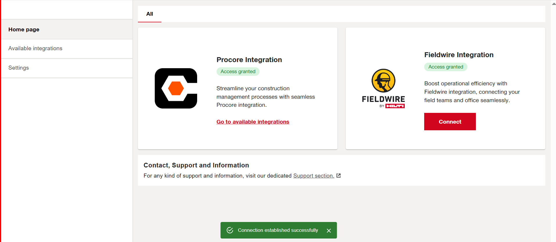

  • Once connected, the button will change to “Go to Available Integrations.”image (22).png
  • You’ll now see a list of Procore integrations. Click “Configure New” to start syncing your data.

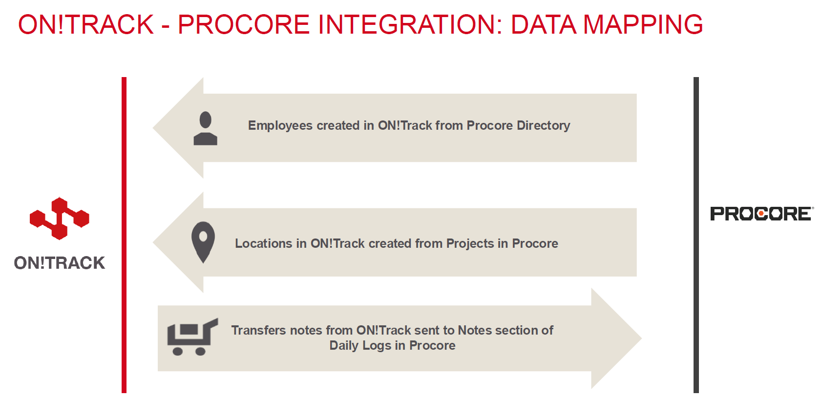

The following are the data mapping details:

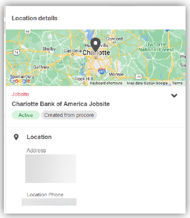

  • Location Mapping:
    • Your Procore projects automatically become jobsites in ON!Track.
    • If a Project Manager is assigned in Procore, they’ll be set as the Location Manager in ON!Track.
    • When a project is marked inactive in Procore, it will also show as inactive in ON!Track.
  • Employee Mapping:
    • Your Procore employee list is used to create employees in ON!Track.
    • Each employee is automatically set as a Location Manager in ON!Track.
    • Any new or updated users in Procore will sync with ON!Track every day to keep your records current.

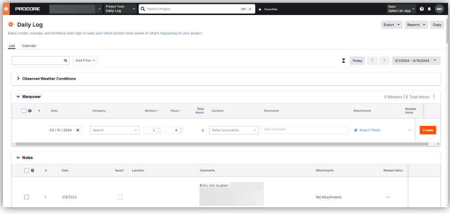

  • Transfer Notes
    • When items are moved to or from a connected jobsite in ON!Track, the details are automatically added to the Daily Log Notes in Procore.
    • These notes include information about any tools, materials, or quantity items that were transferred so your team stays in the loop.
