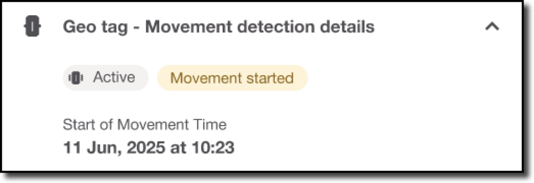

In the asset details panel you see the following segment:

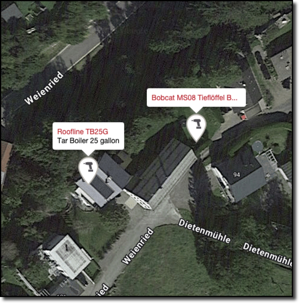

And you of course have the pin on the map.

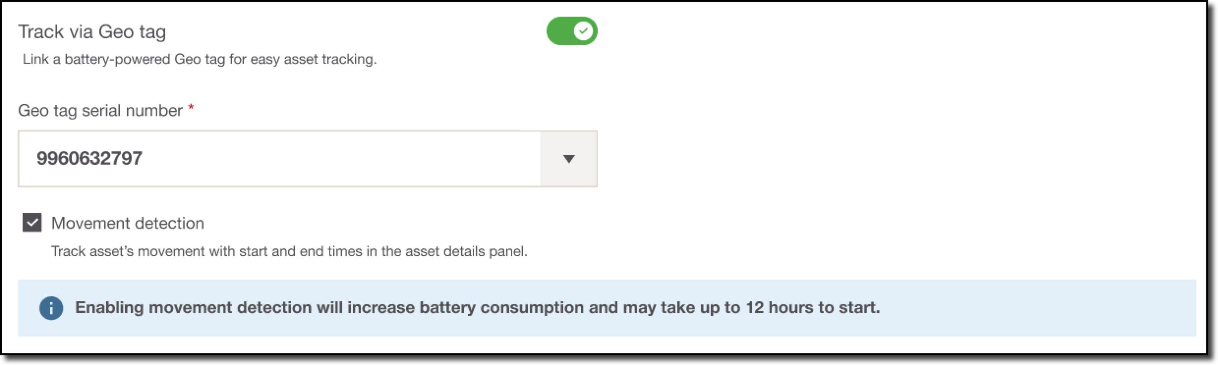

Setting up the Movement detection you will do through Edit asset. Select the asset that is tracked with a Geo tag and click Edit. Check the box Movement detection and the trakcer will update its configuration next time it wakes up. Either 6am or 6pm. Notice that the device will detect movement only after the next location update and might take up to 12h to start detecting movement.
