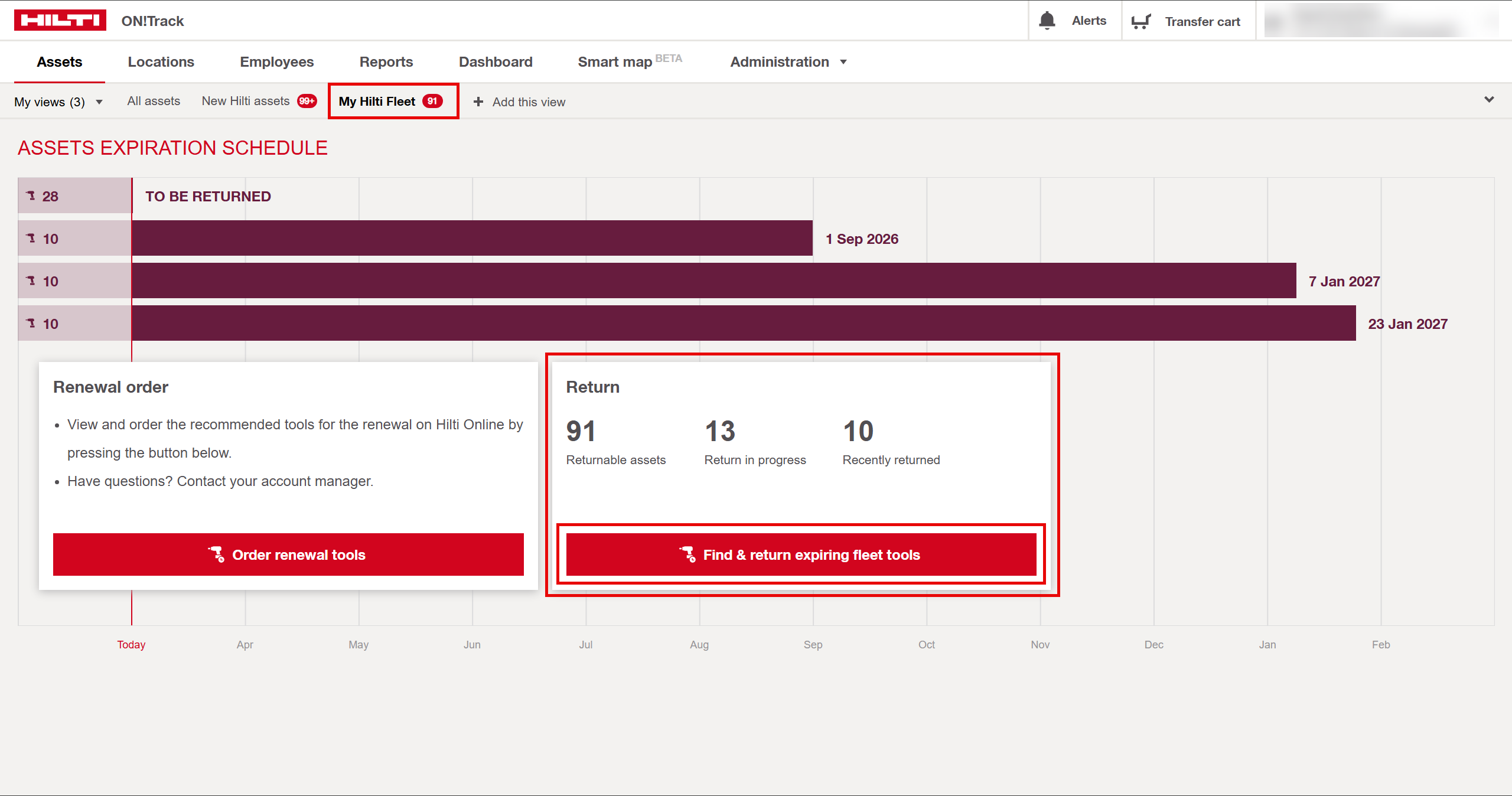

Web:
  • Go to “My Hilti Fleet” and select “Find & return expiring fleet tools.”

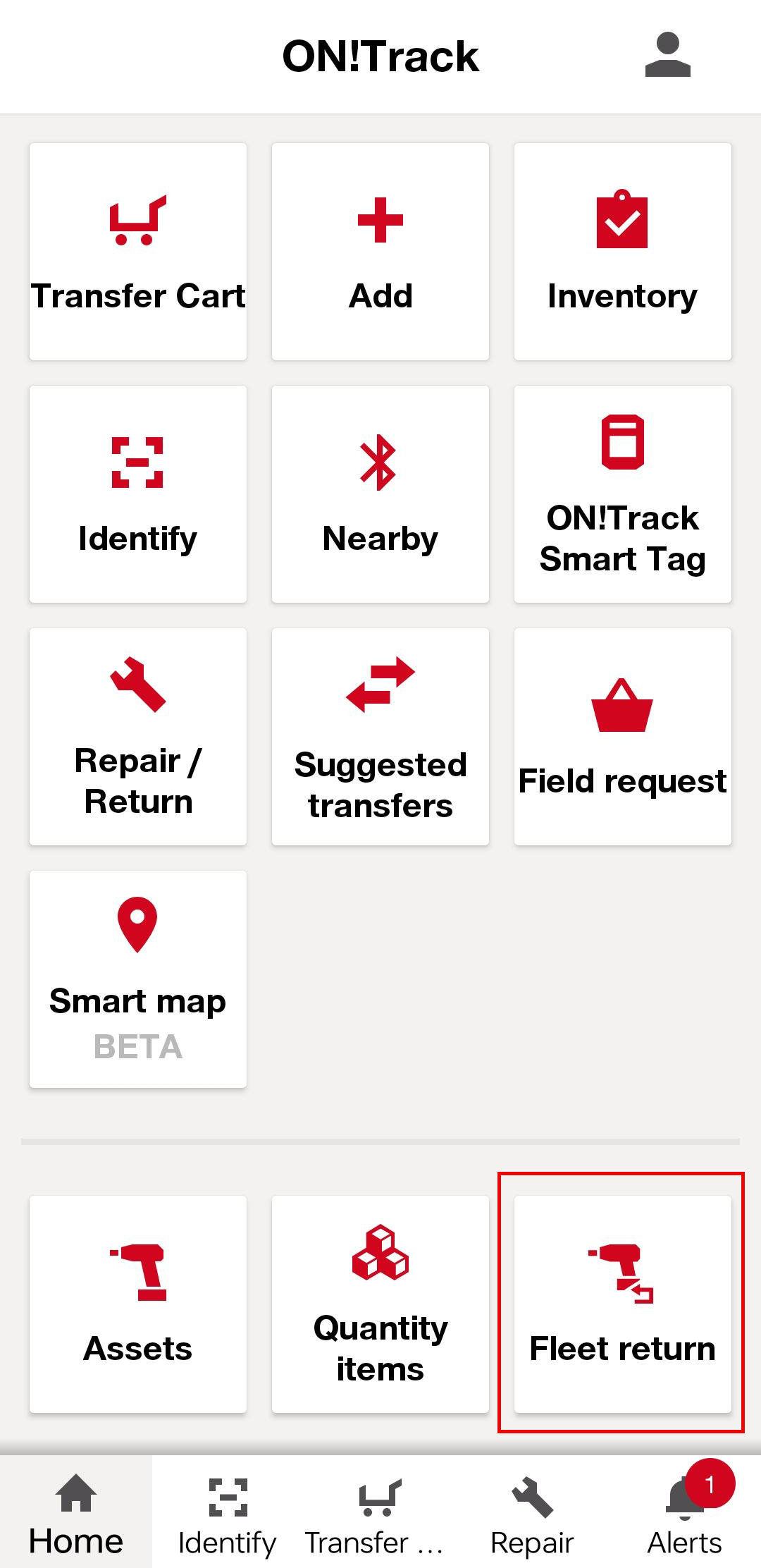

Mobile:
  • Launch the ON!Track app on your mobile device.
  • Navigate to the Fleet Return tile or section.

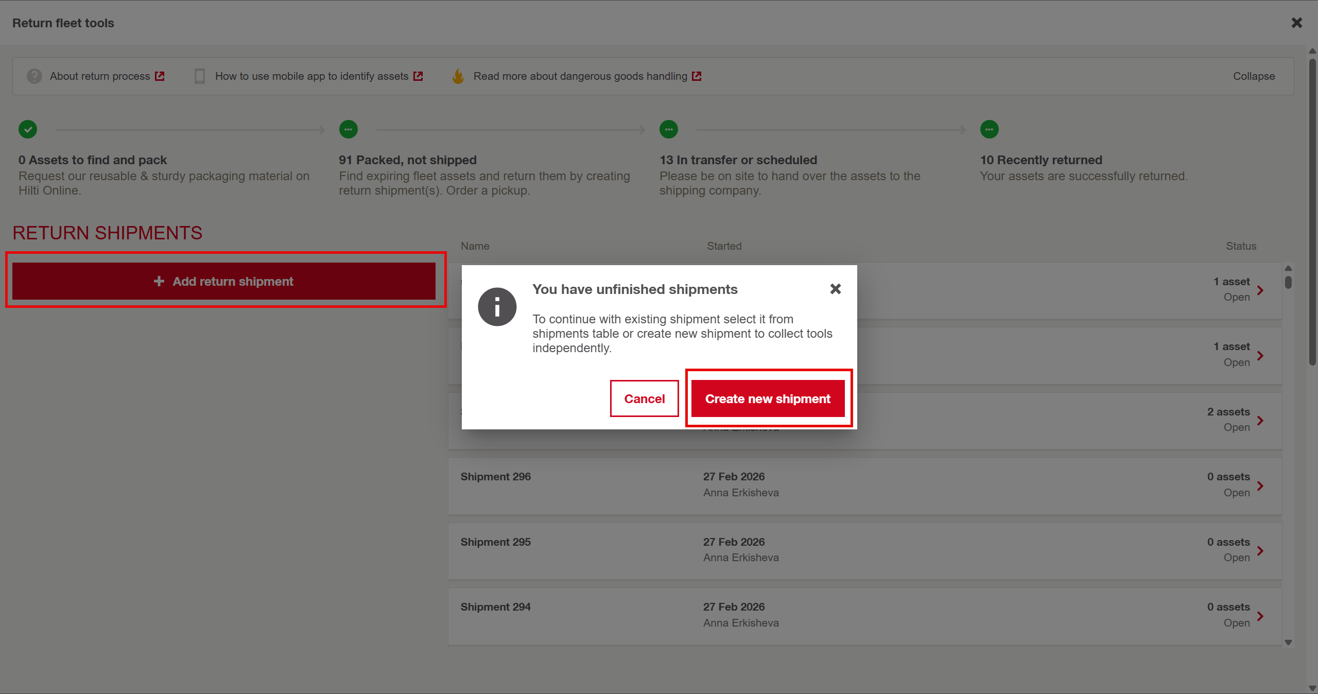

    • Web
      •  Start a new shipment and select Add return shipment.
      • Choose the tools that should be included in this shipment.

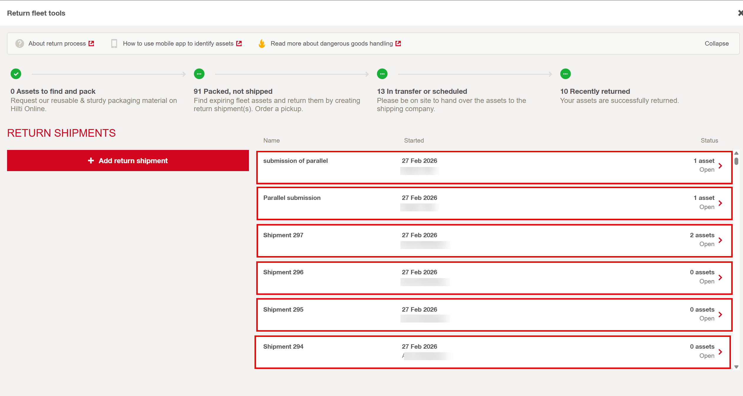

      • Or from the list of shipments, select any shipment with status, open to continue packing the remaining tools.

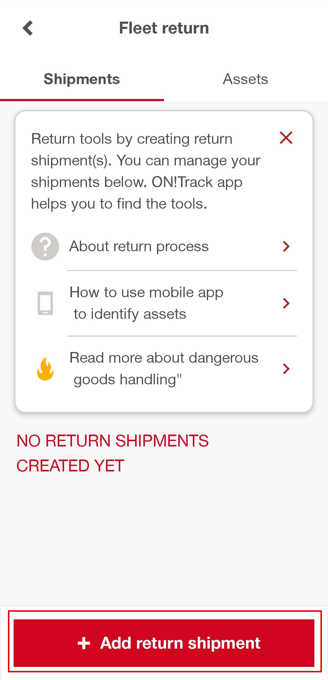

  • Mobile
    • Create a new shipment
      • Go to the Fleet Return Overview (web) or Fleet Return tile.
      • Select Add return shipment.
    • Continue an existing open shipment
      • From the list of shipments, select any shipment with status Open.
      • Open it to continue packing the remaining tools.

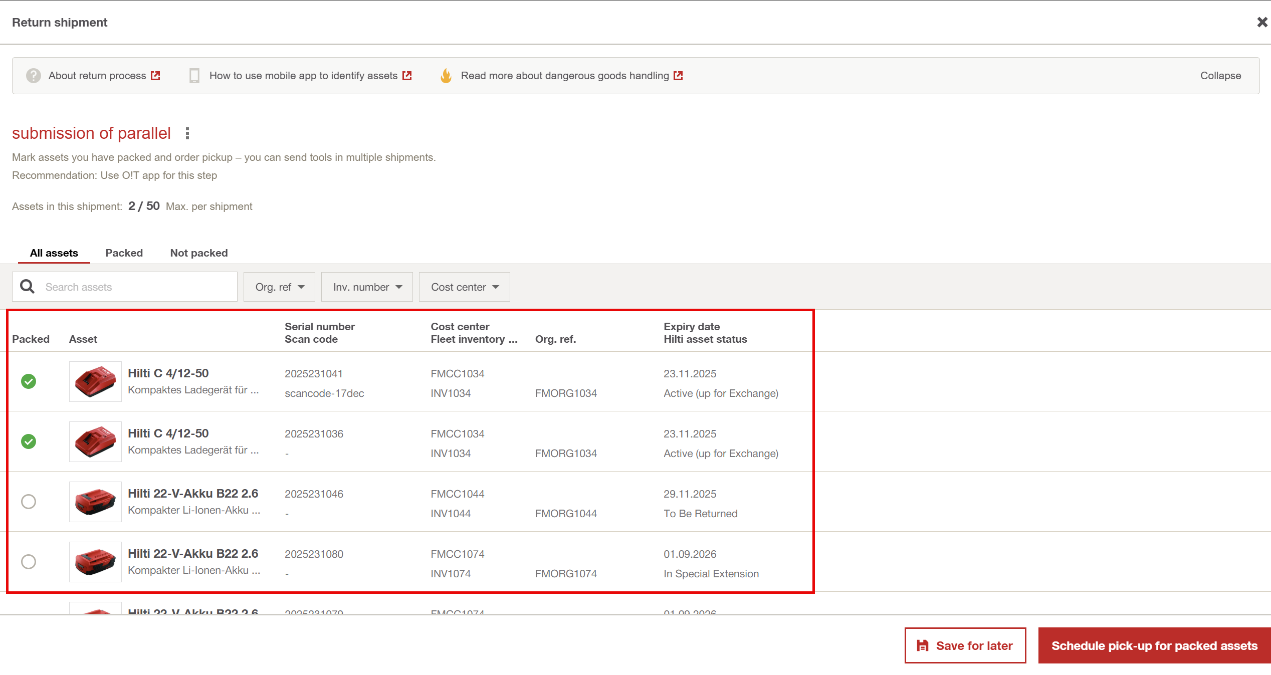

Packing Assets on Web
  • In your open shipment, find the asset list.
  • For each tool you are physically placing into the box:
    • Locate the matching tool in the list (by name, serial number, or filters).
    • Select the Packed radio button for that asset.

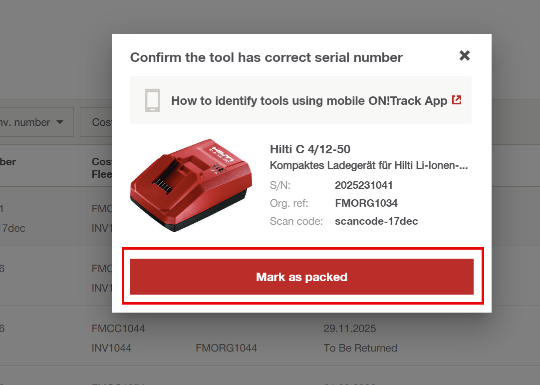

  • A confirmation screen will appear:
    • Check that the tool details match the item in your hand.
    • Follow any special instructions, especially for batteries and other dangerous goods.
  • Confirm to mark the asset as Packed.
Repeat this for each tool that you physically put into the shipment.
Note: Only mark a tool as “Packed” after you have actually placed it in the box.

  • Open the Fleet Return tile on the ON!Track mobile app.
  • Open the shipment you want to work on.
