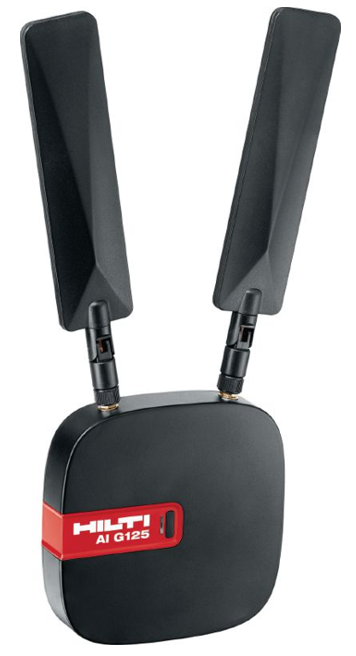

Stationary Gateway Overview
Overview
  • A Stationary Gateway is a fixed device installed in one place, such as a warehouse or depot.
  • It needs power and network access to work.
  • It is assigned to a specific location in ON!Track.
  • It is not a GPS device.

How it works
Think of a Stationary Gateway as a fixed Bluetooth listener:
  • A passive tag needs to be scanned manually.
  • A Smart or Active Tag sends a Bluetooth signal.
  • The Stationary Gateway listens for these signals and sends updates to ON!Track automatically.
In practice:
  • Assets are fitted with Smart Tags.
  • The gateway detects those tags when they are nearby.
  • The gateway sends presence data to the cloud.
