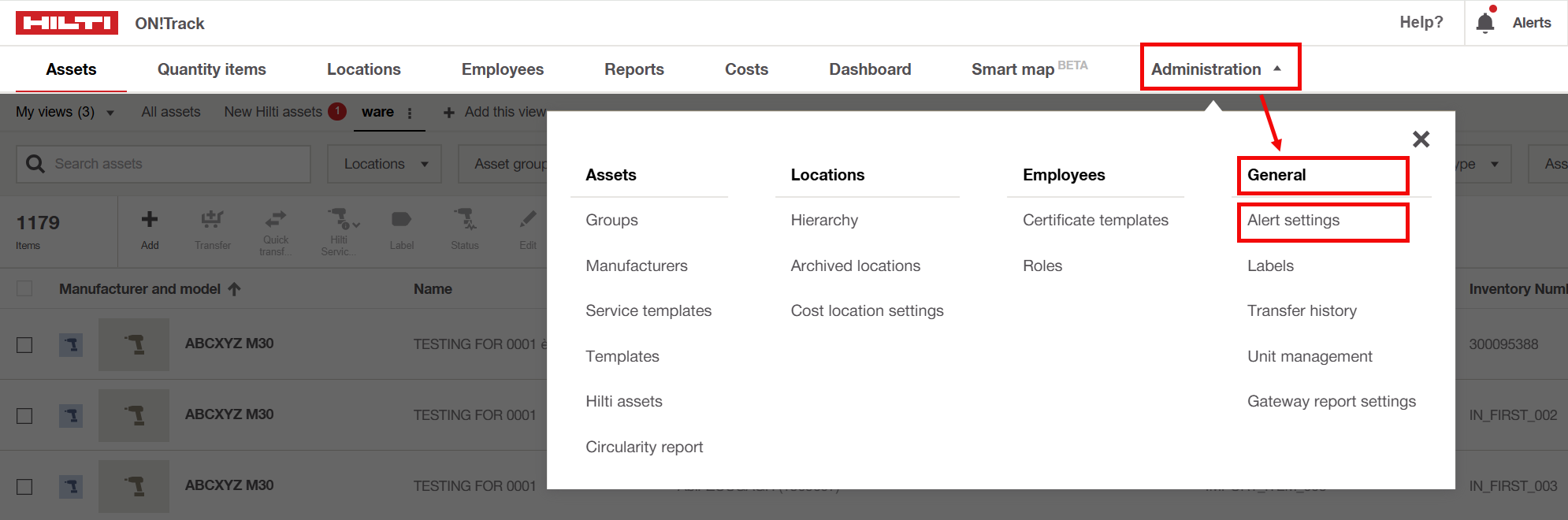

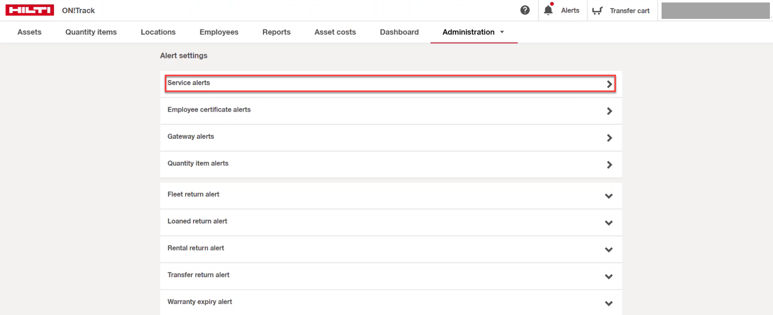

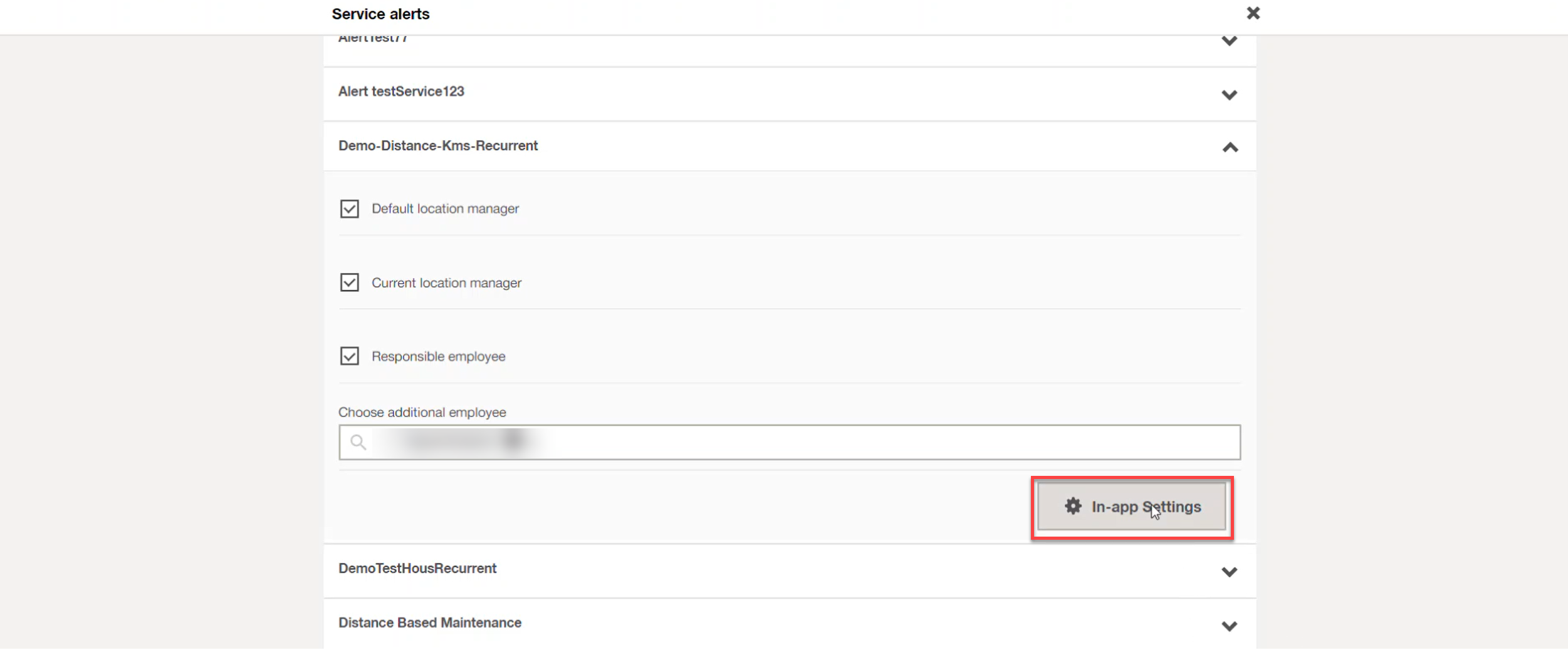

  • Click on the "Service Templates" from the tab Administration --> General --> Alert Settings.

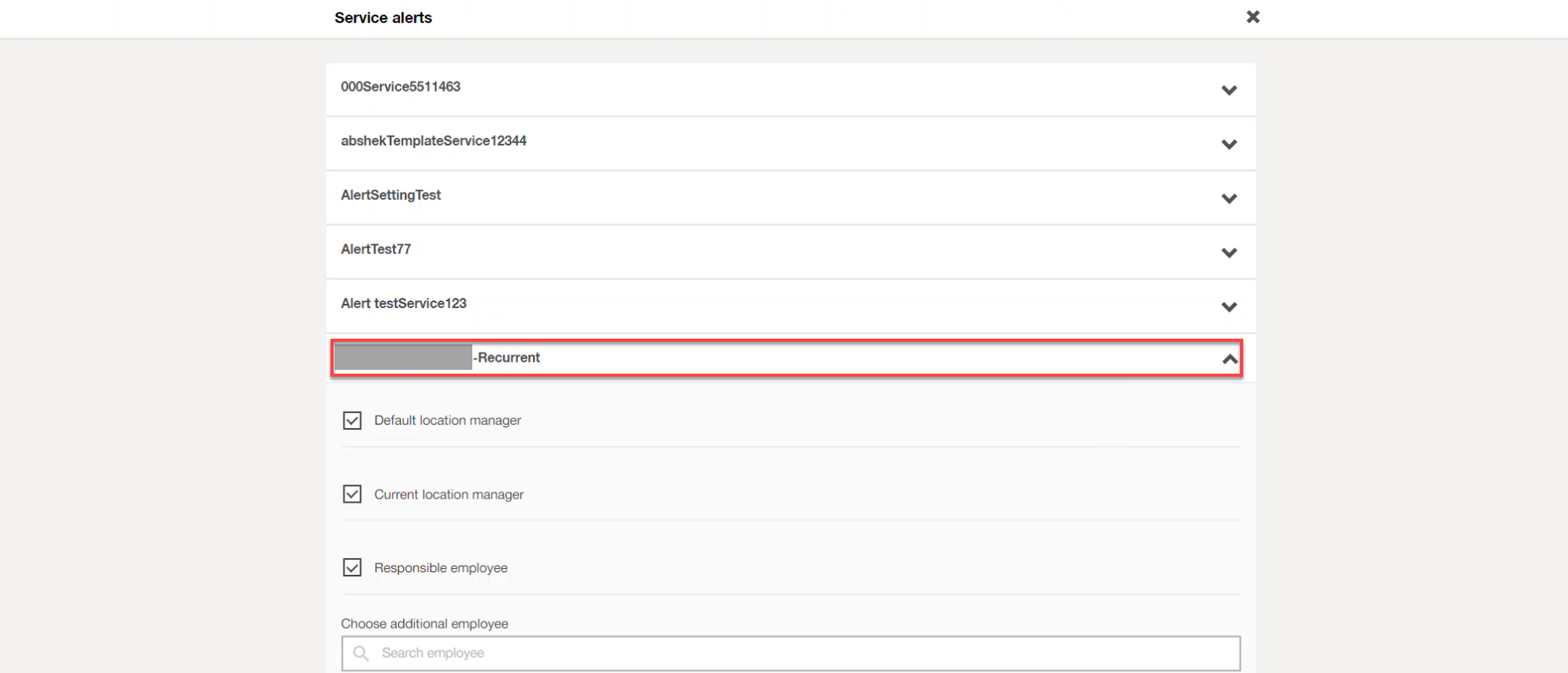

  • Click on the service alert to view the details you need.

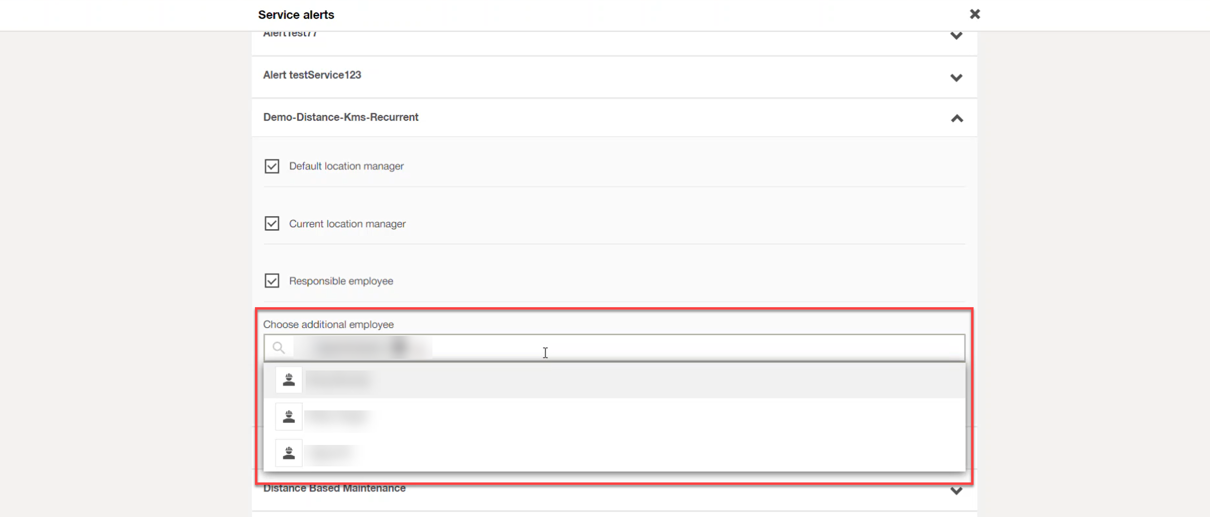

  • Type the employee names with commas between them, then go to the app settings.

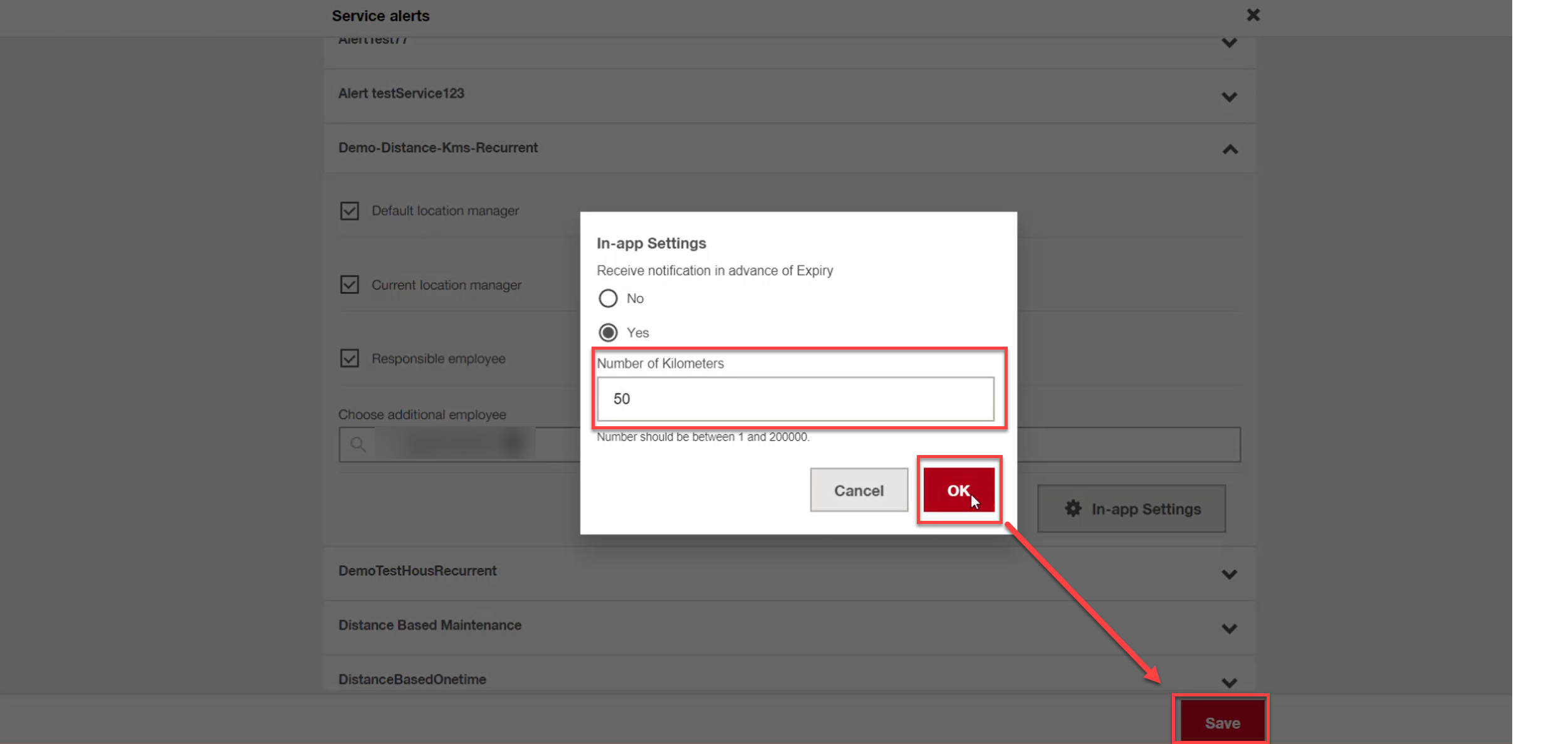

  • Update the number of kilometres and click on "Save" to save the setting.

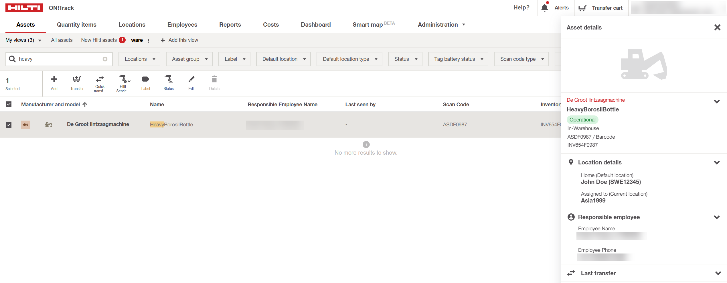

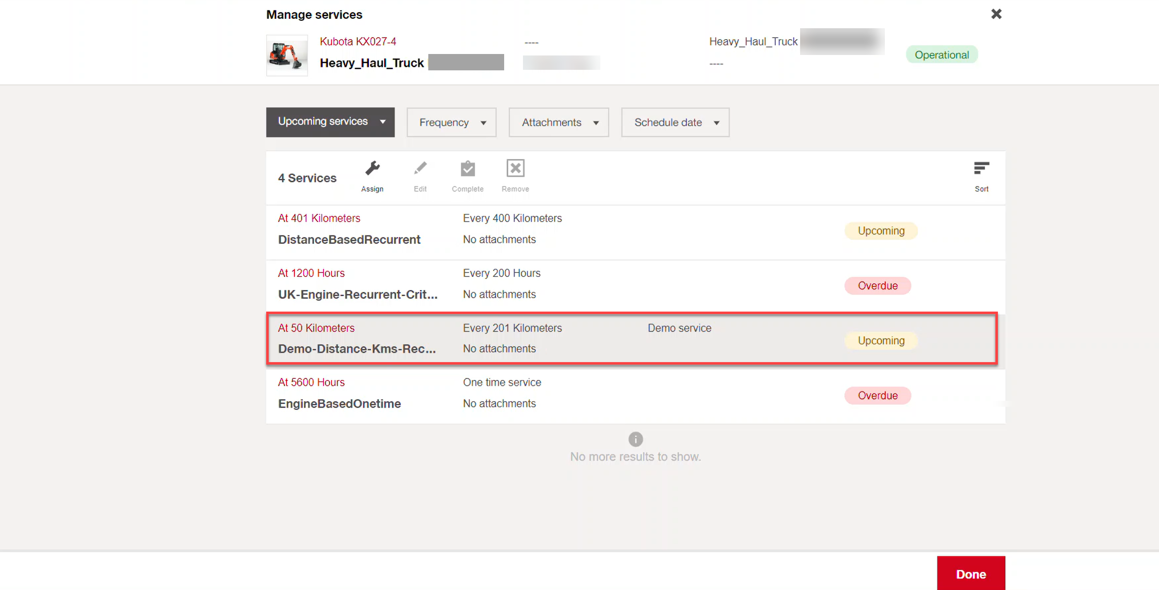

  • Go to the "Asset" and search for the required asset.
  • Scroll down to the Asset Details section and open the Upcoming Services.
  • Here, you can see upcoming and overdue services for the selected asset and get more details.
