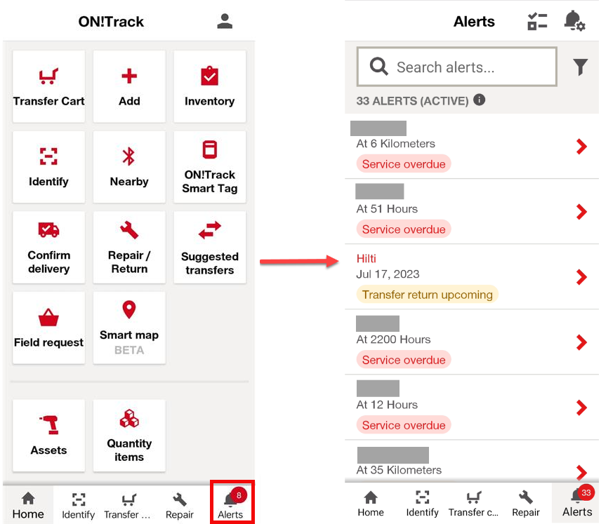

Open the dashboard, click "Alerts". The alert list will open. You can just search for and select the desired alert.

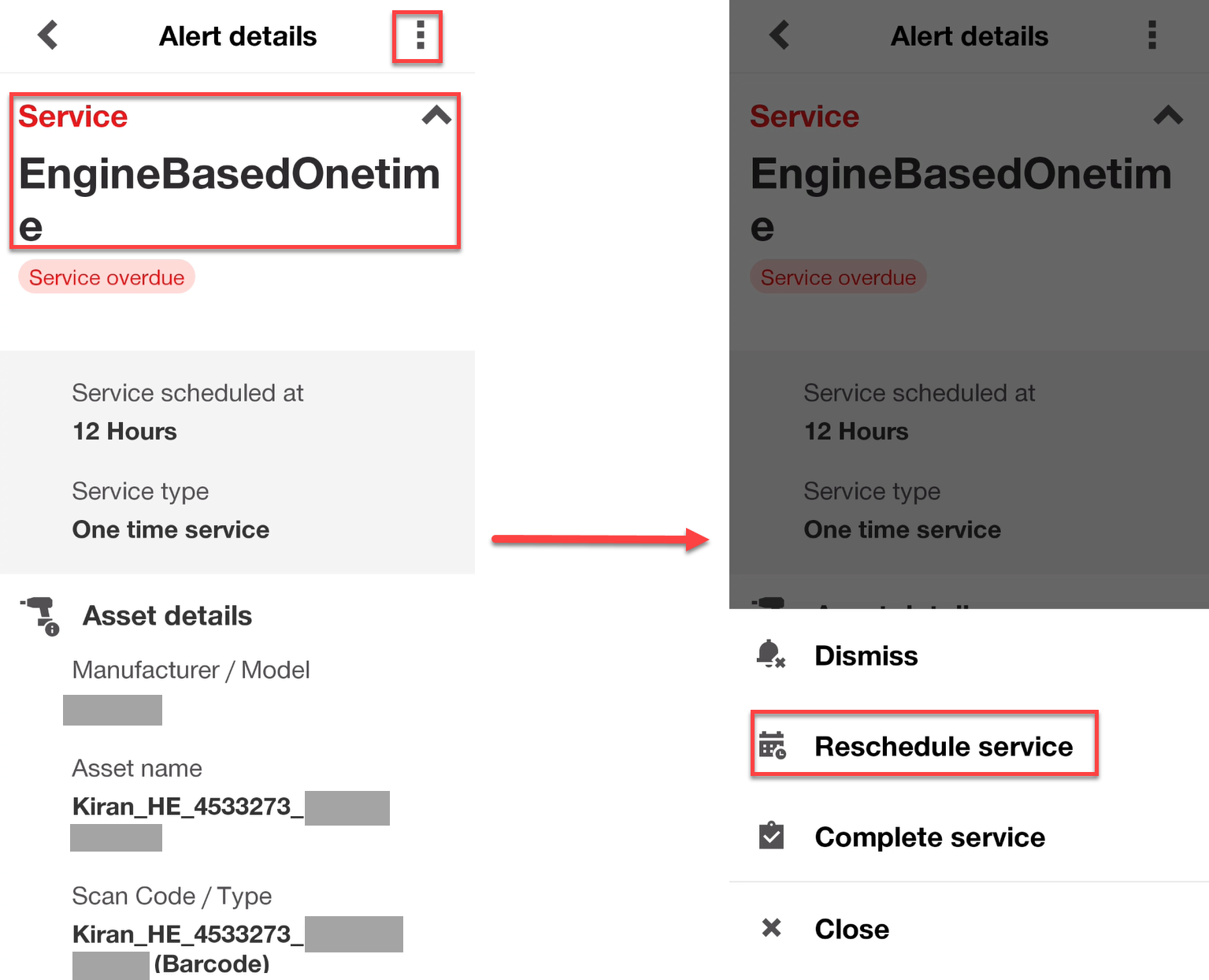

Select the alert, click the three dots, and choose "Reschedule Service" to finish the service.
You can also complete the service from this dropdown.

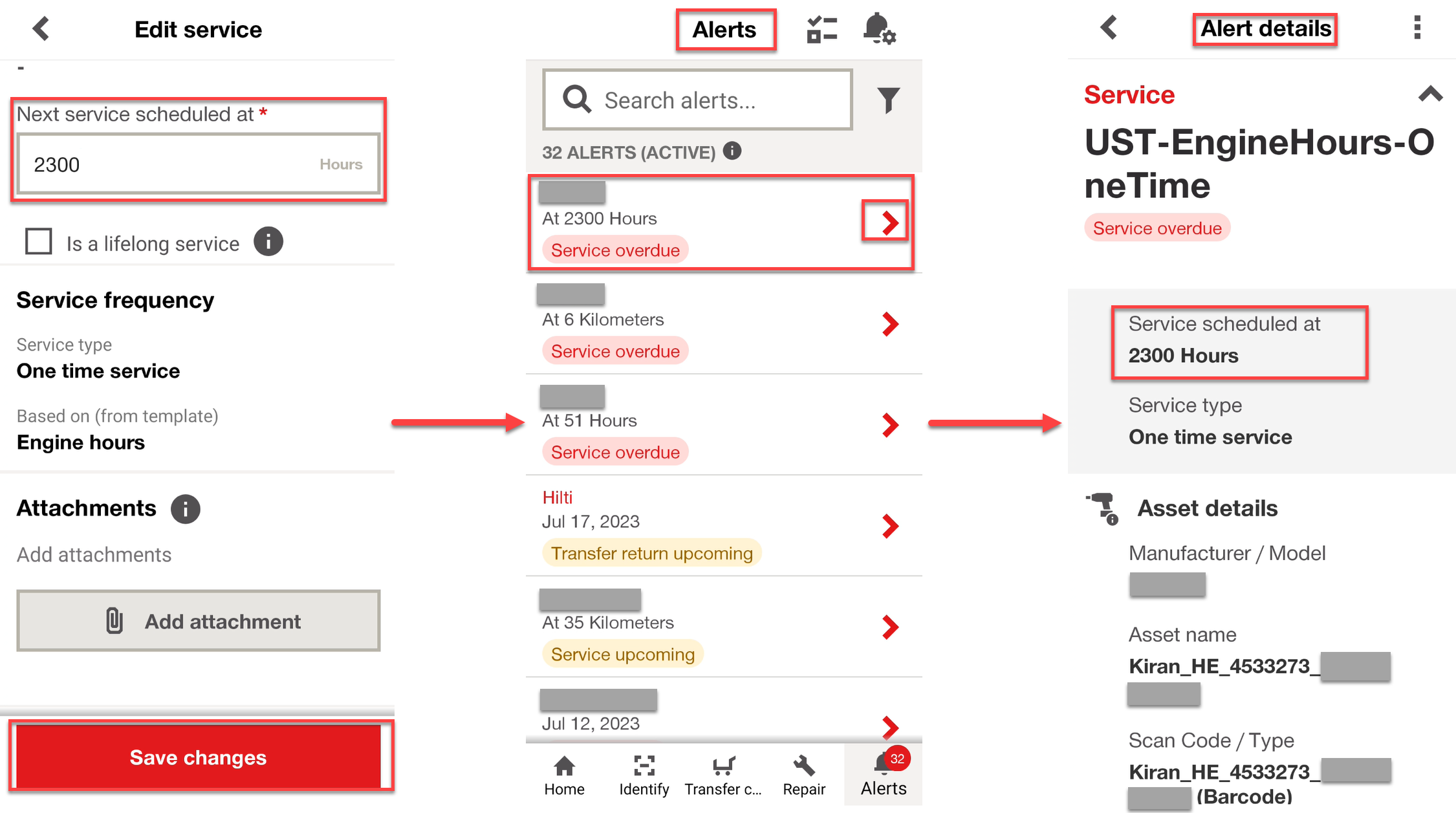

Update the field (Next service scheduled at) and click “Save Changes.” You’ll find the updated service in the alerts tab. Click on it to view the details.
