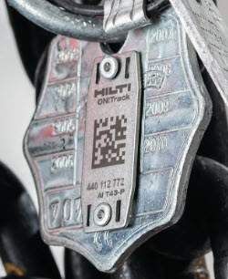

  • T43 Metal Tags - These stainless-steel tags can be riveted, screwed, or cable tied to assets that are exposed to very tough conditions.

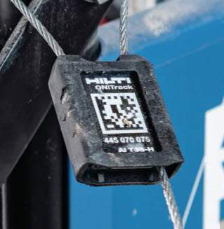

  • T35 Tags - These tags are attached via a wire shackle and encased in a plastic housing. This makes the very durable.

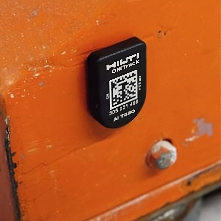

  • 3M Tape: Our most common attachment method. After cleaning the tool, the tag can be attached to any flat surface, making it very difficult to remove.
  • Wire Adapter: The T320 tag can be placed inside a small housing and attached to an asset using a wire shackle.

  • T320 Sensor Tags - Our standard sensor tag which we attach to tools for ON!Track + Fleet Management accounts. They allow scanning by Mobile and Gateway and also store "Idle" information.

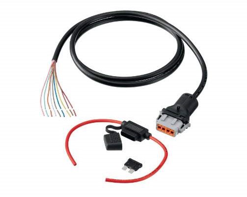

The Heavy Equipment gateway is designed to be hardwired into the machine by a dedicated installer. It can by typically connected to the CANBUS to read additional data such as fuel consumption and idle hours.
