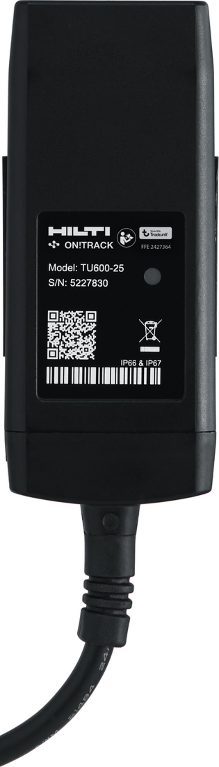

Van Gateway (TU-600)
  • Installed in service vans.
  • Scans for nearby smart tags attached to tools and assets.
  • Sends location and inventory data to the system.
  • Useful for tracking assets in transit or on job sites.
HEM Gateway (Heavy Equipment Management) (TU-600)
  • Mounted on heavy equipment or containers.
  • Scans for smart tags on assets stored or used with the equipment.
  • Sends both geolocation and inventory data.
  • Provides information on the Machinery utilization

  • Van & HEM Gateways (TU-600):
    • Scan every 10 minutes when parked.
    • Scan every 2 minutes when moving or working.
    • Tested to detect up to 500 smart tags reliably.
