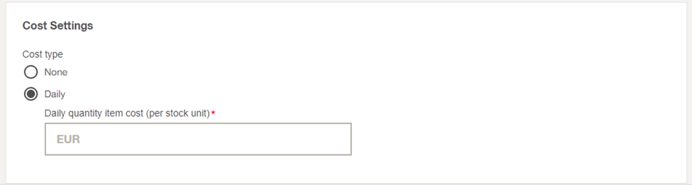

Setting Up Cost Settings for Quantity Items
Manual Edit:
  • You can set a daily rate when adding or editing a quantity item.
  • This triggers automatic cost charges to the correct location based on usage or movement.

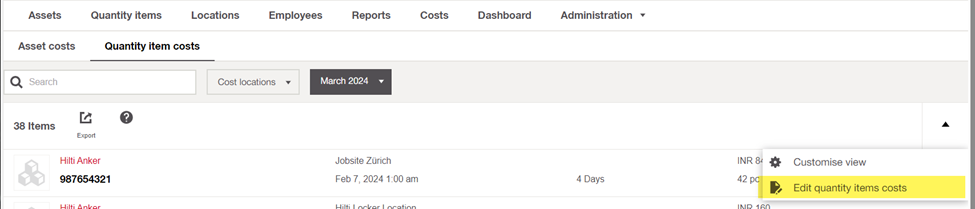

Mass Edit:
  • You can mass edit daily rates by clicking Edit in the quantity item cost list view.
  • This lets you update multiple items at once, saving time and effort.

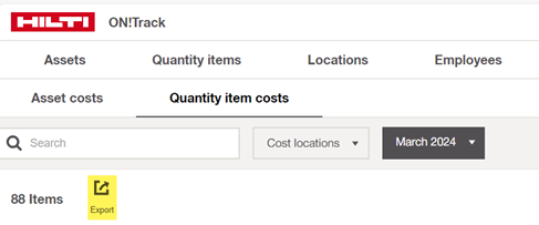

Export
  • You can export up to 10,000 items at a time.
  • If more items are shown, use the cost location filter to reduce the number.

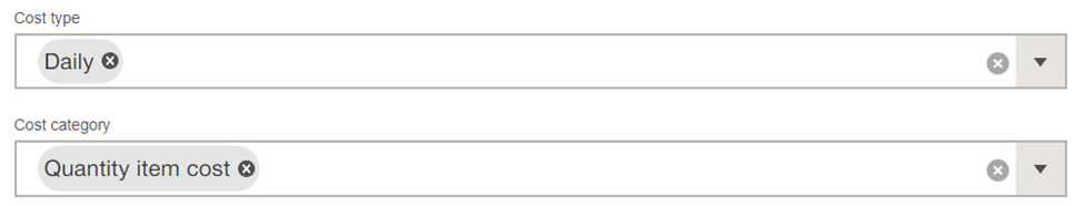

Report
  • You can download a file that shows all cost types, including assets, quantity items, and plug costs, for a complete view of expenses.
  • To see only quantity item costs, use the "Cost Category" filter and select "Quantity item cost".
  • To include only items that have been used, use the "Allocation Status" filter and select "Consumed".
