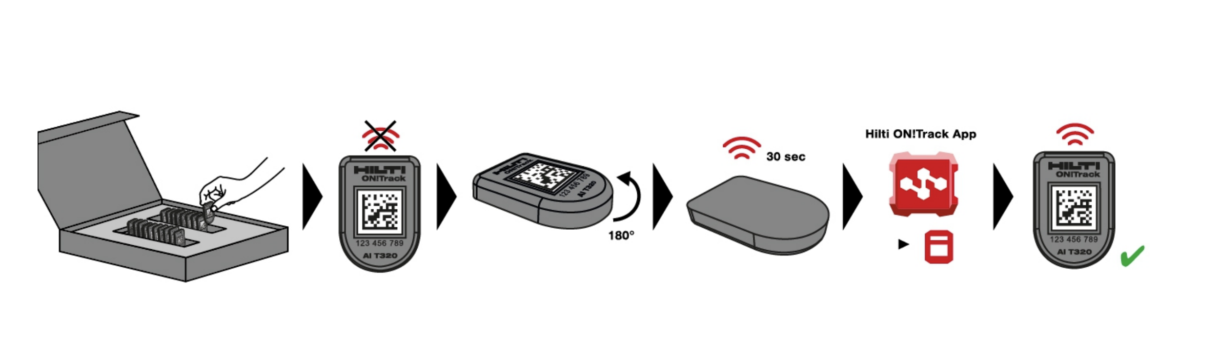

Tags are delivered in Storage Mode, so they do not waste battery life while in storage. This reduces/turns off their Bluetooth beaconing. To ‘wake up’ the tags, you first need to be activated by a mobile phone.
Tag Orientation
The way you flip the tag, lengthwise or widthwise, does not affect its performance. As long as the tag is rotated a full 180°, it will register correctly.
