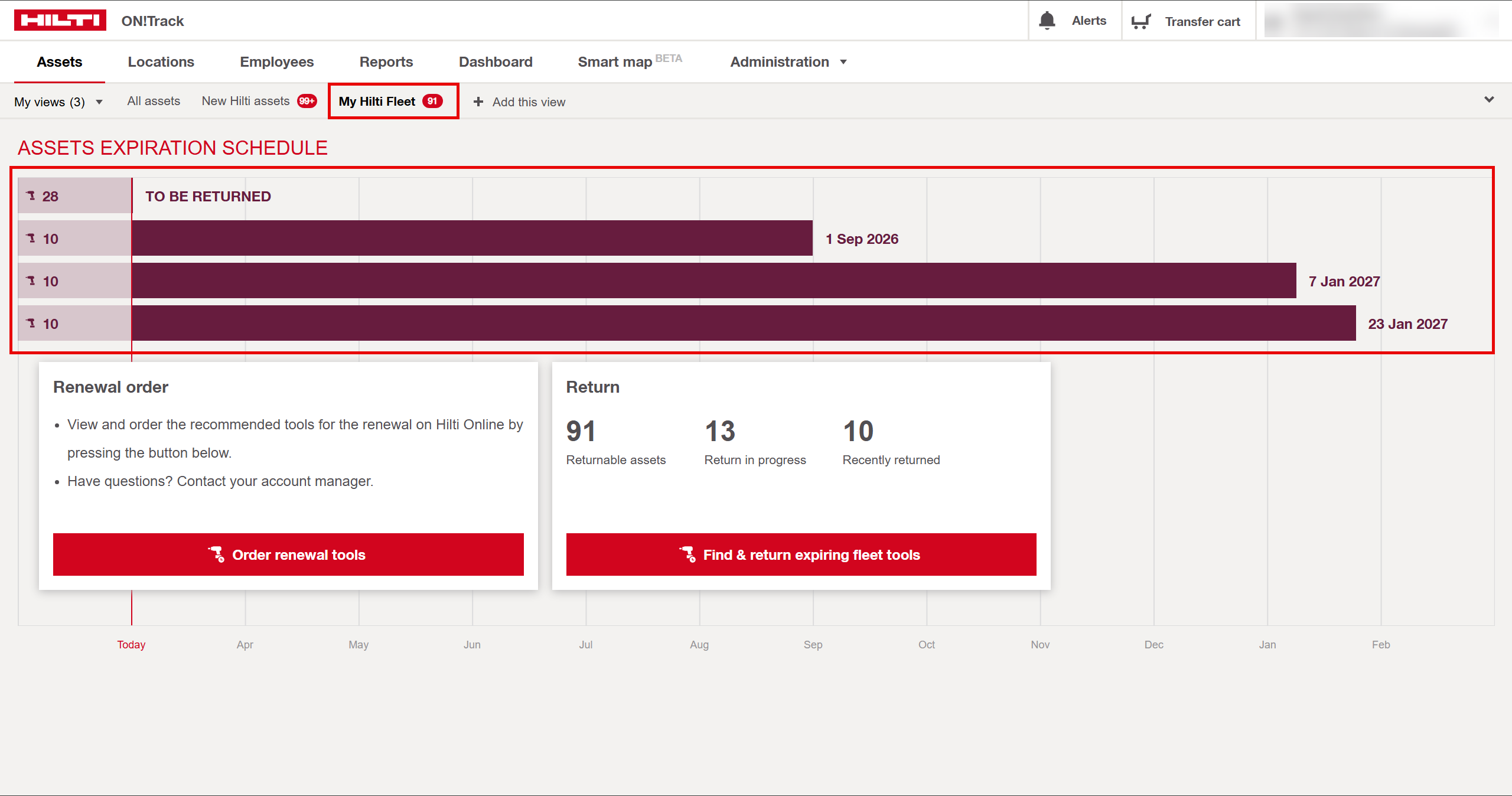

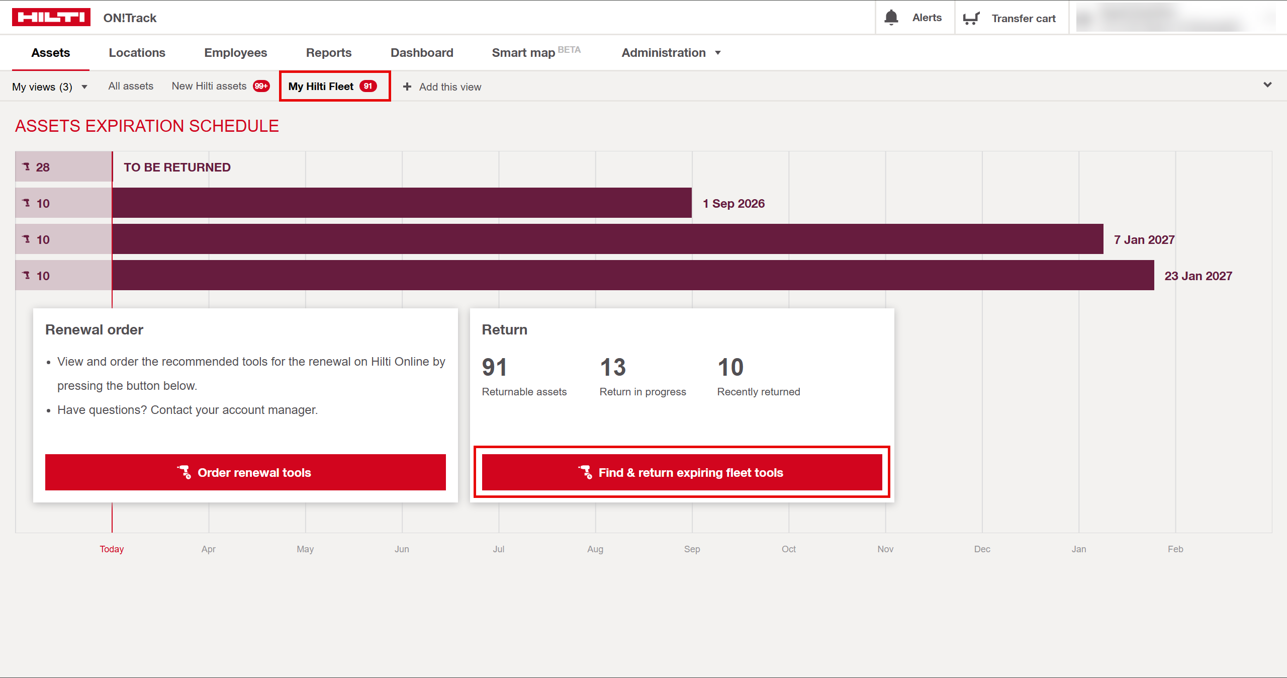

  • Log in to ON!Track Web.
  • Go to “My Hilti Fleet.”

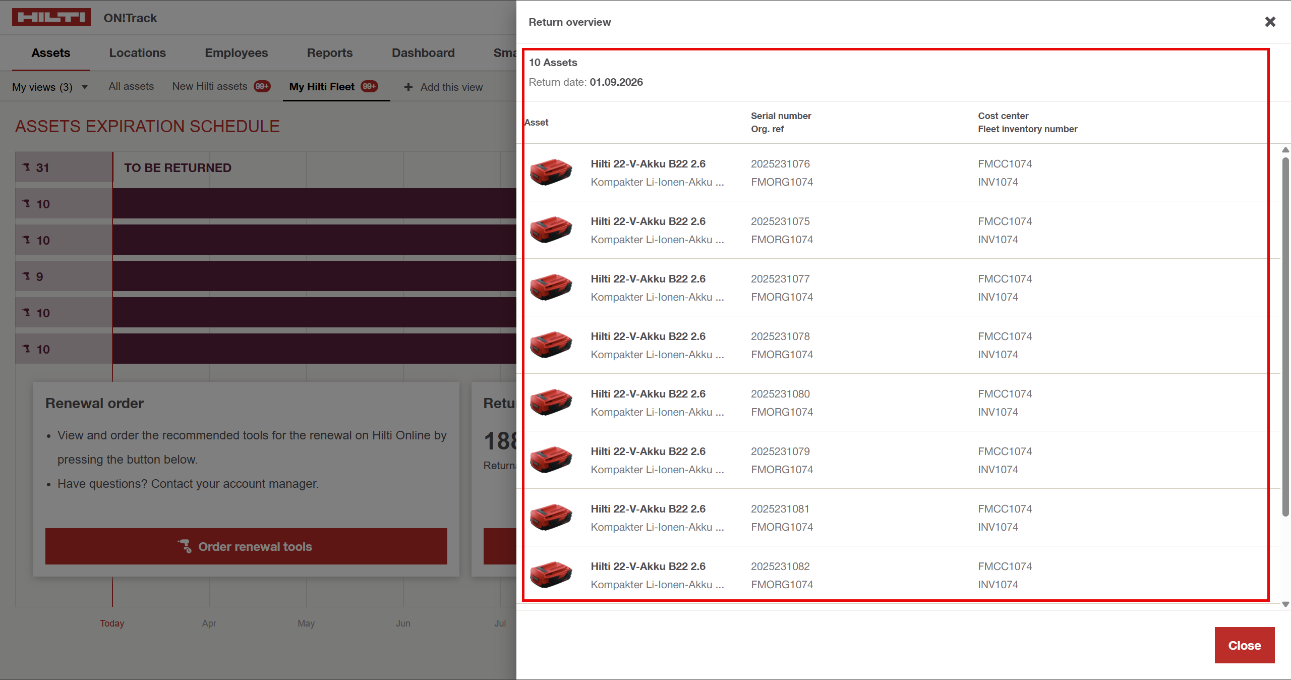

  • View the list of fleet assets eligible for return by clicking on the bars.

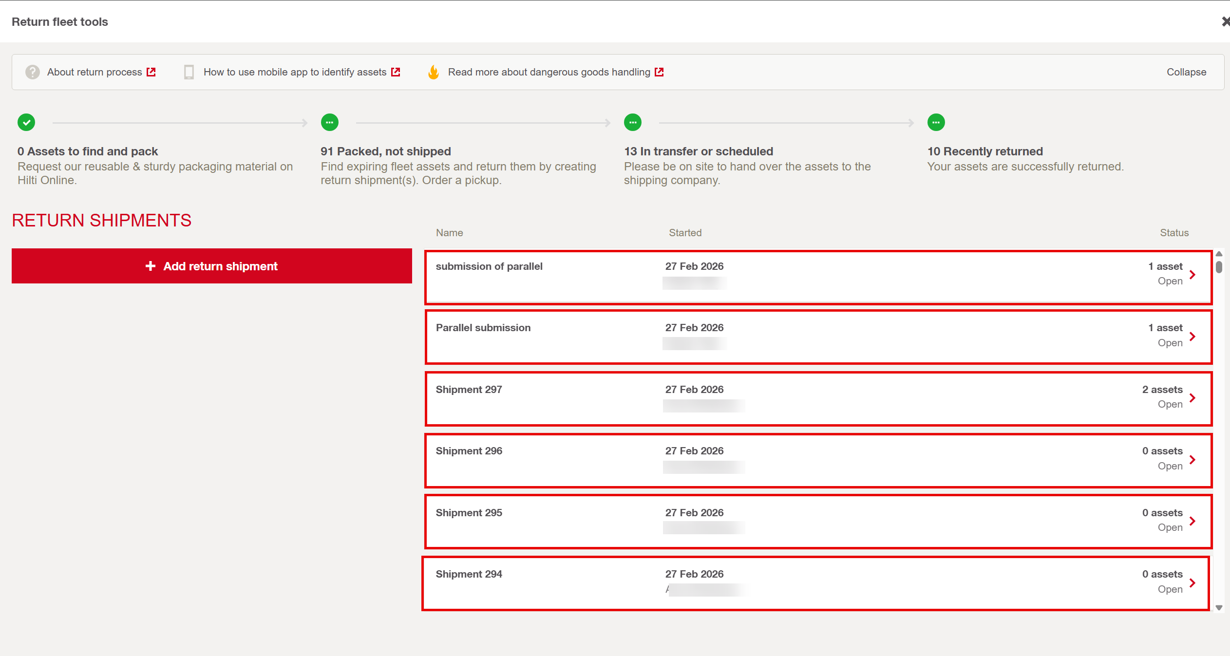

  • Click on the "Find & return expiring tools"

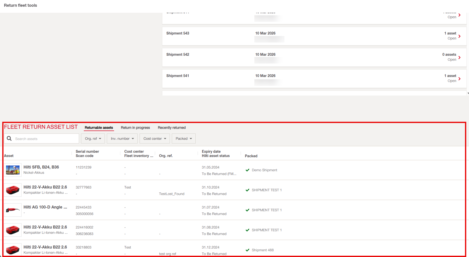

  • Use the search and filter options to quickly see the status of your assets:
    • Items still needing to be returned.
    • Items already submitted for pickup (return in progress)
    • Items successfully received by Hilti (recently returned)

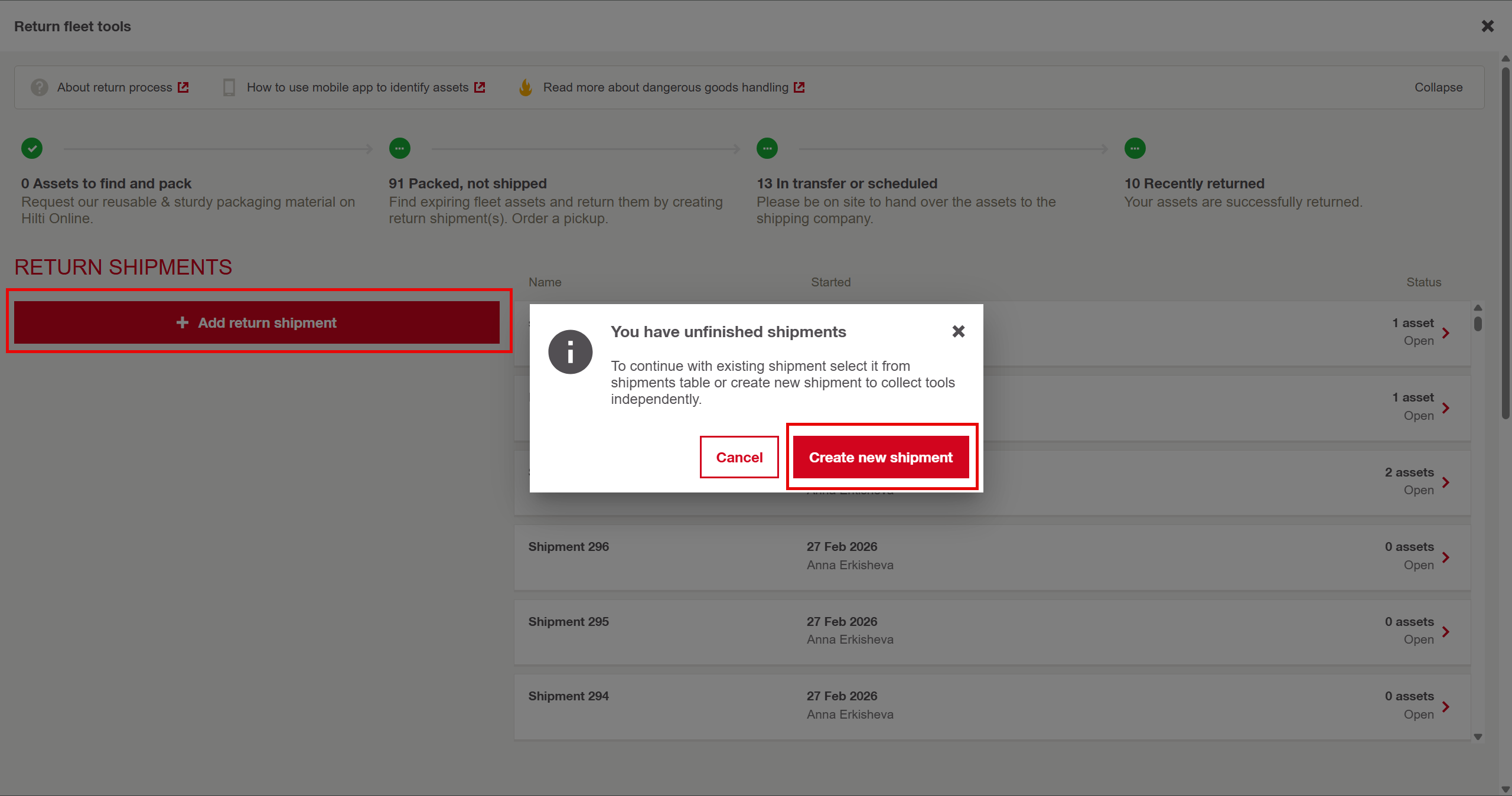

  • There are two options for the shipment which are mentioned below:
    • Start a new shipment.
    • Continue an open one.

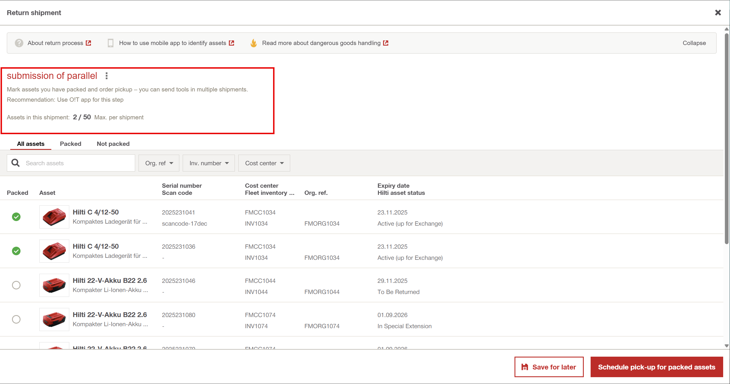

  • Select fleet assets to return (up to 50 per shipment).
  • Pack Returnable Fleet Assets
    • Physically pack selected fleet assets in a suitable box or container.
    • In the shipment, set the Packed radio button for each tool you place in the box.
    • Confirm the details on the confirmation screen (follow any safety instructions, e.g. for batteries).
    • Mark each fleet asset as packed in the system:
      • Select and confirm fleet assets as packed.

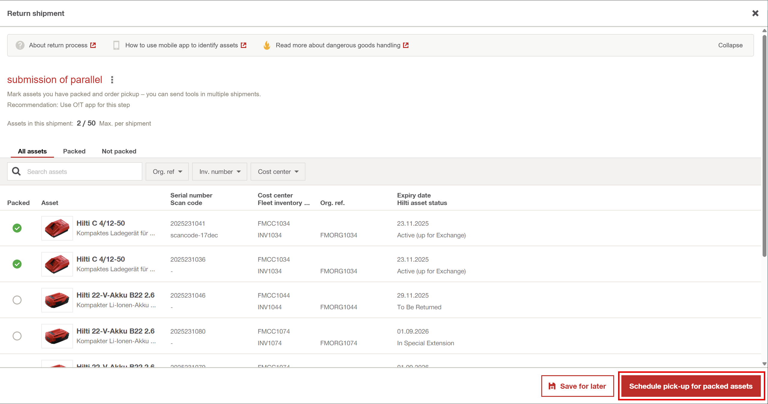

  • Submit the Return Shipment
    • After packing, submit the shipment in the system.
    • You’ll be prompted to schedule a pickup or, in some cases, customer service will contact you.
  • Schedule Pickup
    • Click Schedule / order pickup.
    • Enter pickup details (contact, address, preferred date) if prompted.
    • Confirm the pickup request.

  • Track the Return
    • The Return Status Tracker shows:
      • How many assets still need to be found and packed
      • How many are packed but not shipped
      • How many are in progress
      • How many have already been processed by Hilti
    • Each shipment also has a status: Open, Processing, Submitted.
    • When all assets in a shipment are marked Recently Returned, the shipment is closed and removed from the list.

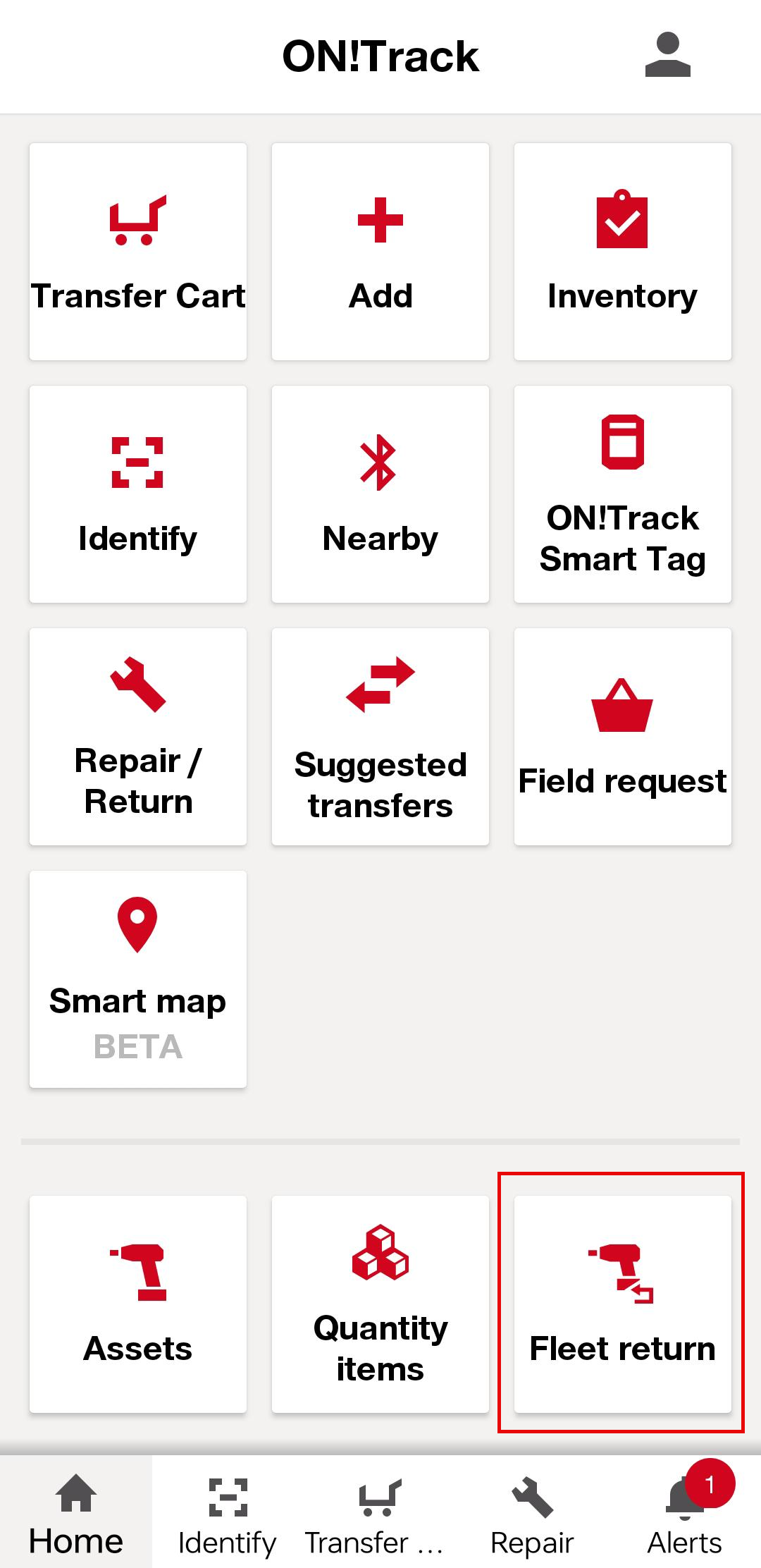

  • Log in to ON!Track Mobile.

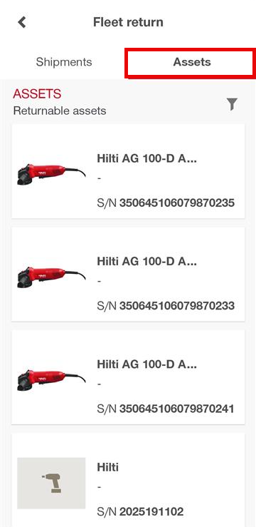

  • Tap “Fleet Return.”

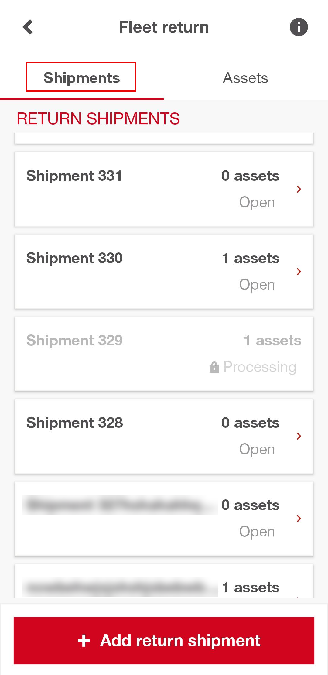

    • Use the Shipments and Assets tabs
      • Shipments tab (default): shows your return shipments.
  • Assets tab: shows tools that should be returned.
  • Use the filters to find specific tools.
  • Create or Continue a Shipment
    • Start a new shipment or continue an open one.

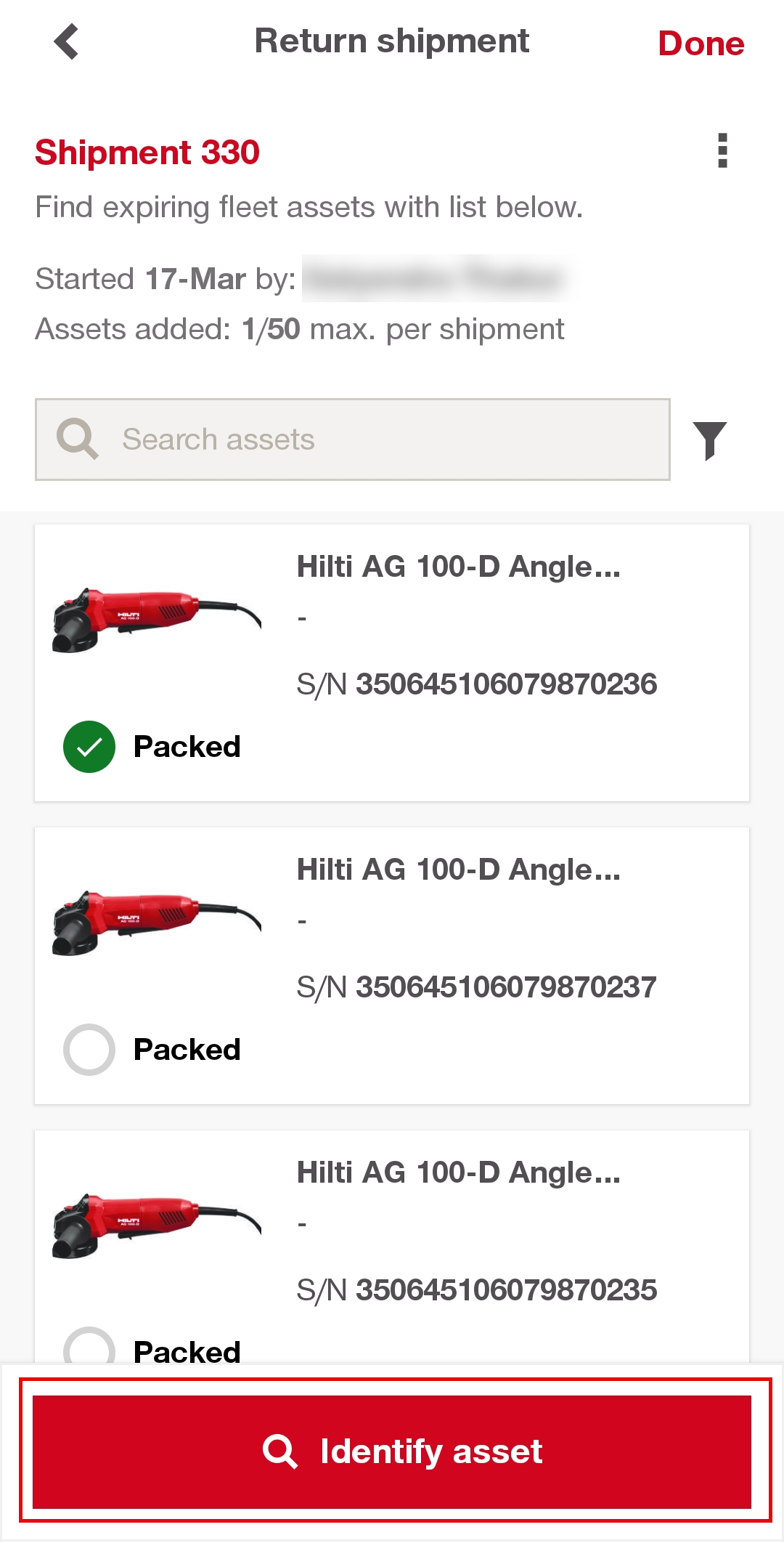

  • Identify and pack tools
    • In the shipment, tap Identify Asset.
    • Scan the tool using the camera or NFC:
      • Correct returnable tool : green screen and a confirmation screen for that tool type.
      • Wrong tool :  red screen. You are informed not to pack this tool in the current shipment.
    • If scanning does not work:
      • Enter the serial number, scancode, etc. in the search bar or use filters,
      • Then mark the tool as Packed using the radio button.
  • Schedule Pickup
    • Tap Schedule / order pickup.
