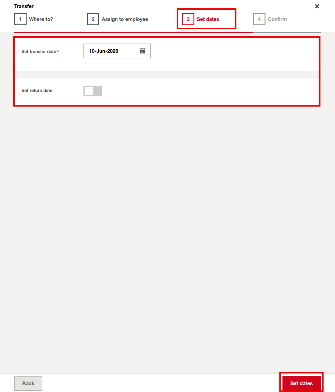

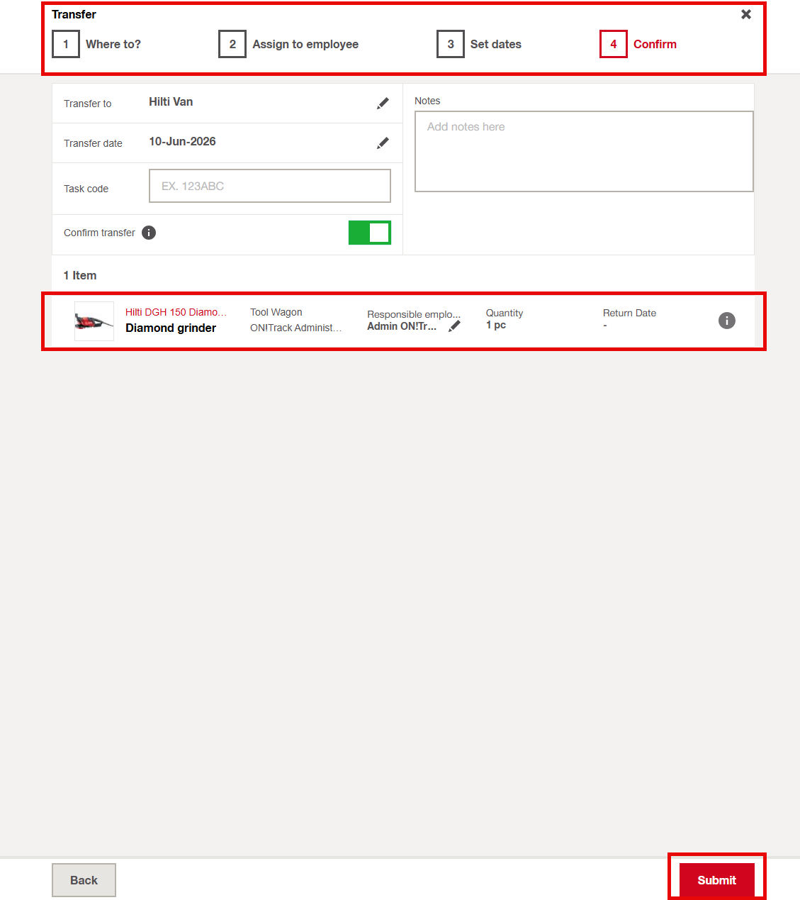

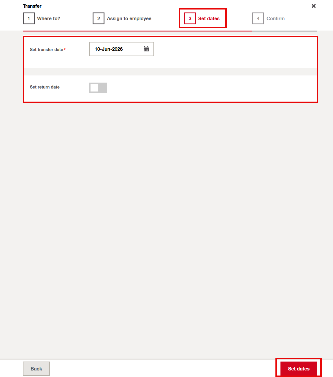

2) Transfer: This feature allows you to transfer multiple assets, especially to different job sites, containers, or workers. Compared to "Quick Transfer", you can also set a return date and add notes.

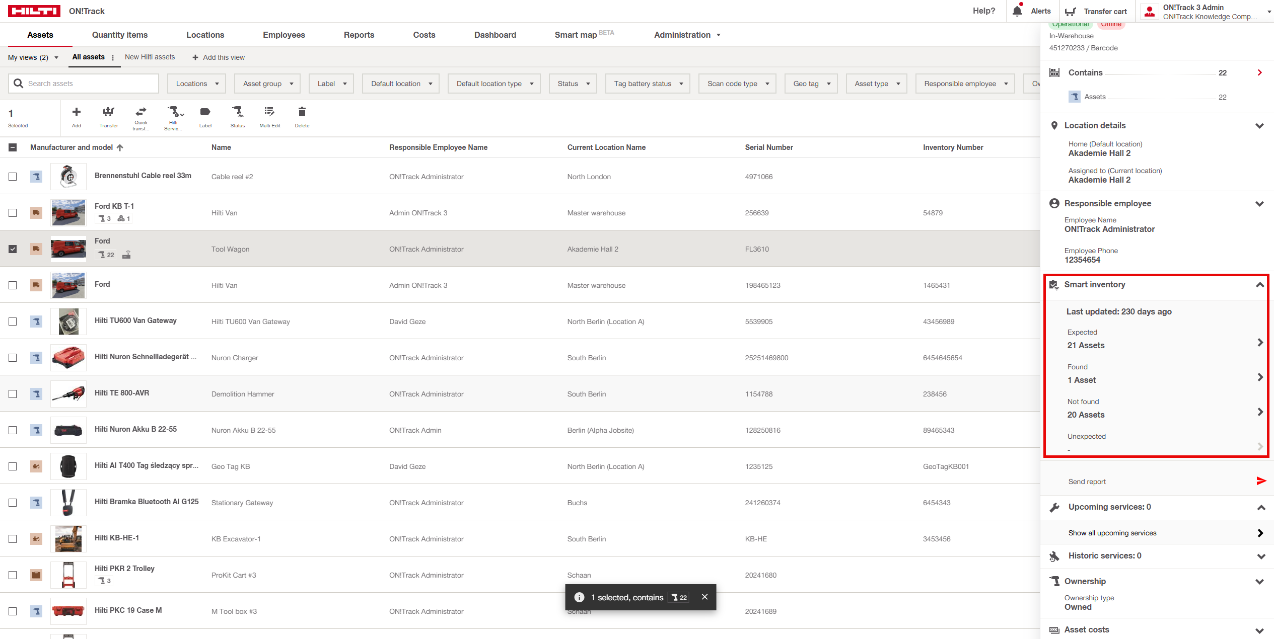

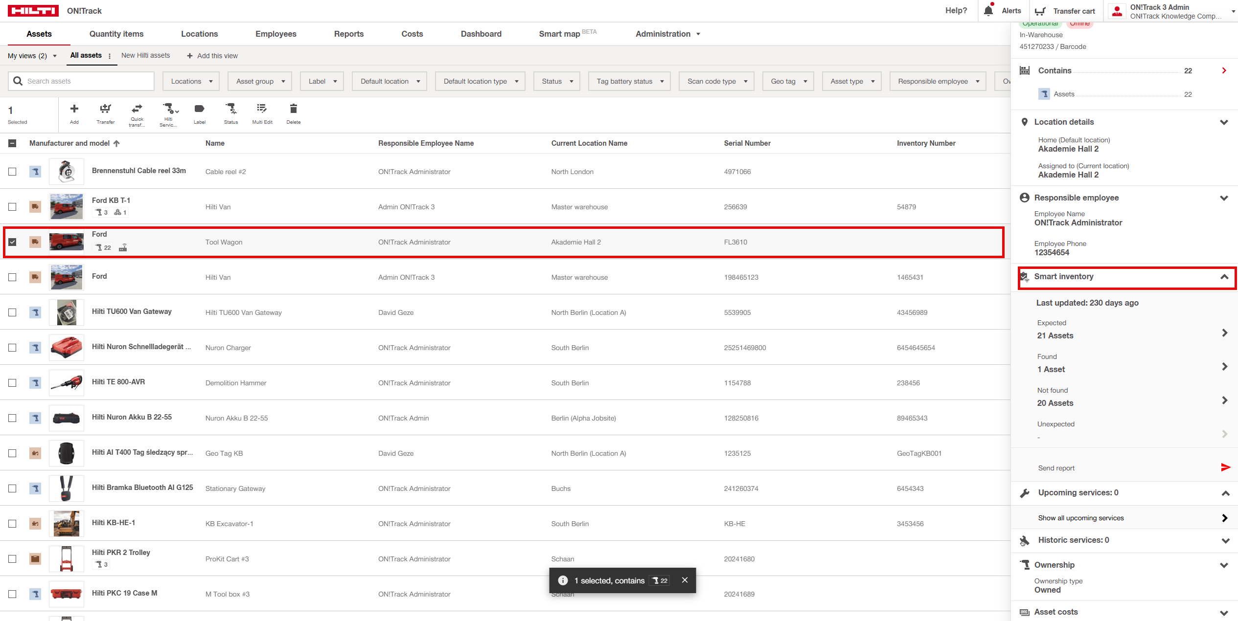

  • Open the gateway-enabled location or storage asset in ON!Track Web.
  • Open the Smart Inventory section.
    • Expected = assigned there and expected there
    • Found = physically detected there
    • Not found = expected there but not detected
    • Unexpected = detected there but assigned somewhere else

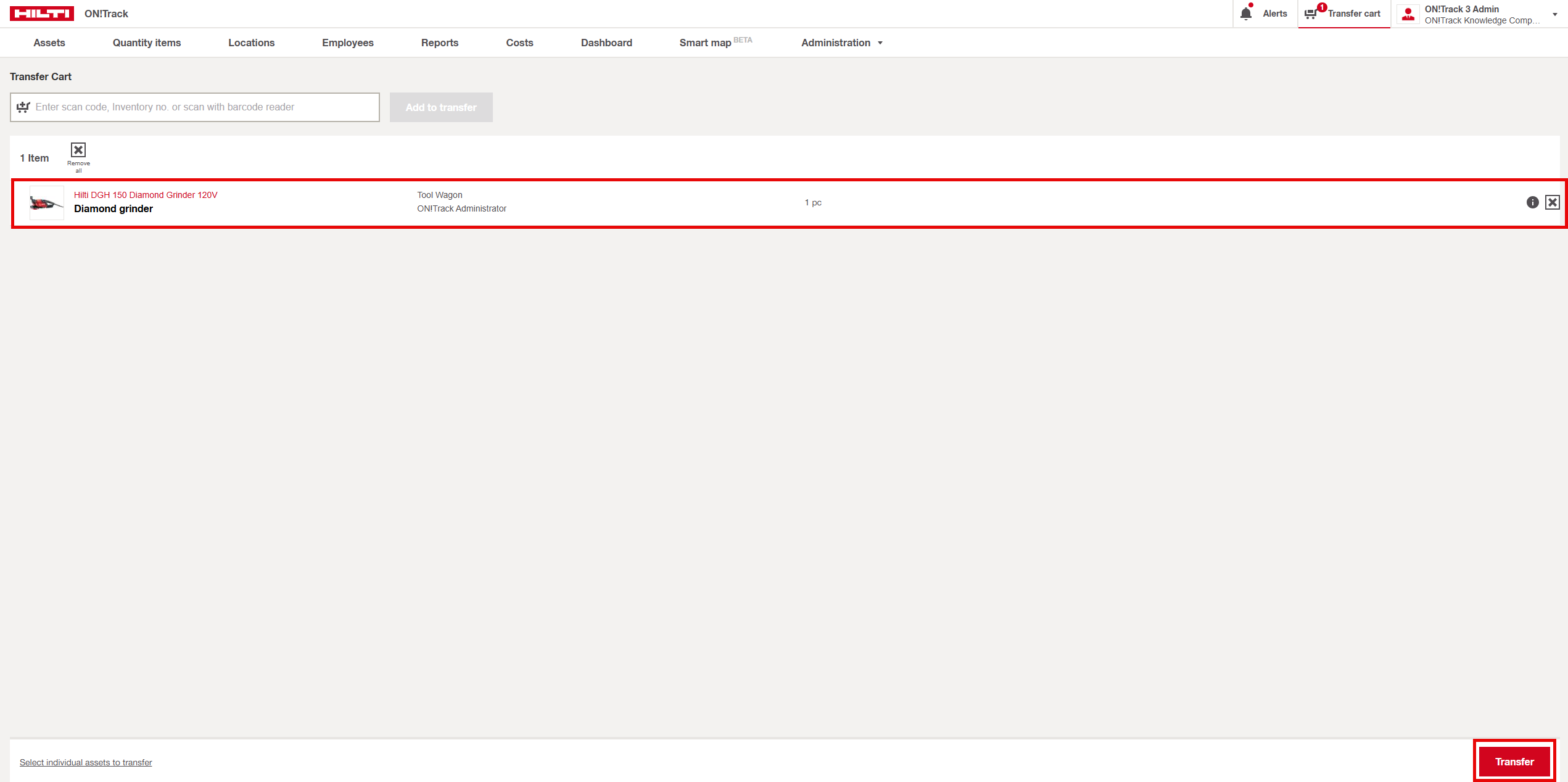

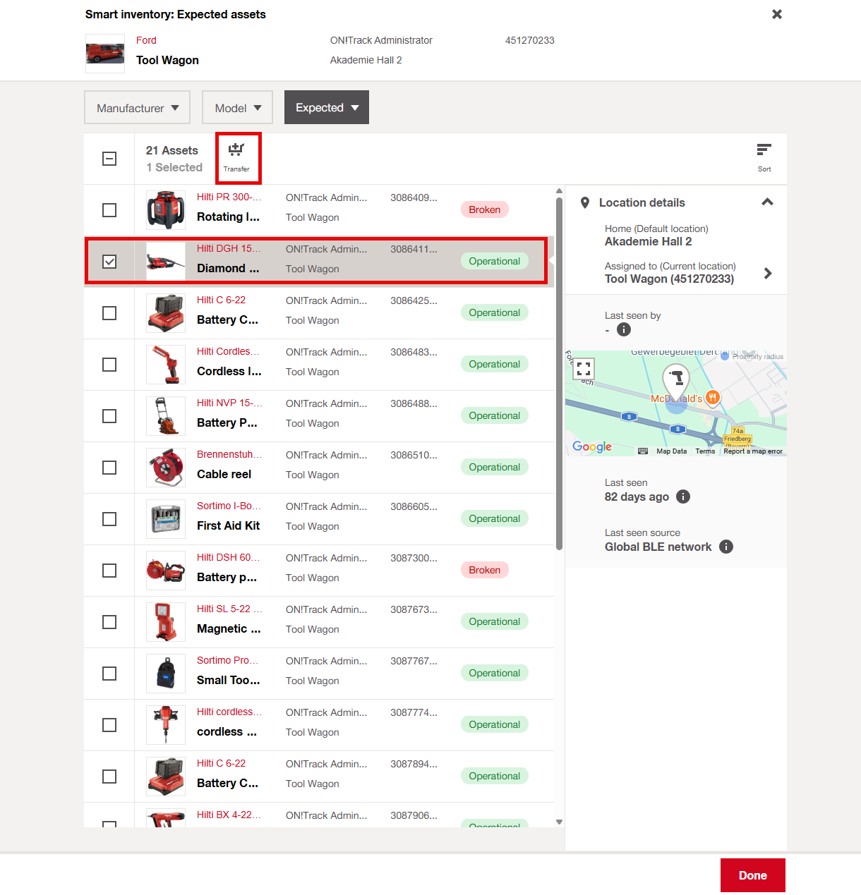

  • Open the relevant asset list and select the asset or assets you want to move.
  • Choose Transfer or Add to Transfer Cart.

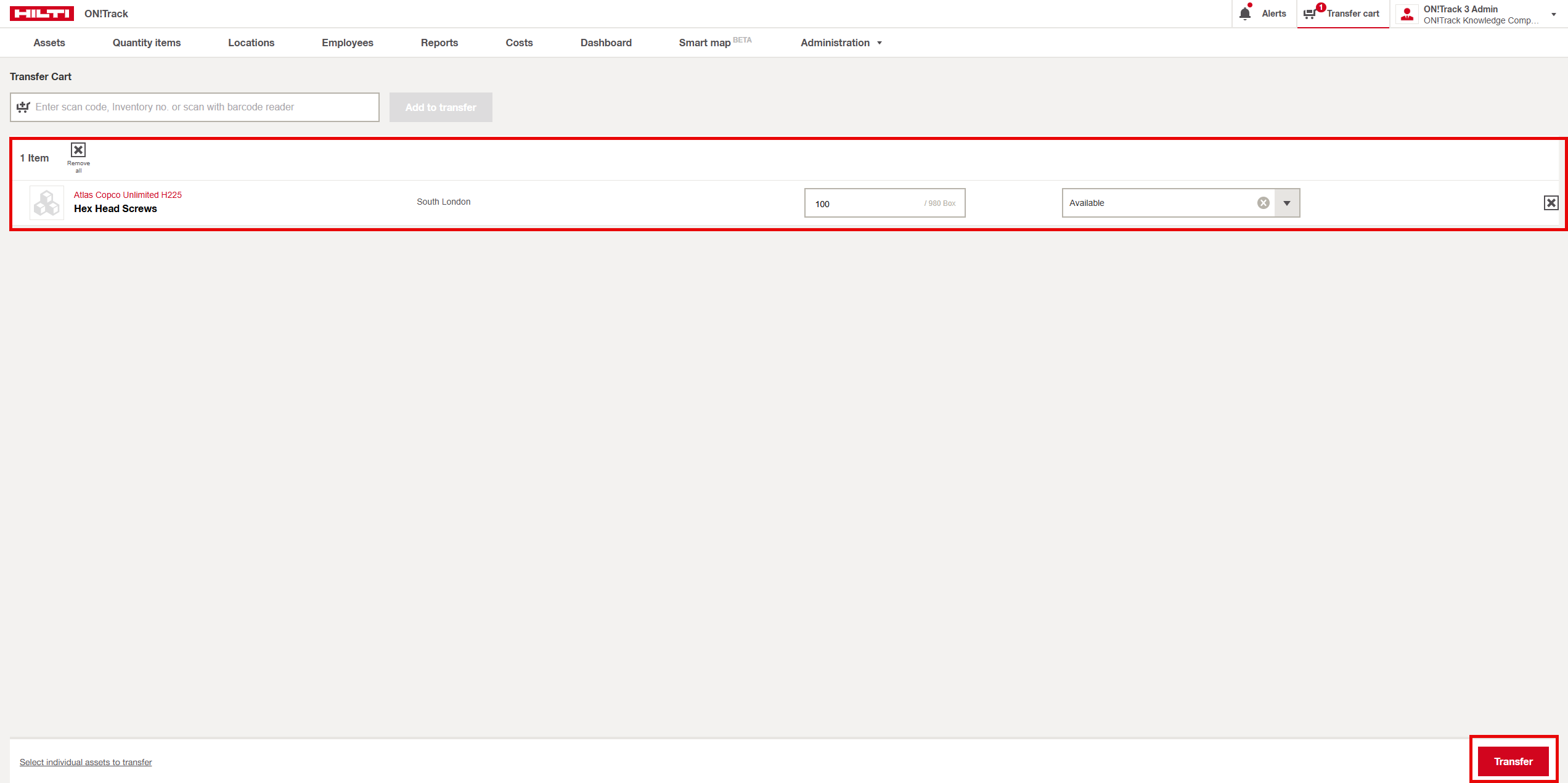

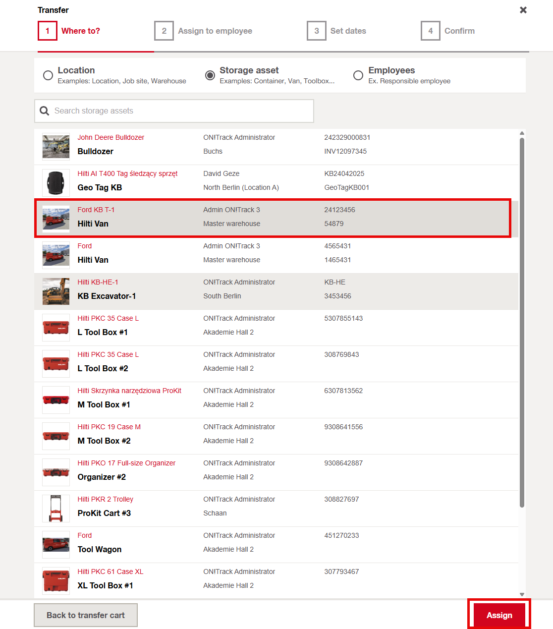

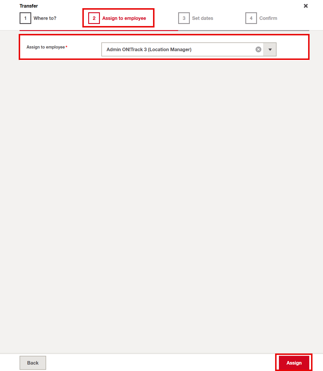

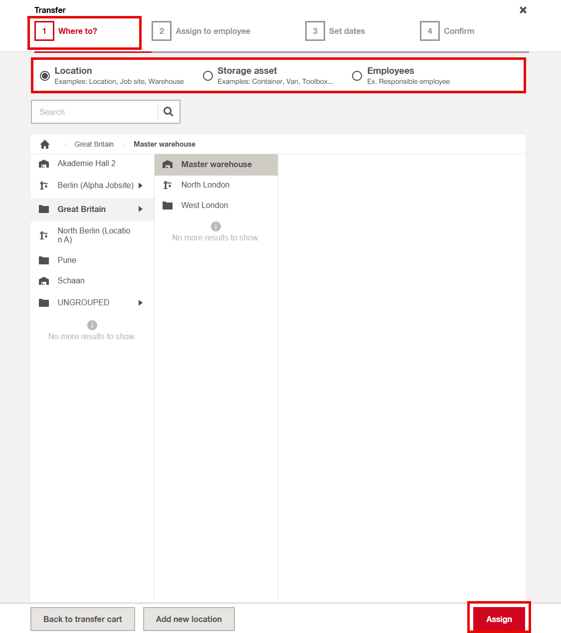

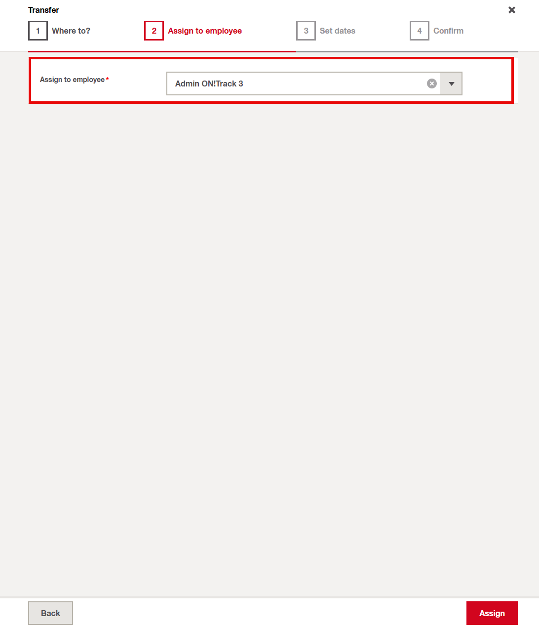

  • Open the Transfer Cart. Select a destination type: Location or Storage asset or Worker
  • Review the transfer details and submit the transfer.

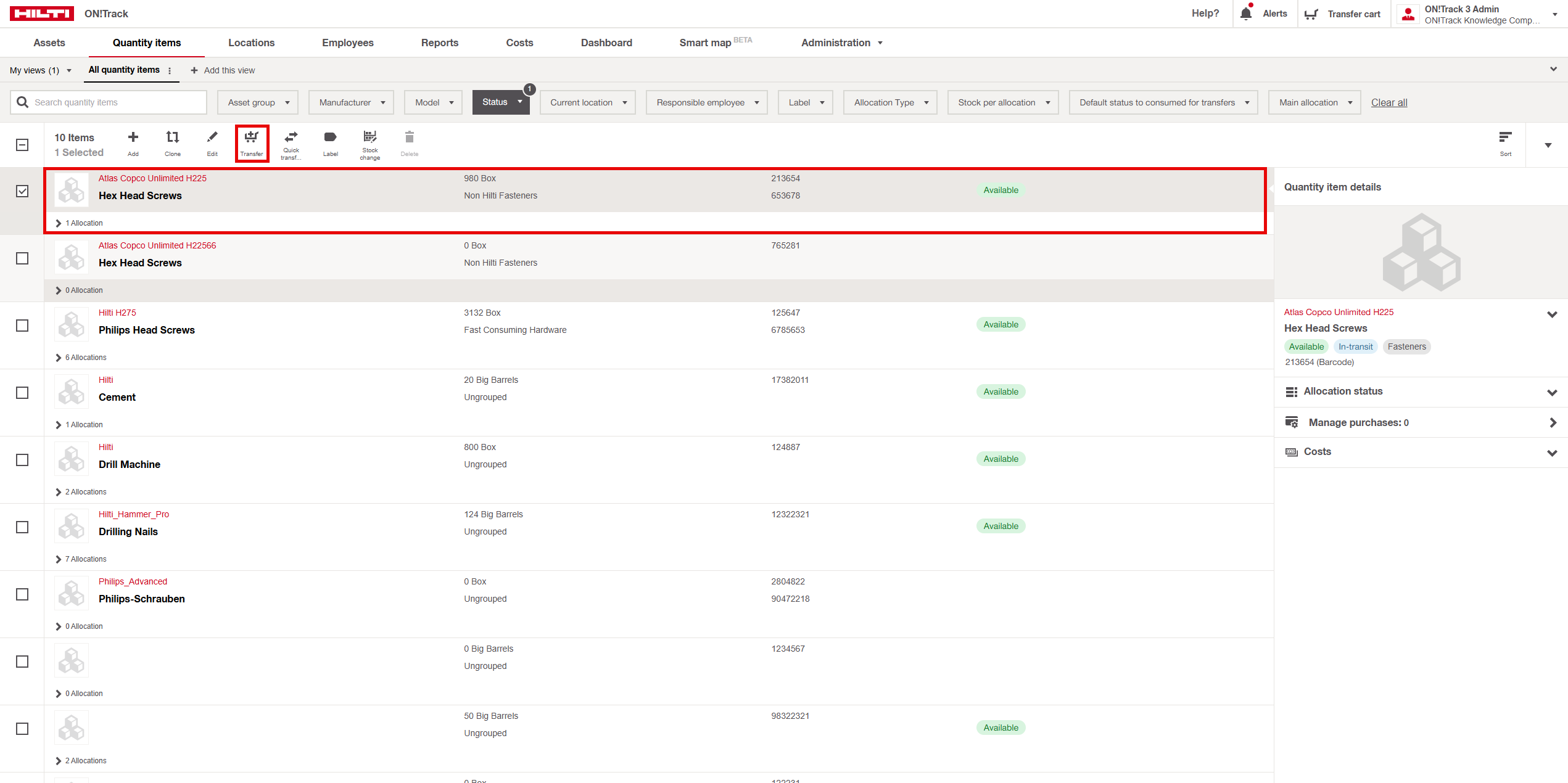

  • From the Quantity Item list view
  • From the Quantity Item allocation view
  • From a Storage Asset in the Assets list
  • From Location details (Web only)
  • From Worker details (Web only)

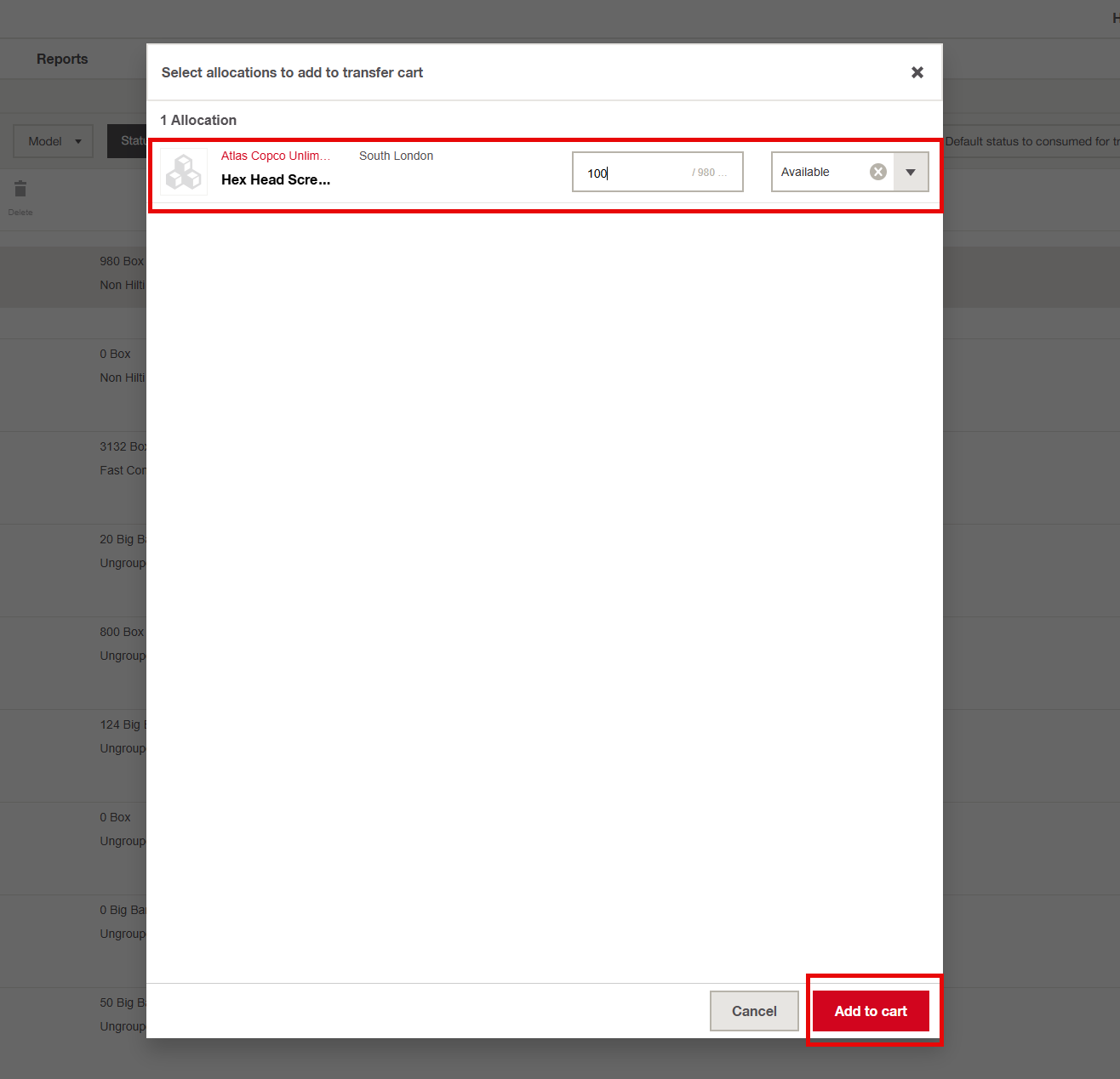

  • Open the quantity item or allocation you want to move.
  • Add the required quantity to the Transfer Card.
  • Choose the destination: Location or Storage Asset or Worker.
  • Set the item status:
    • Available
    • Reserved
    • Consumed
    • In repair
    • Lost or stolen
    • Disposed

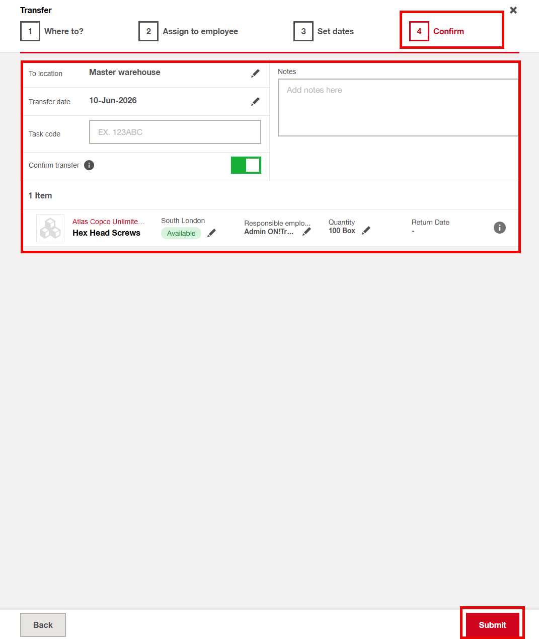

  • Review the transfer and confirm it.
