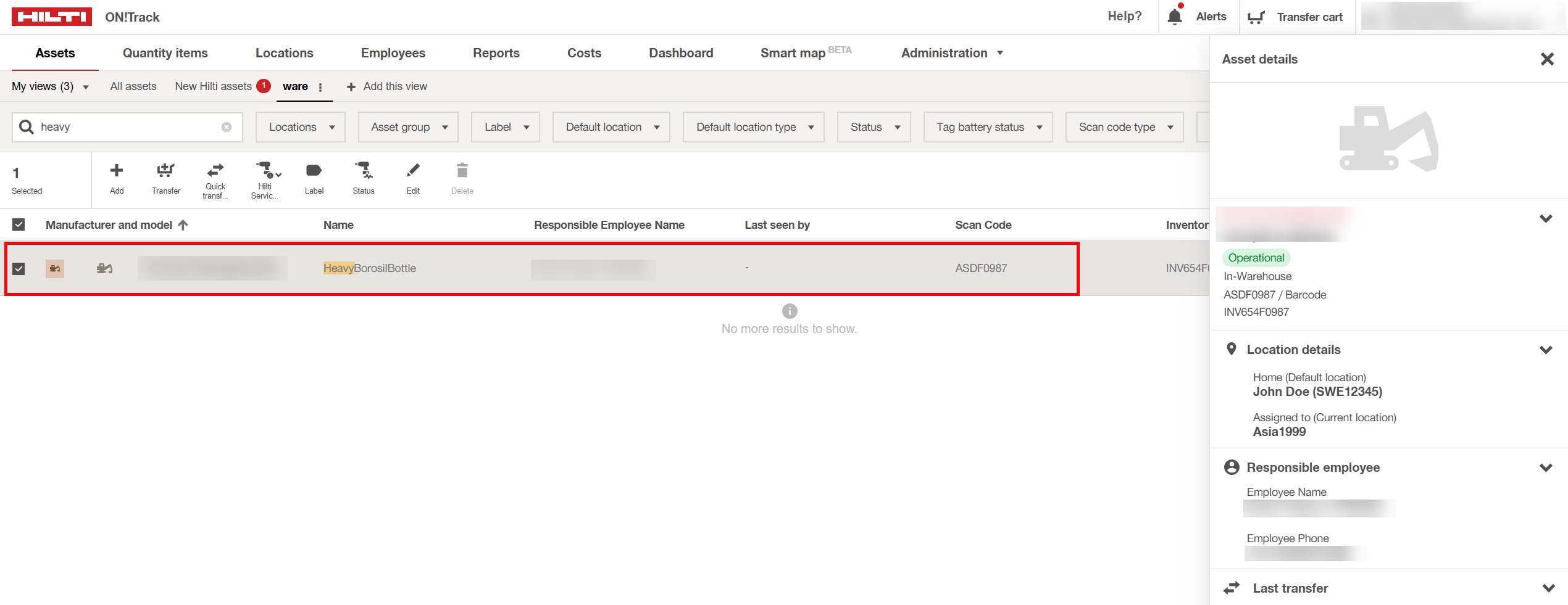

Go to the "Asset" and search for the required asset.

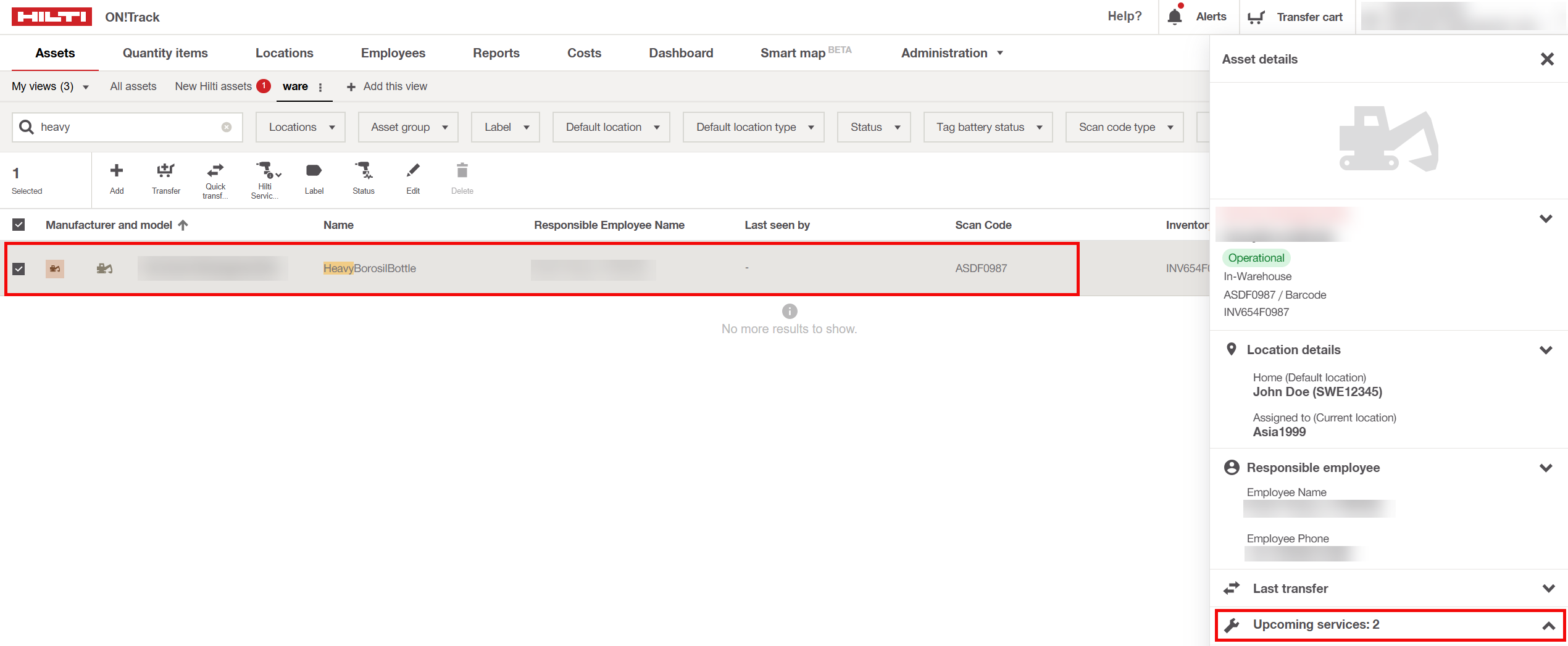

Scroll down to the Asset Details section and open the Upcoming Services.
For Recurrent Services
To view services, select the one you need. Its details will appear on the right side. Click "Complete" to start the completion process for the service.
Make sure the filter is set to "Upcoming Services" to see only the services that can be completed.
