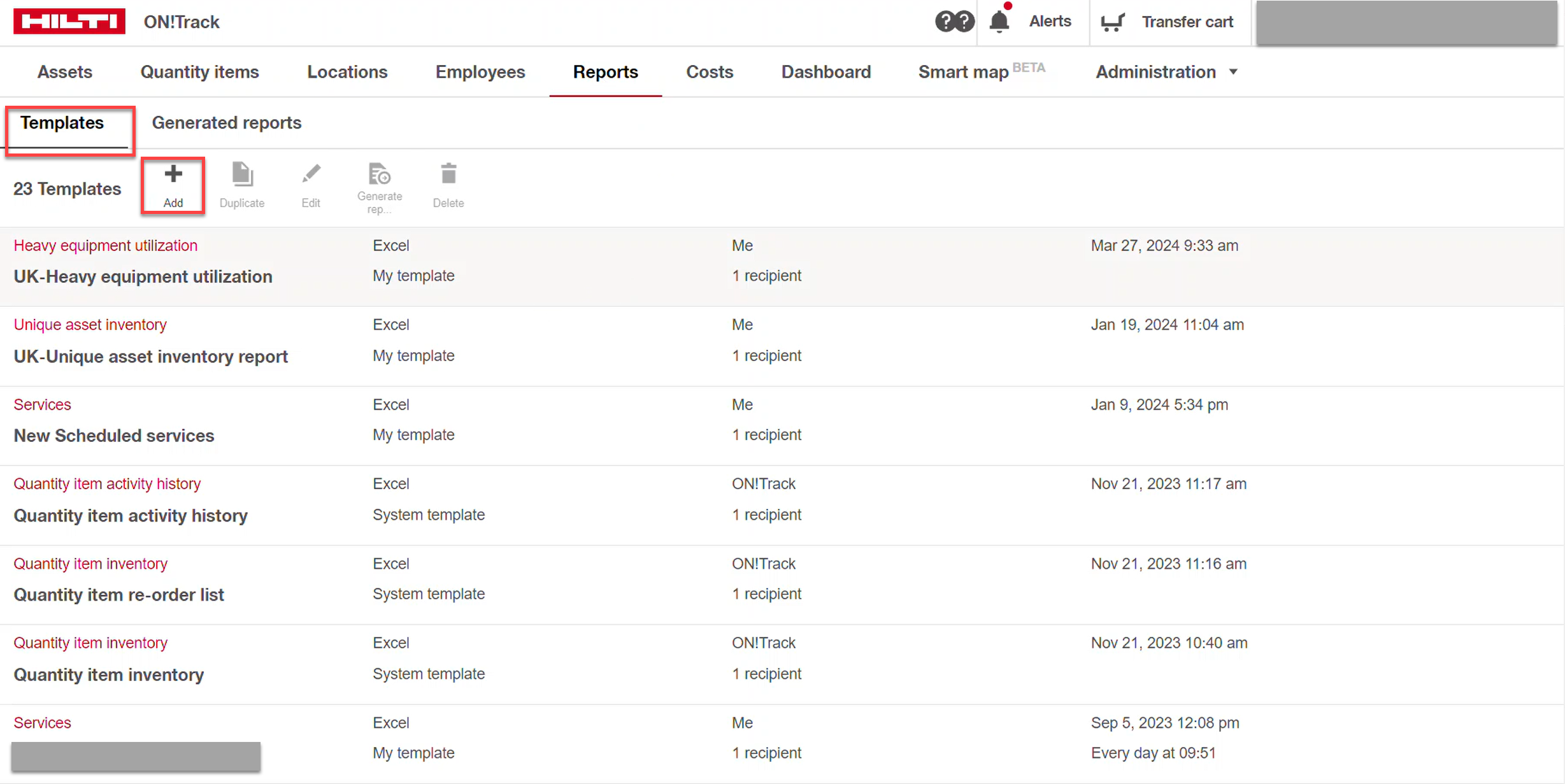

  • Click on the "Reports" from the ON!Track web dashboard.
  • To add or create a report template, click the "+" sign in the Templates tab.

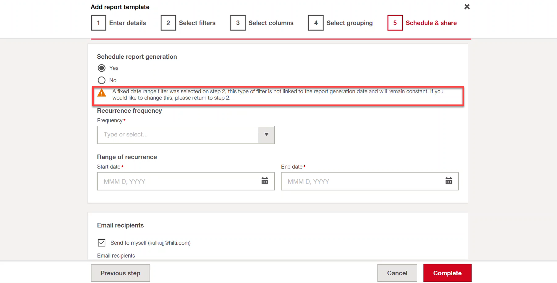

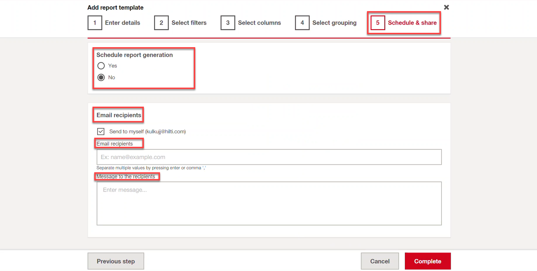

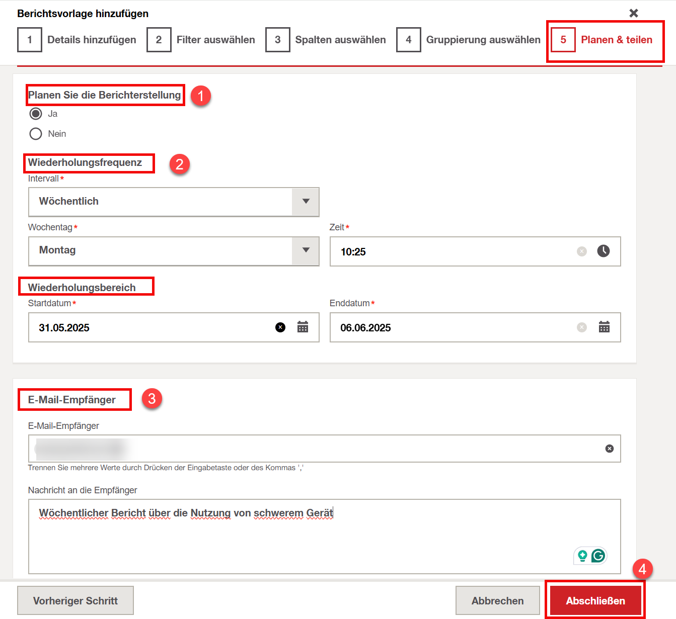

  • In the next tab, "Schedule & share", You can schedule the report generation, choose email recipients, and include any message for them.
  • If you select a fixed date range, the filter will not be tied to the report generation date and will remain constant. To modify it, return to step 2 and make the necessary changes.
  • To schedule and share the report, select "Yes" for scheduling report generation, specify the recurrence frequency, add email recipients, include a message for them, and then click "Complete."

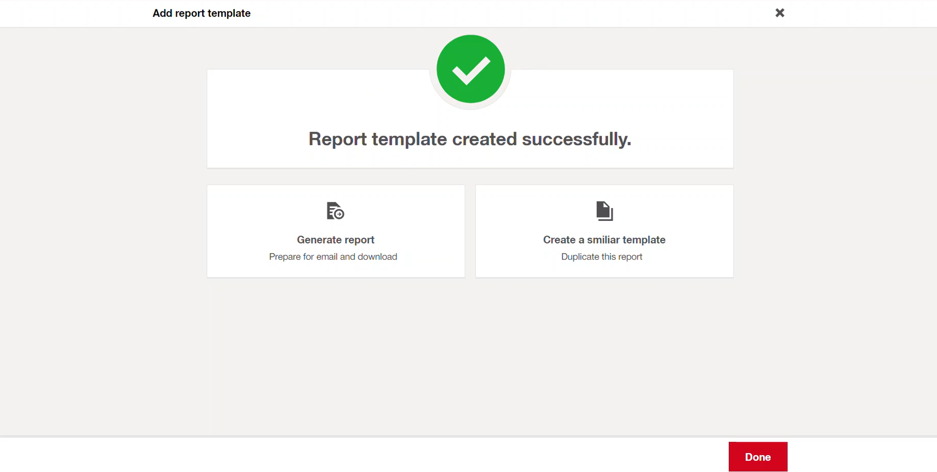

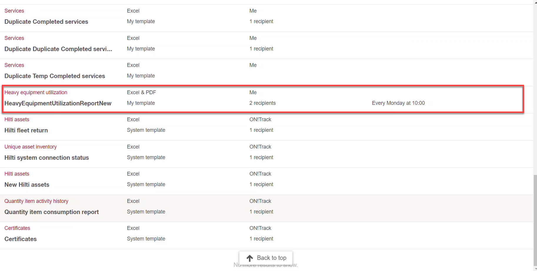

  • The report template has been created and can now be viewed in the template list.
