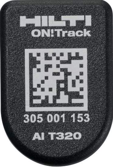

What are Sensor tags?
Sensor tags are small, durable devices that send out a signal every 8 seconds once activated. The ON!Track app on your phone, along with Warehouse Gateways, Vehicle Gateways, Telematics Gateways, and the global Trackunit network, can capture this Bluetooth signal. When the tags are scanned, the tag number and location information are sent to the Hilti IOT cloud, which processes the data and displays it in ON!Track. This lets you see when and where an asset was last seen and by which device. You can also perform a nearby scan to find assets with Sensor tags nearby.
Sensor tags also have an accelerometer, which logs tool usage and stores this data until read by a Gateway or mobile app. This usage information is shown as "Idle" time in ON!Track, helps you see when a tool was last used. More details on this will be covered in the next learning module.

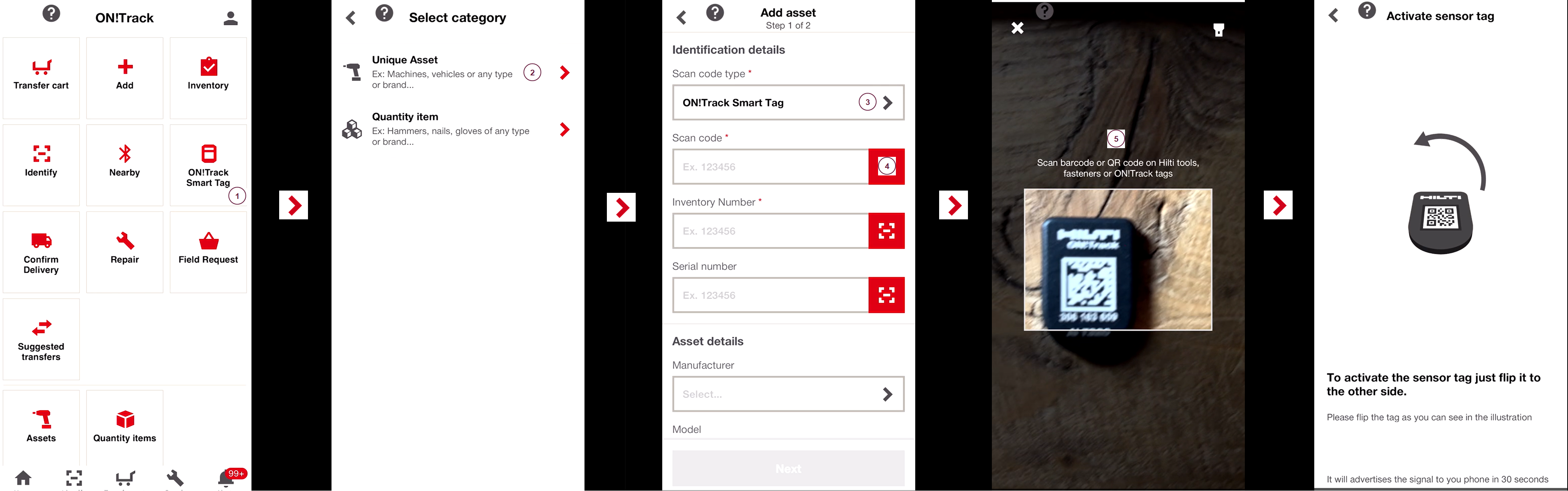

Adding a Sensor tag to an asset
To add a Sensor tag to an asset, whether new or existing, follow these steps:
  1. Wake up the Sensor tag using the mobile app. Onboarding new tags can only be done this way. The example below uses the iOS app, but the process is similar for Android.
  2. For an existing asset, find the asset, enter edit mode, and add the tag.
  3. For a new asset, click "+", select "Unique Asset", and change the scan code type to "ON!Track Smart Tag" on the barcode scan screen. Follow the prompts to scan the QR code on the tag.
  4. Flip the tag over and keep your phone close to it. This activates the accelerometer inside the tag and turns it on permanently. From now on, it will send out a Bluetooth signal every 8 seconds until the battery runs out.
