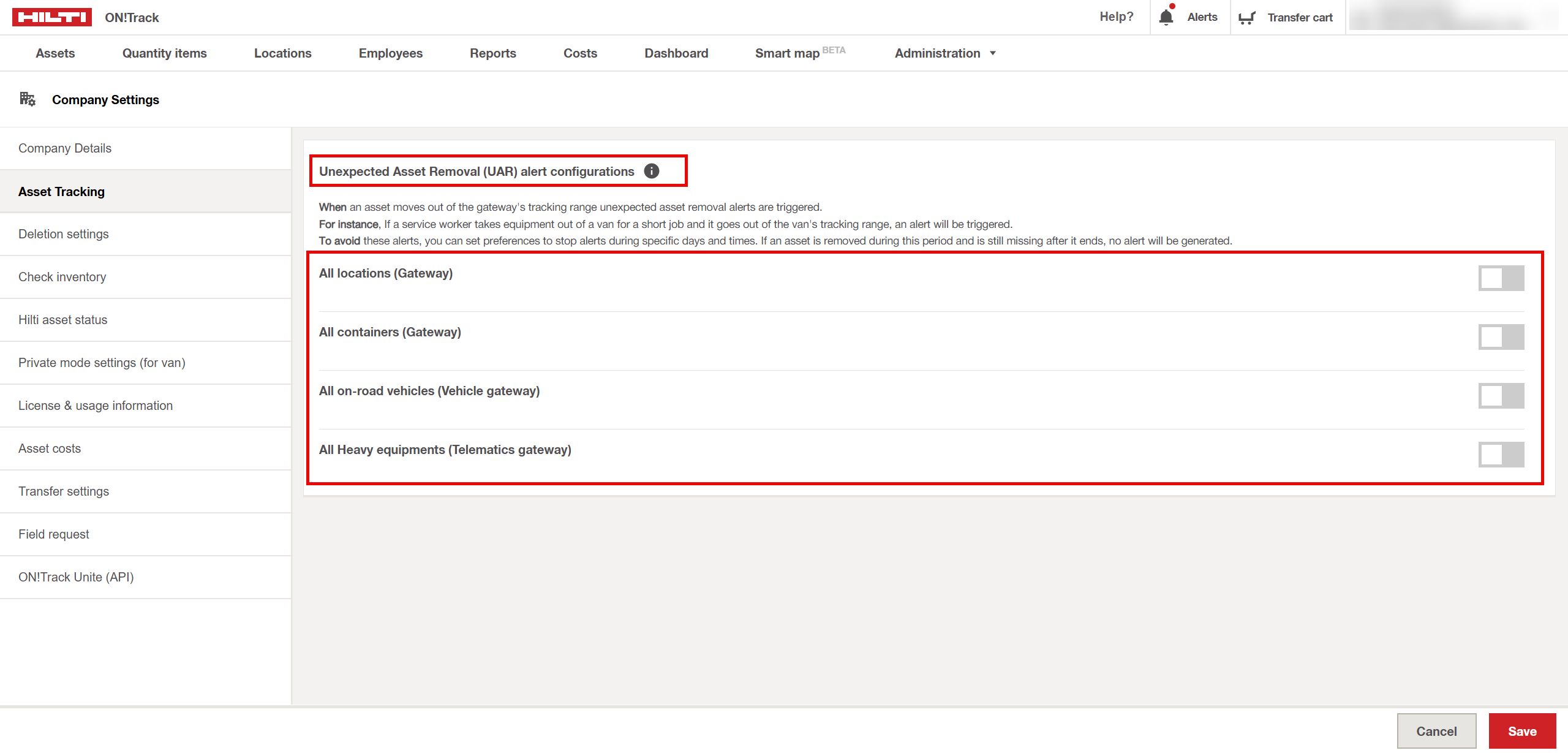

The feature is accessible under Company Settings > Asset Tracking
Step-by-step guide to set up the feature:

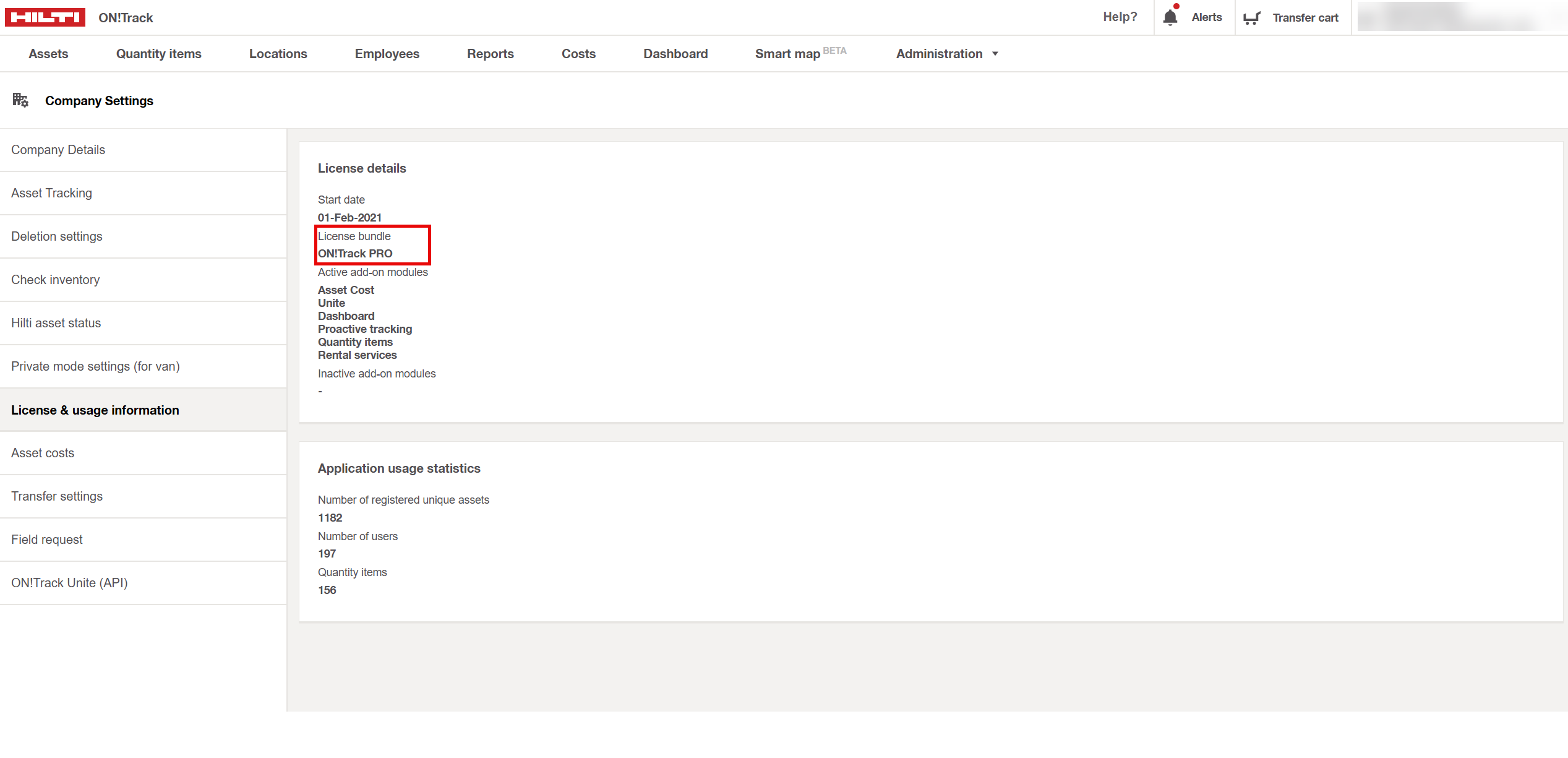

  • Check the license type for your account (Pro, Enterprise, and Legacy licenses).
  • Go to Company Settings and open Asset Tracking. In the Unexpected Asset Removal (UAR) Alert Configuration section.
  • Click Edit next to the group you want to update, (like All Locations, All Containers, All On-Road Vehicles, or All Heavy Equipment).

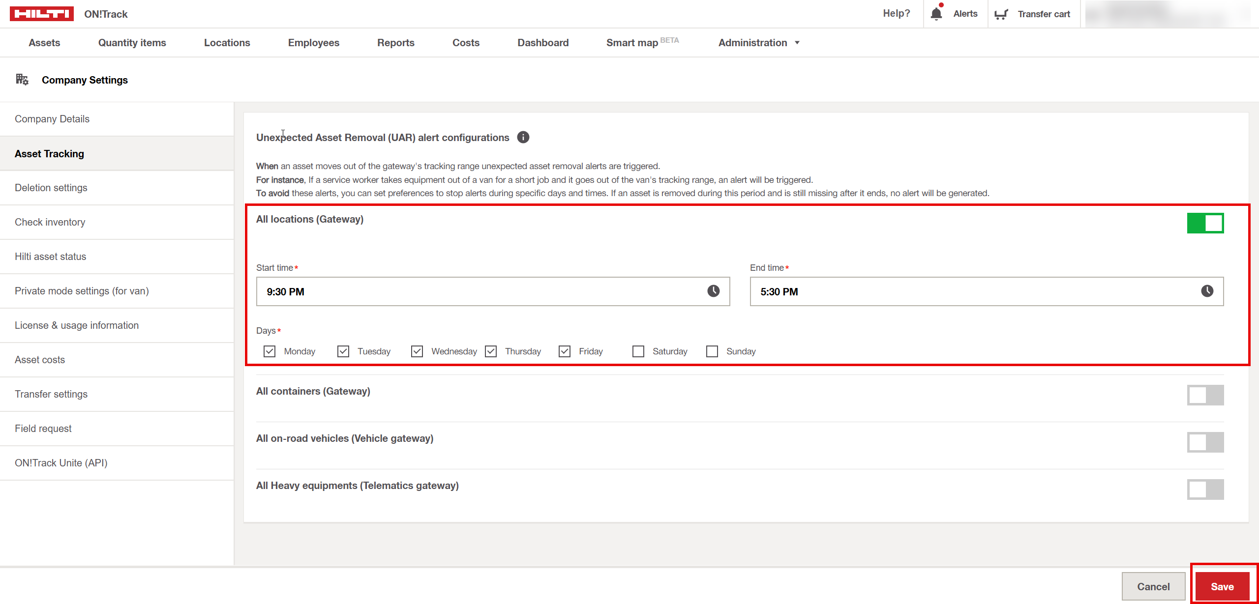

  • Select the days and time range when alerts should be paused.
  • Update required attribute/s and click on save to save the setting.
