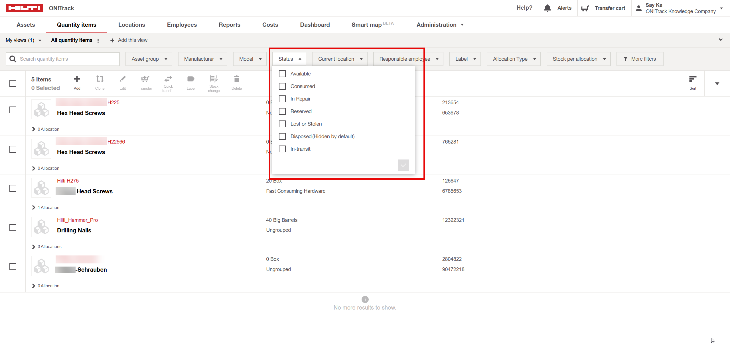

For Web:

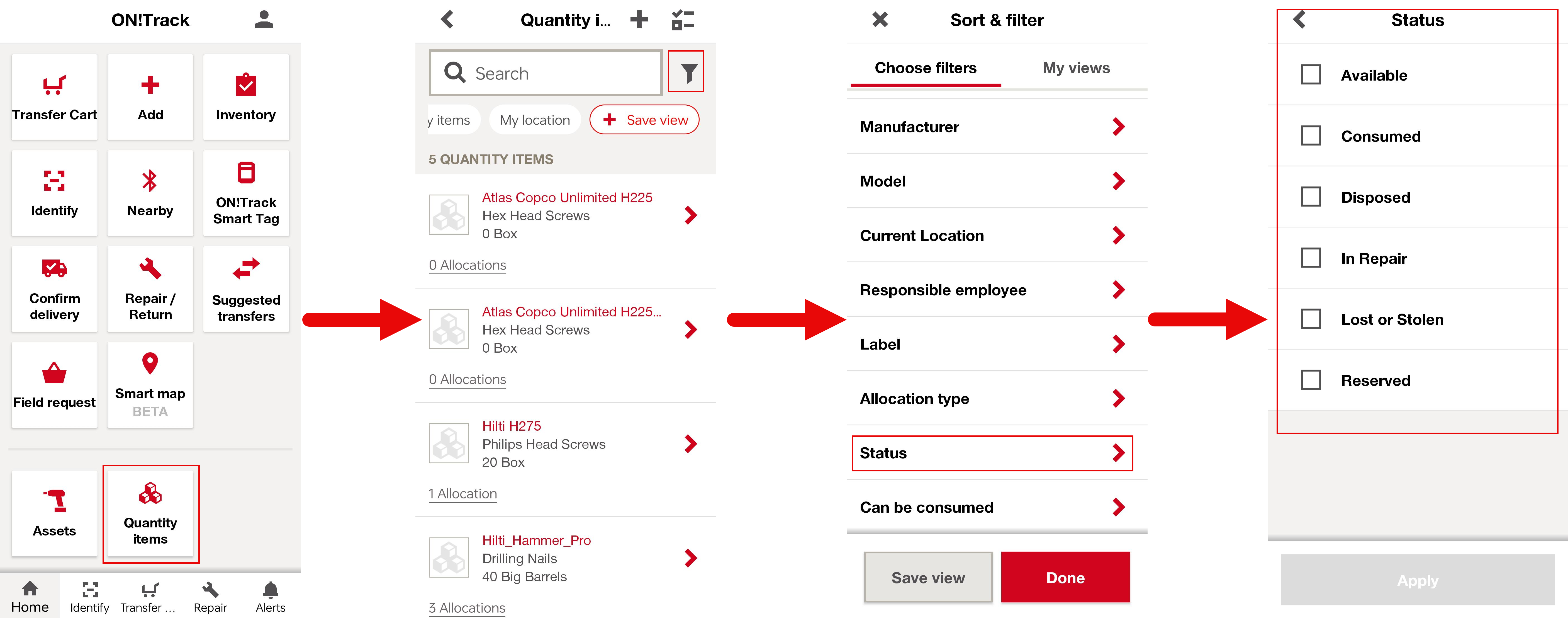

For Mobile - Application
To help you manage these items, ON!Track uses statuses to show what’s happening with them. Here’s what each status means, with easy examples:
  • Available:
    • These quantity items are ready to be used or sent to a jobsite.
    • USe Case Boxes of nails stored in the warehouse, ready to be dispatched.
  • Consumed:
    • These quantity items have been used up.
    • Use Case: Bags of cement used during construction are marked as consumed.
  • Reserved:
    • These quantity items are saved for a specific job or person, but haven’t been used yet.
    • Use Case: Buckets of paint set aside for a project next week project.
  • In Repair:
    • These quantity items are damaged and being fixed.
    • Use Case: A tool or equipment sent for repair and not available right now.
  • Lost or Stolen:
    • These quantity items are missing or reported stolen.
    • Use Case: A box of screws that couldn’t be found during stock check.
  • Disposed:
    • These items are no longer usable and have been thrown away or removed from inventory.
    • Use Case: Old or expired buckets of paint that were discarded.
  • In Transit (Web-only):
    • These items are being moved from one place to another.
    • Use Case: Bags of cement being transferred from one jobsite to another.
