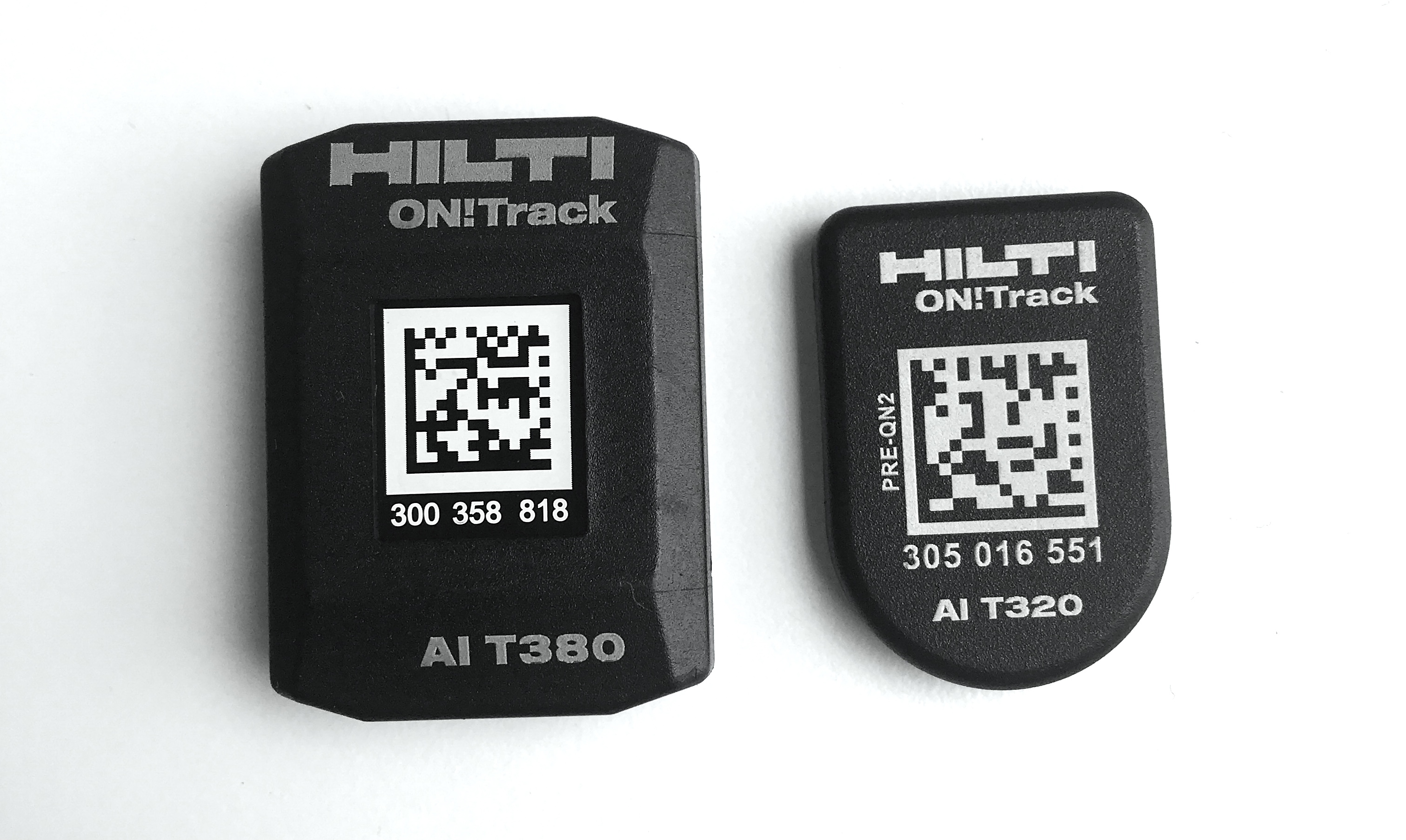

  • Compact form factor — smaller and lighter than older Smart Tags (AI T380), making them easier to attach
