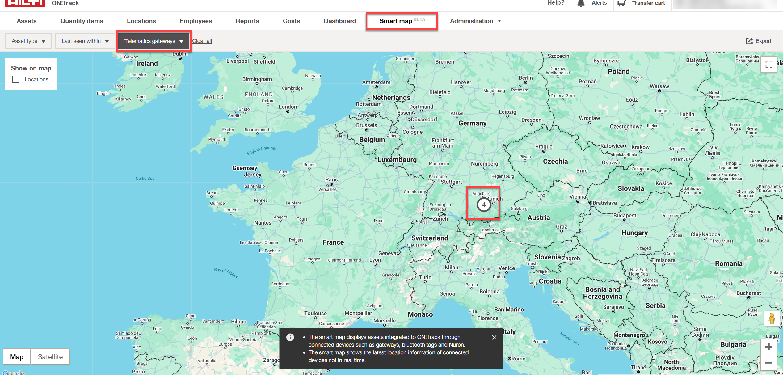

On Web Platform:

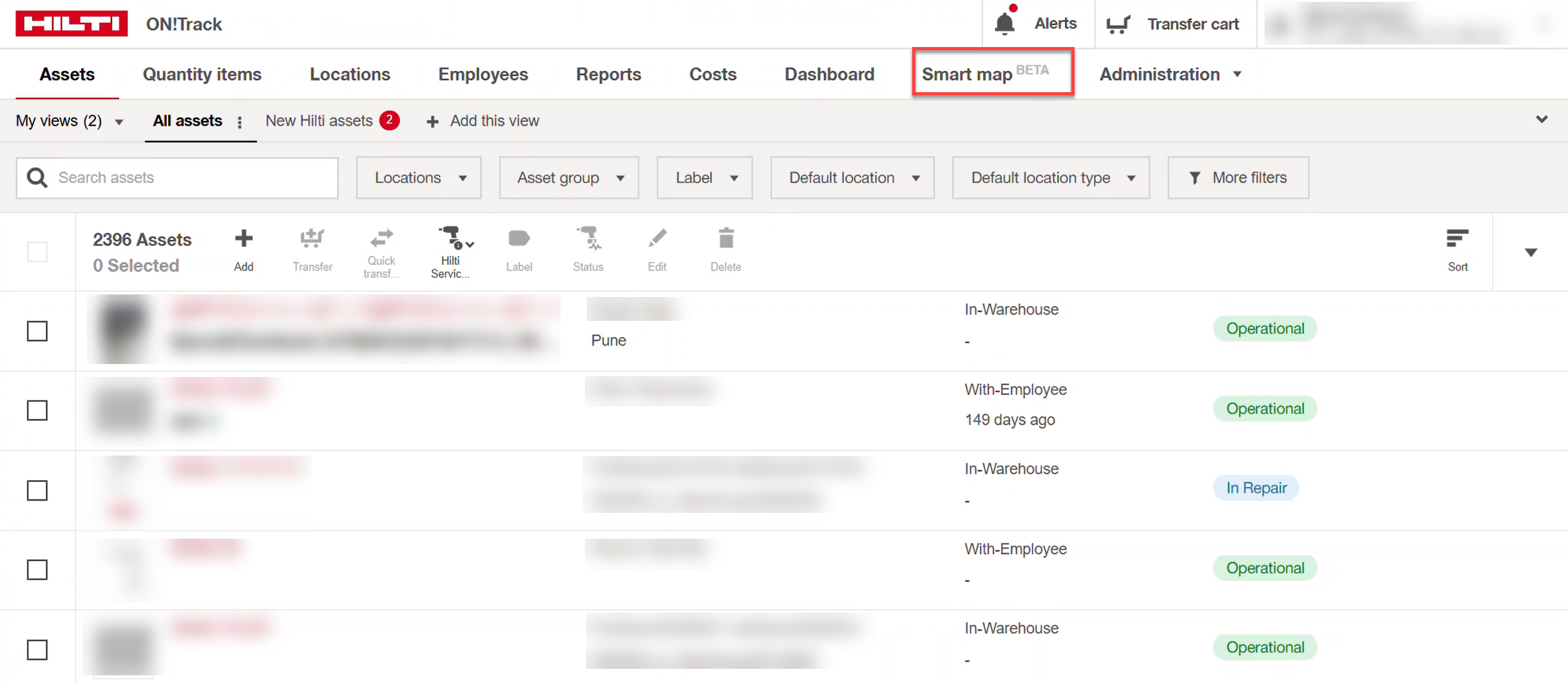

- Select the Smart Map tab on the screen.

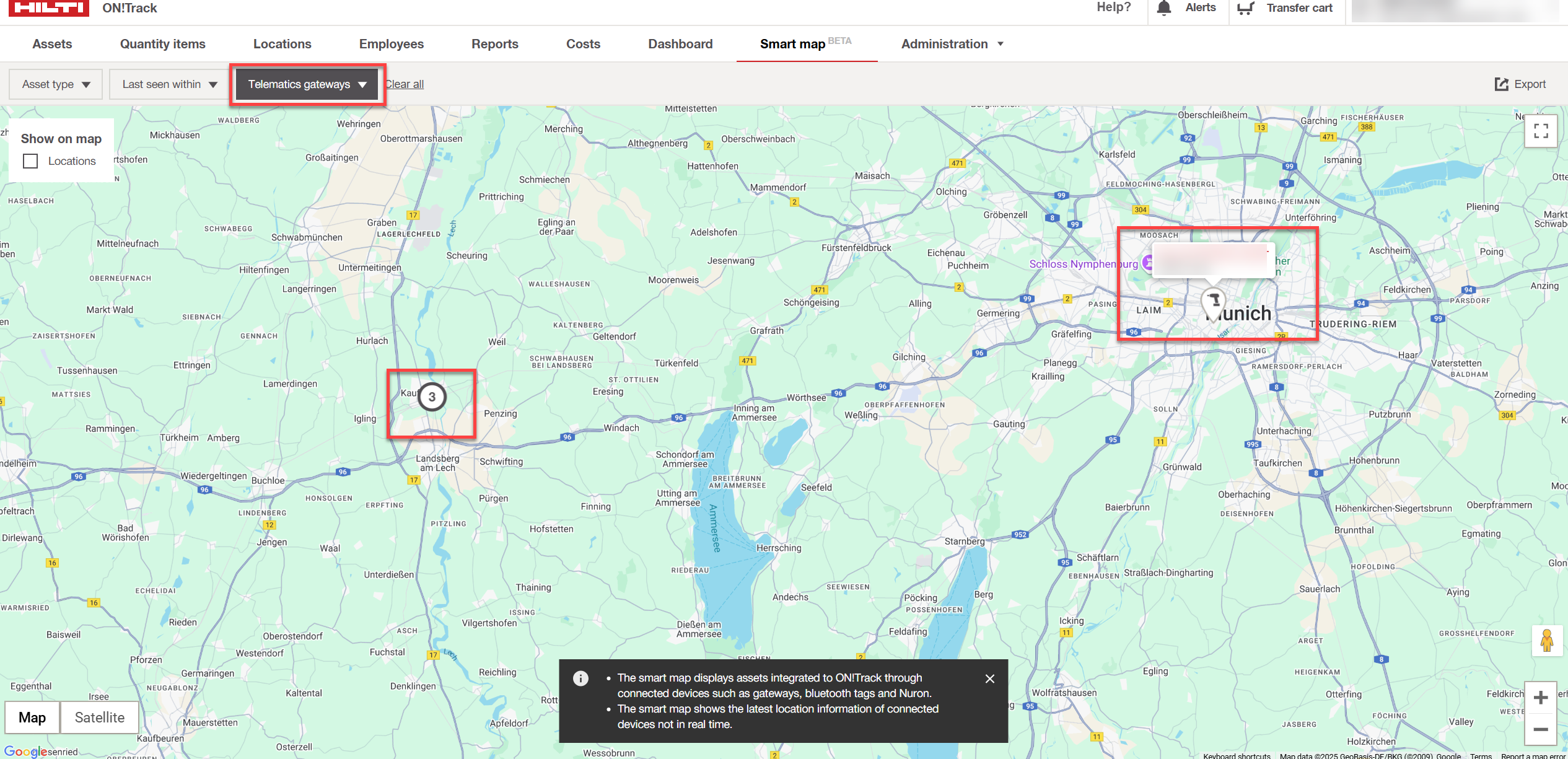

- Choose the last seen source and zoom in to find the desired location on the map.
- Select the desired asset to view its details.

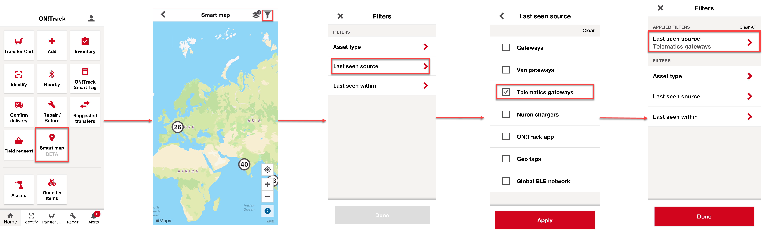

On Mobile Application:
- Open Smart Maps, click on the filter option, select the last seen source filters, choose Nuron Chargers (for this article), click Apply, and then select Done.
- After applying the filter, zoom in, select the desired tool, and view its details.
