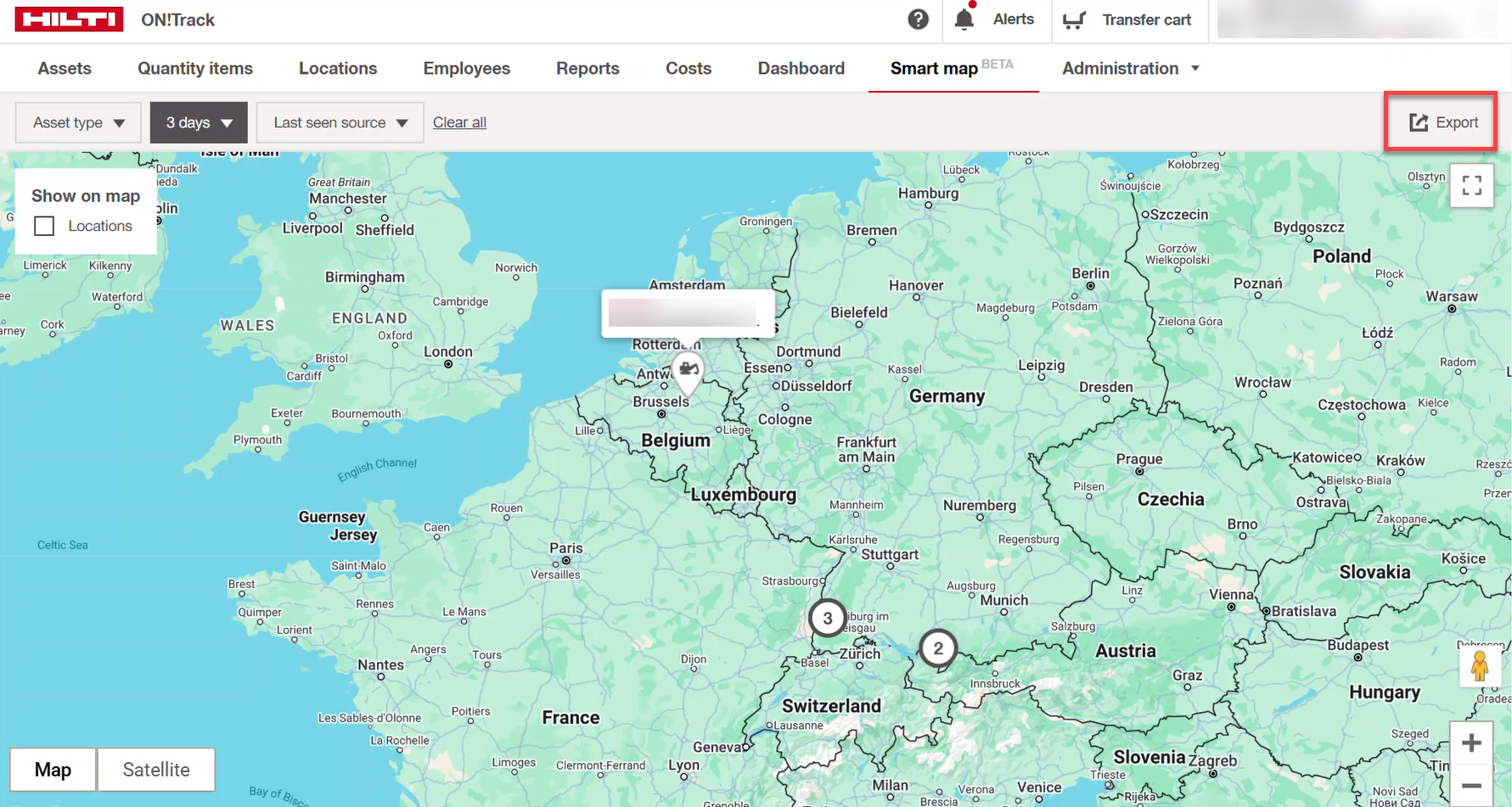

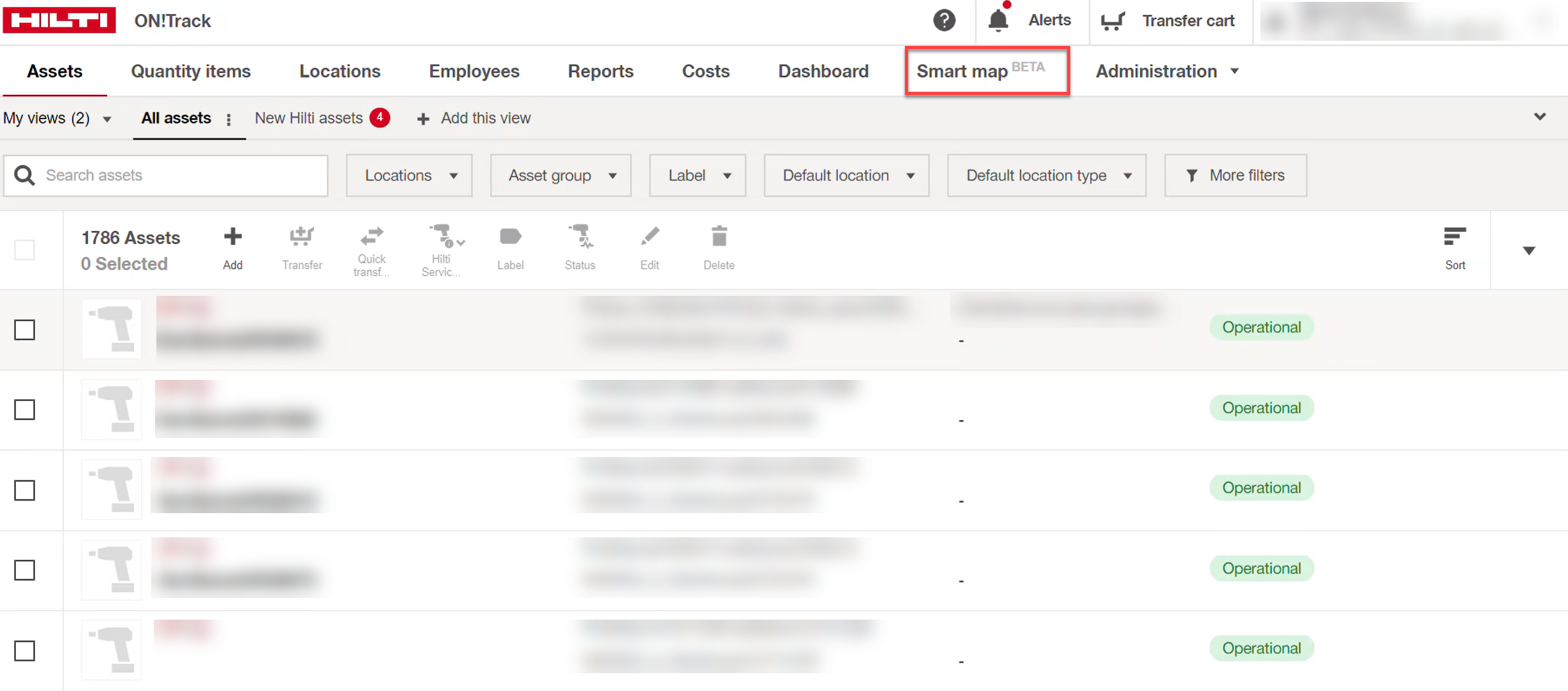

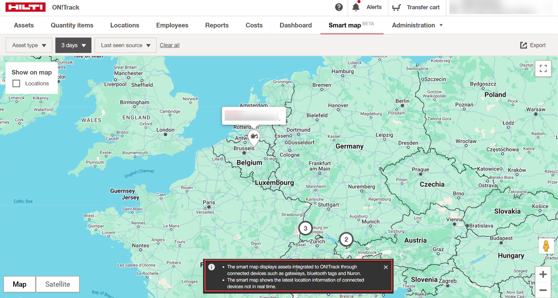

  • Navigate to the Smart Map tab in ON!Track.
  • Locate the Export icon in the top right corner.
  • Click the Export icon to generate an Excel file.
Instructions:
  • Select the Smart Map tab on the screen.
  • To export the smart asset list from the Smart Map, click on the "Export" icon. The system will generate and download an Excel file containing the asset details.

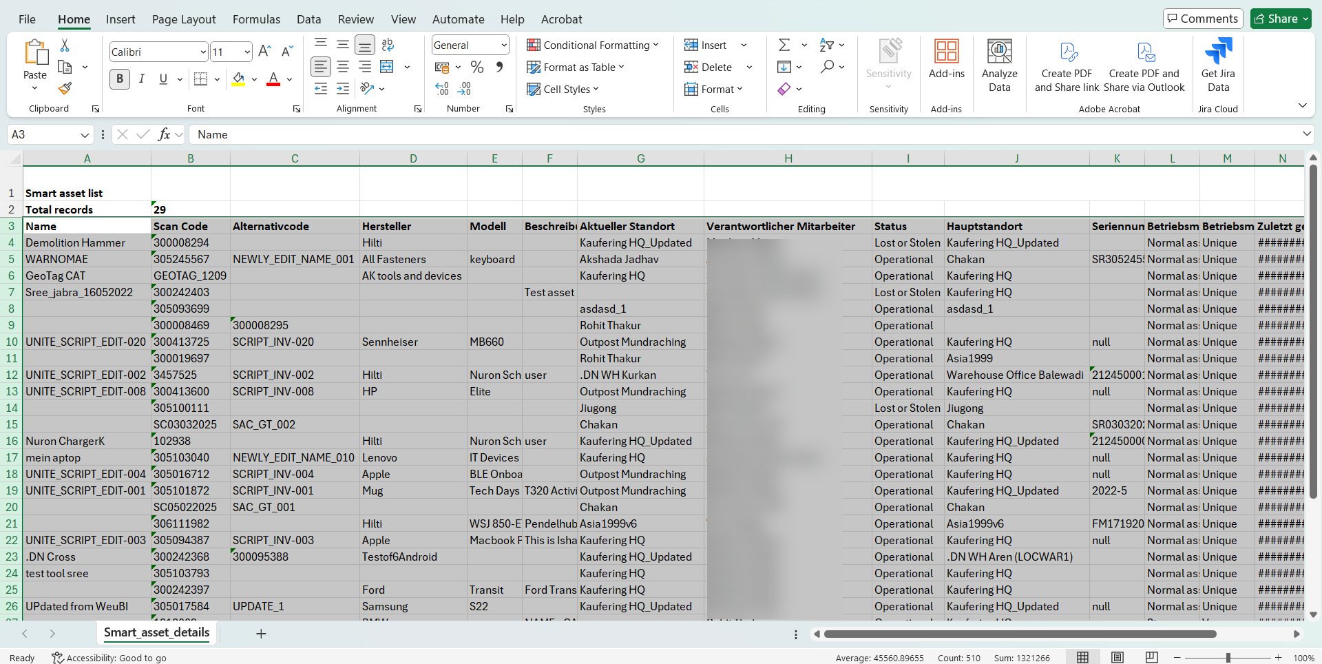

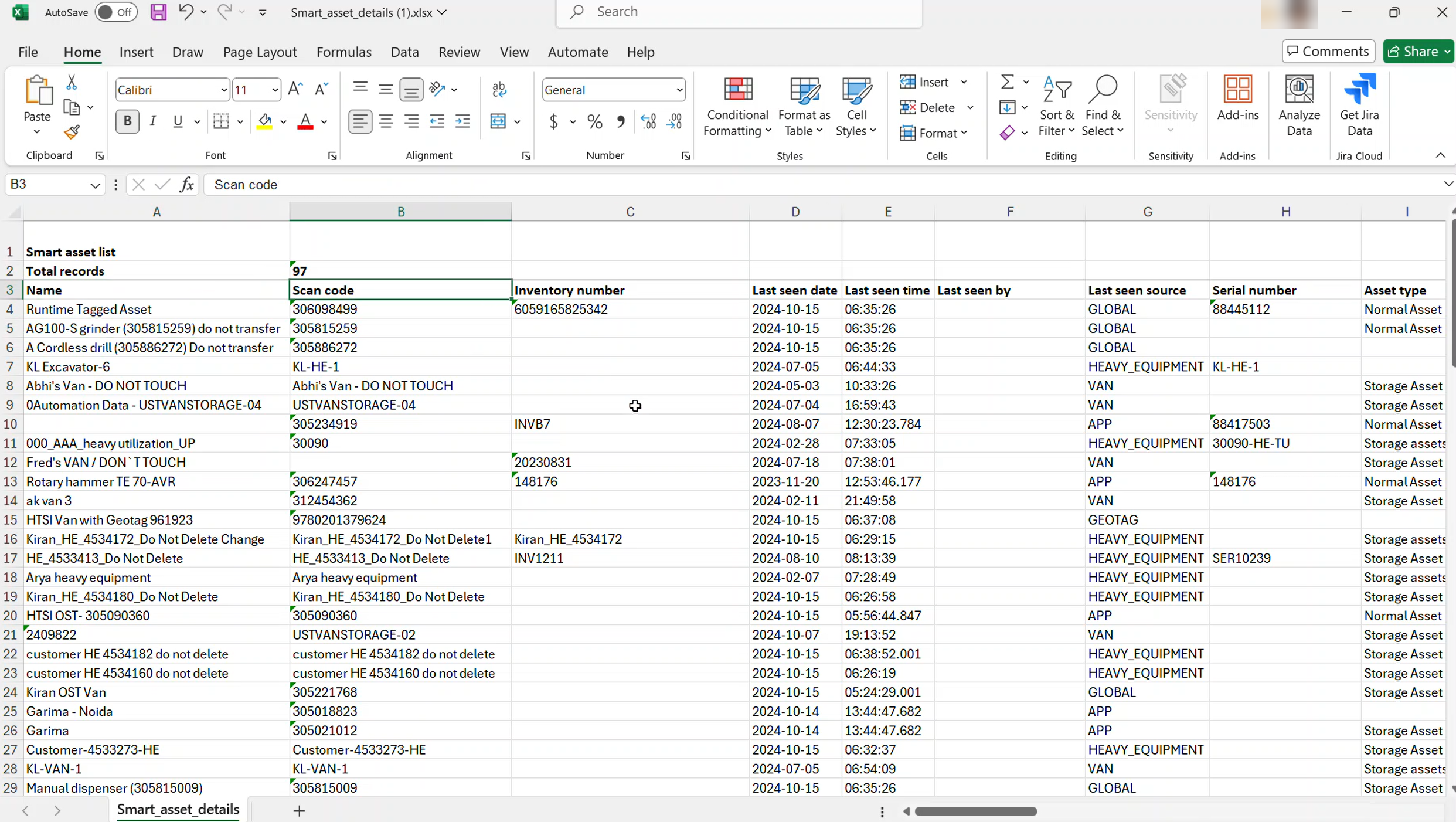

  • Here, you can view all asset attributes in the Smart Asset List, including Name, Scan Code, Inventory Number, Serial Number, and more.

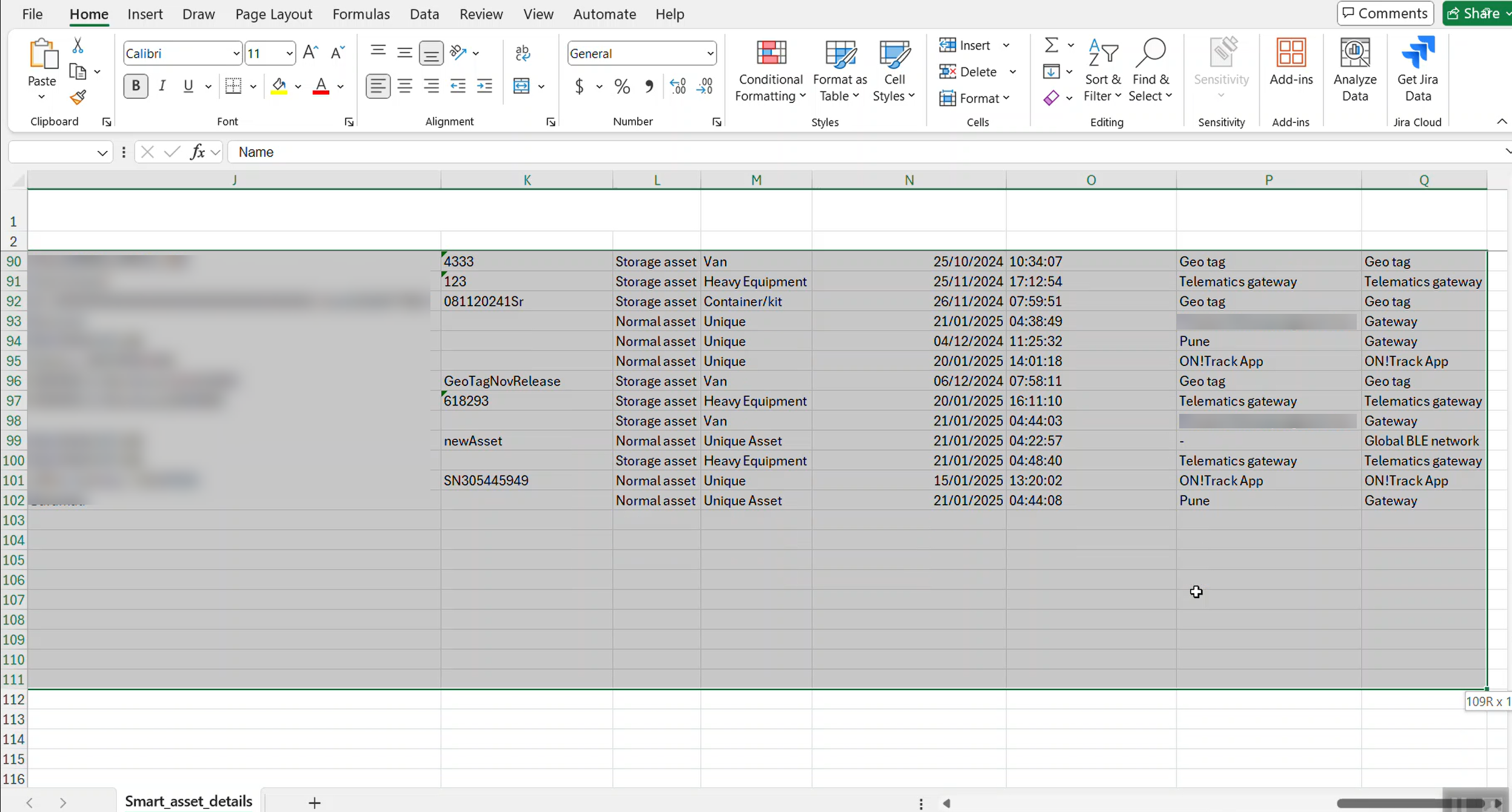

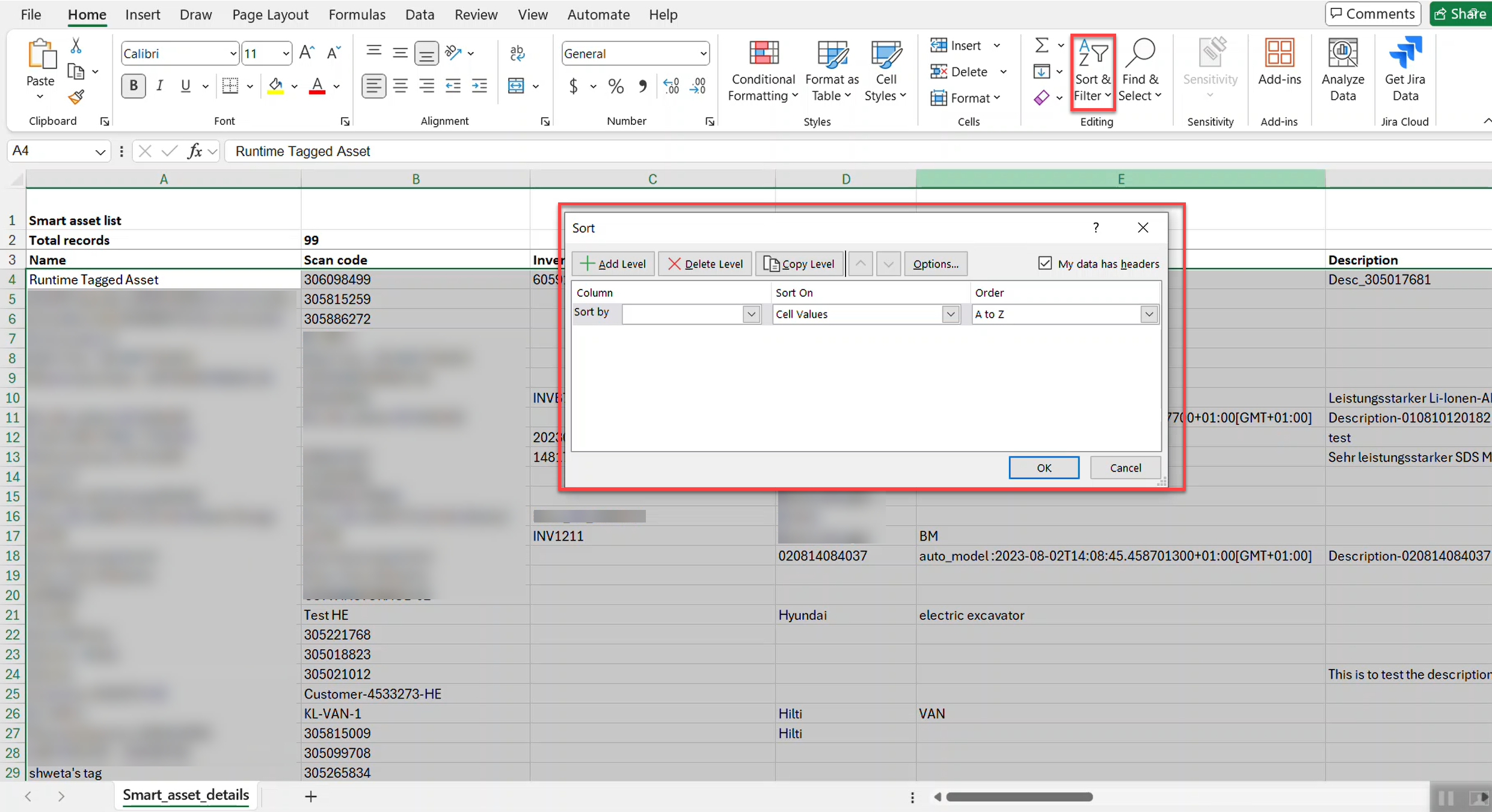

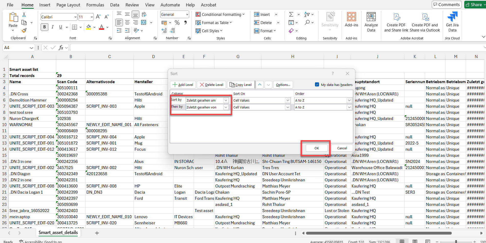

  • To sort the exported Smart Asset List by "Last Seen Date" and "Last Seen Time", select the entire sheet. Use the custom filter option in Excel to organise the data as needed.
  • Add sort by "Last Seen date" and "Last Seen time" and click on ok.
  • You will see that the content is sorted as per "Last Seen date" and "Last Seen time.
