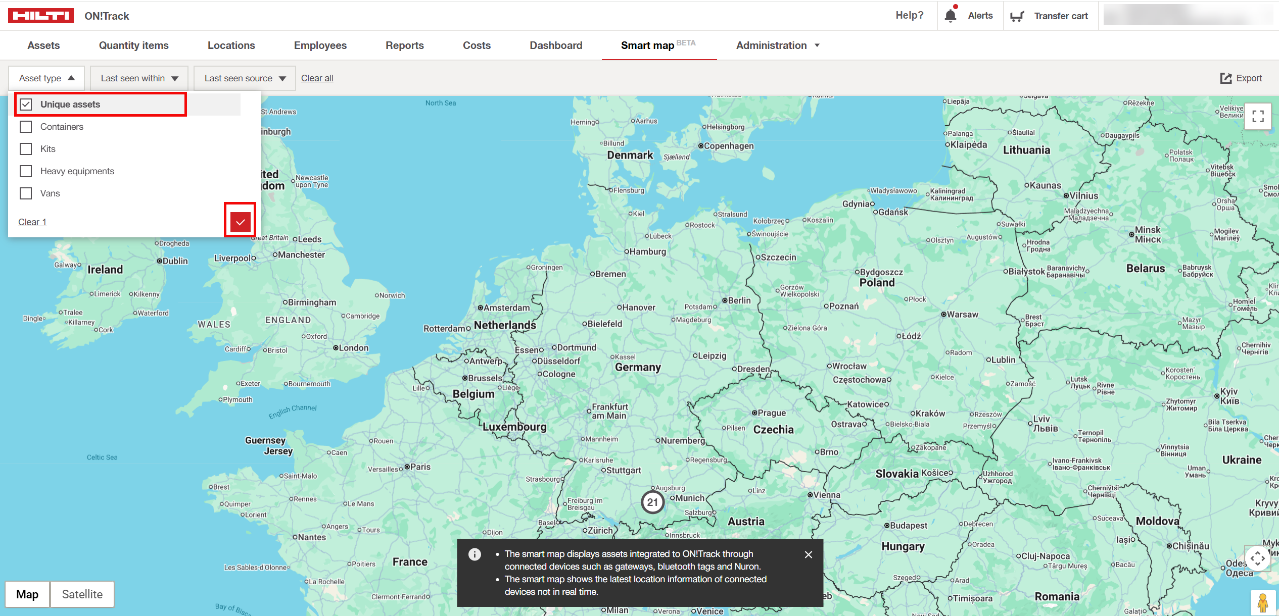

On Web Platform:
  • Select the Smart Map tab on the screen.
  • Choose the asset type and zoom in to find the desired location on the map.
  • Select the desired asset to view its details.

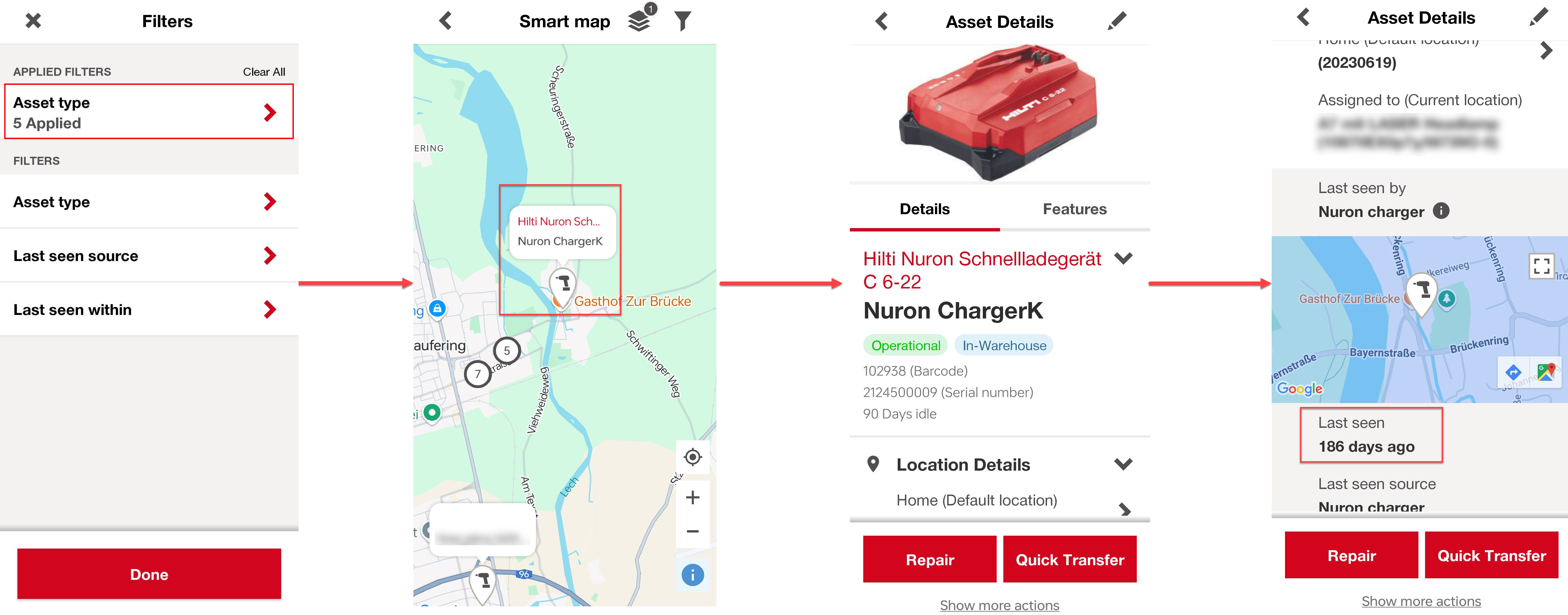

On Mobile Application: (Update the screenshots after release)
  • Open Smart Maps, click on the filter option, select the asset type filter, choose all the asset types, click Apply, and then select Done.
  • Open Smart Maps, click on the filter option, select the Asset Type, choose the desired options, click Apply, and then select Done.
  • Zoom in, select the desired asset, and view its details.
