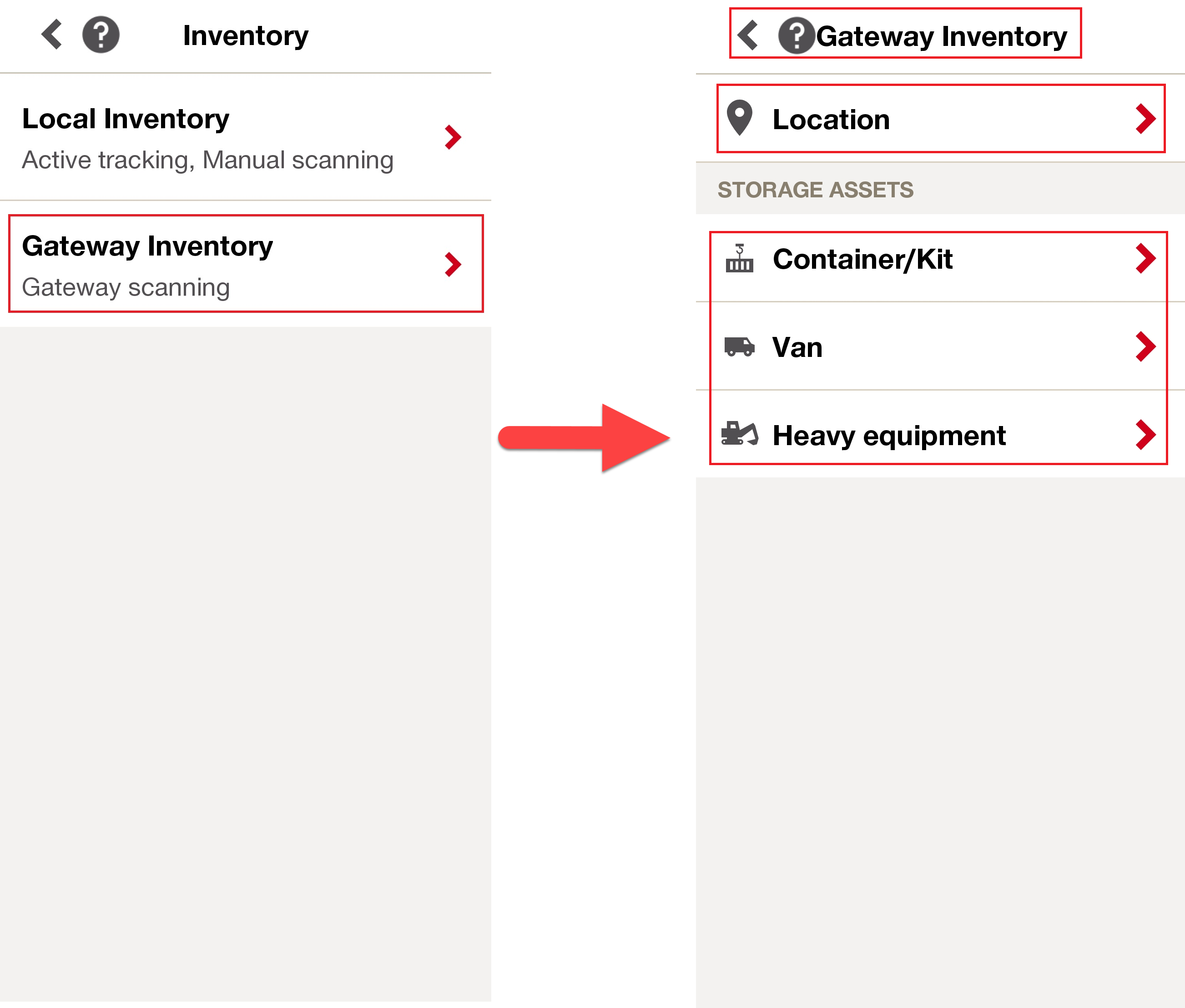

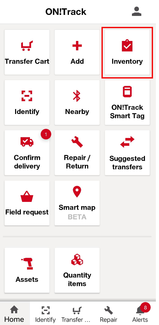

  • Click on the "Inventory" tab.
  • Select "gateway inventory" and choose either between Location or a specific storage asset (e.g., Van).

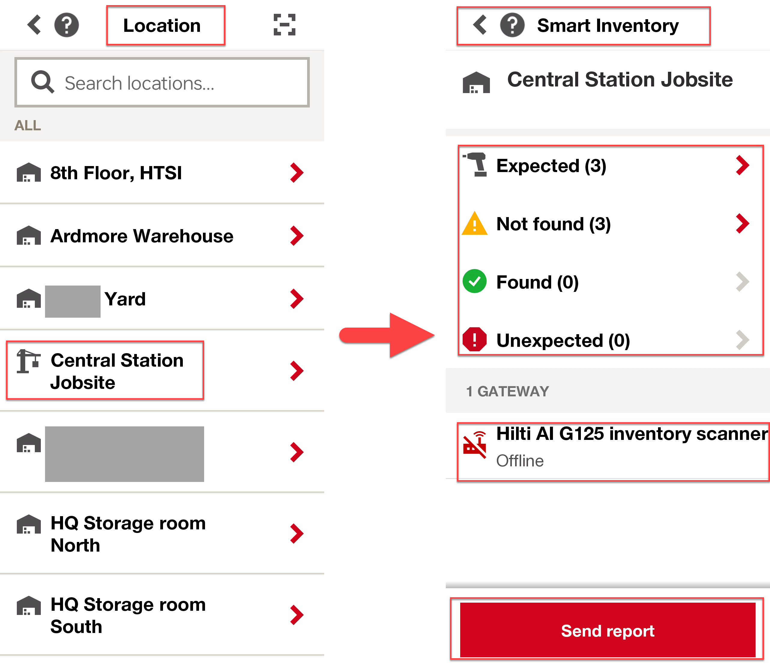

    • Select the required location. Per location, you directly see the inventory check
      • Expected: Which assets are supposed to be in that location?
      • Not found: which assets are supposed to be in that location, but couldn't be found?
      • Found: which assets are supposed to be in that location and could be found?
      • Unexpected: Which assets aren't supposed to be in that location, but could be found?
    • If you click on any of the above categories, you get the details where the assets were last seen (in particular relevant if an asset couldn't be found).
  • Click on "Send Report" for that location. The report will be shared with the requester via email.
