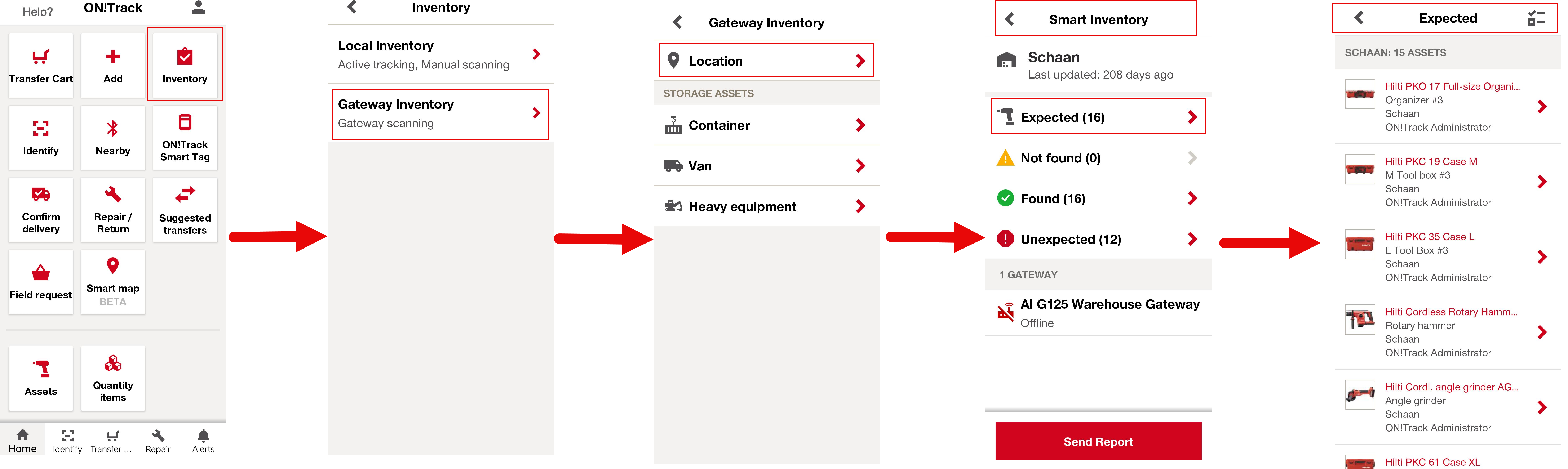

Instructions:
  • Open the ON!Track mobile app.
  • Tap Inventory Select Gateway Inventory.
  • Choose the type (Location, Van, or Equipment).
  • Select the specific item from the list View the inventory categories:
    • Expected
    • Found
    • Not Found
    • Unexpected
  • Tap any category to see detailed items
