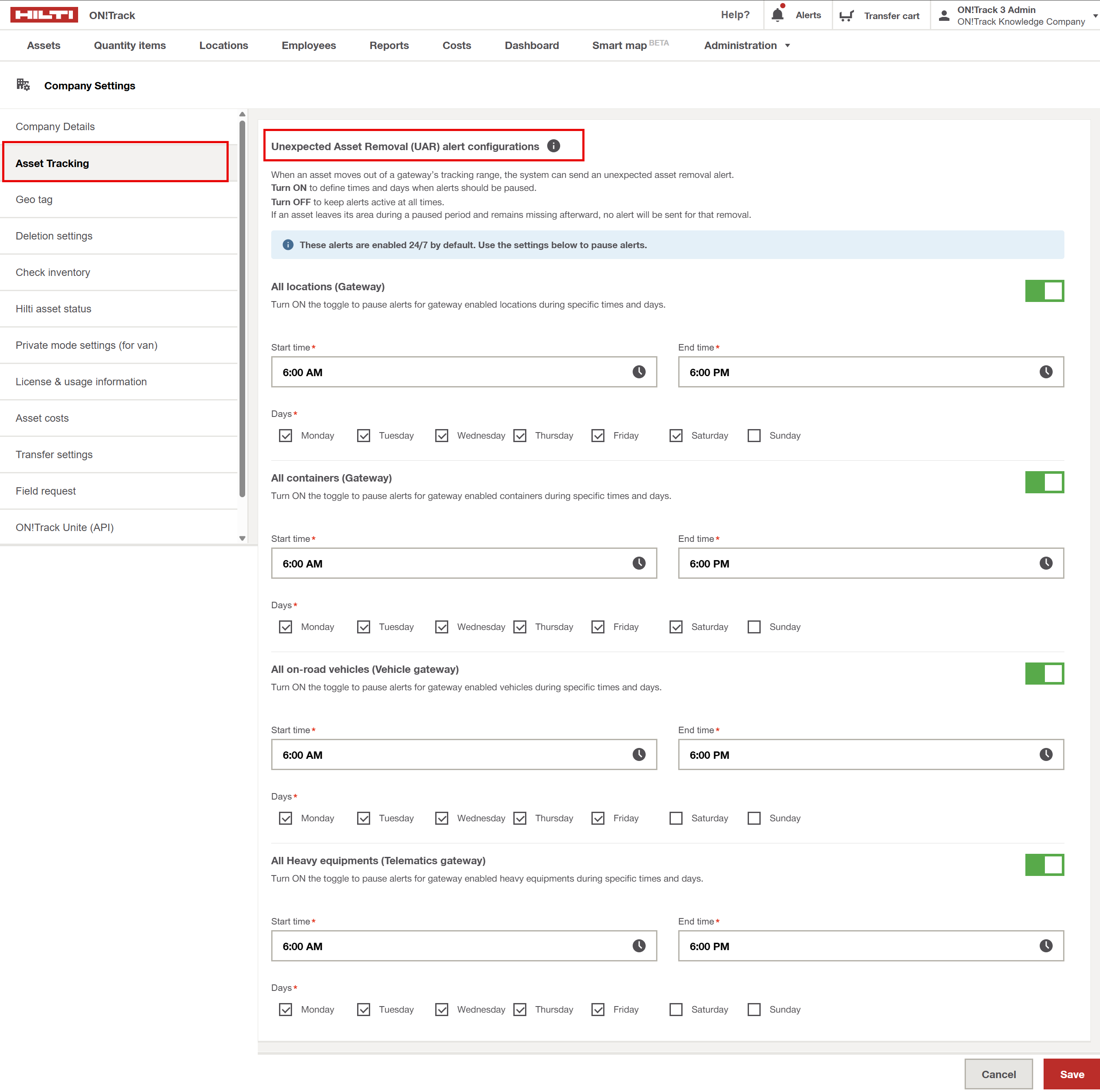

UAR alerts setup
Applicable for Admins and Support Admins. They configure this via Company Settings → Asset tracking, where the "Unexpected asset removal (UAR)" section appears. Settings can be configured for each day of the week including timings
During this window, UAR alerts are not created.
