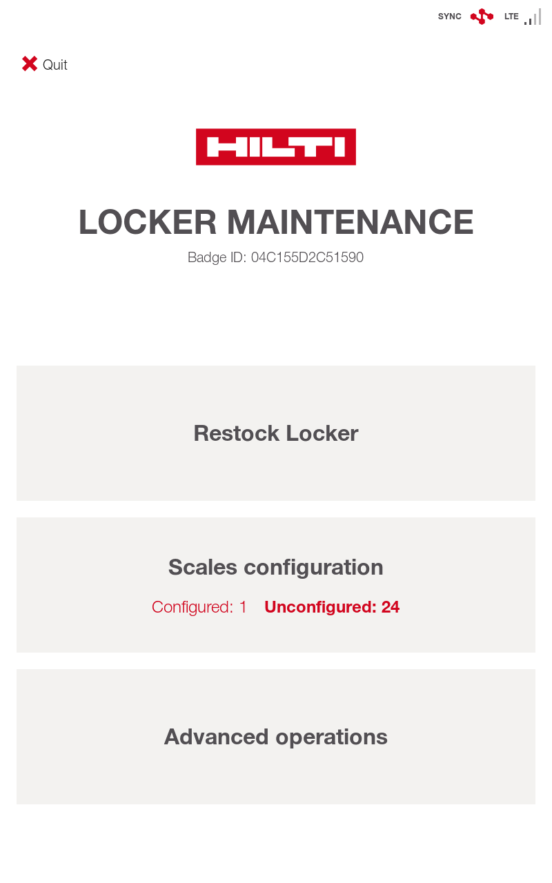

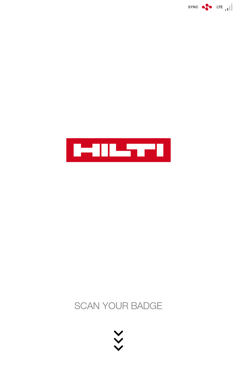

Open Scales Configuration
  • Scan you black batch.
  • On the display, the Locker Maintenance page will show up. Select Scales Configuration.

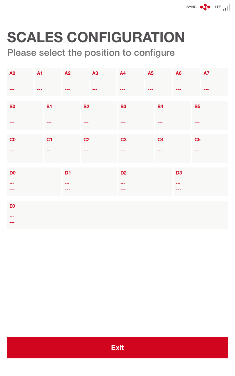

  • The locker doors will open, and the display will show the internal layout of the Connected Locker.
Notes:
  • Only modify the positions you want to update.

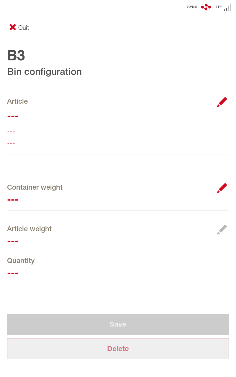

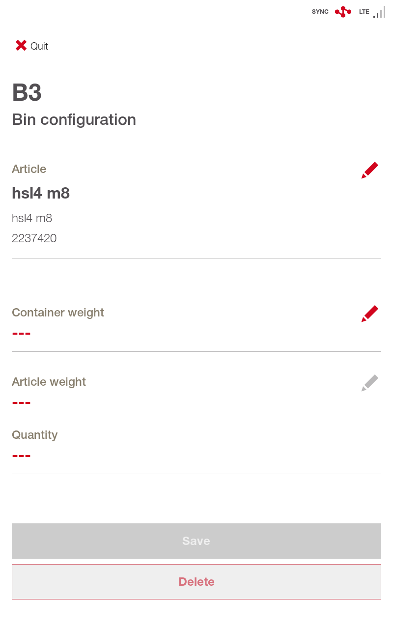

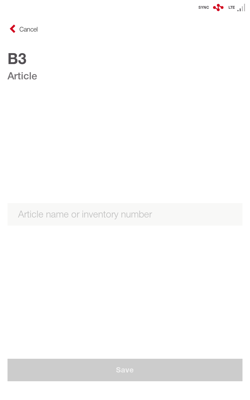

Step 1: Select the Item
  • Tap the red pencil icon next to Article.
  • A search bar and a keyboard will appear.
  • Type the item name or item number.
  • Select the correct item from the list.
Notes:
  • The item must already exist in ON!Track.
  • If it doesn’t appear, it needs to be created in ON!Track first.

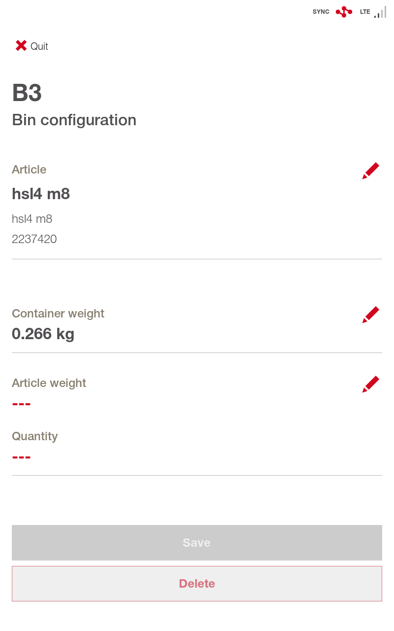

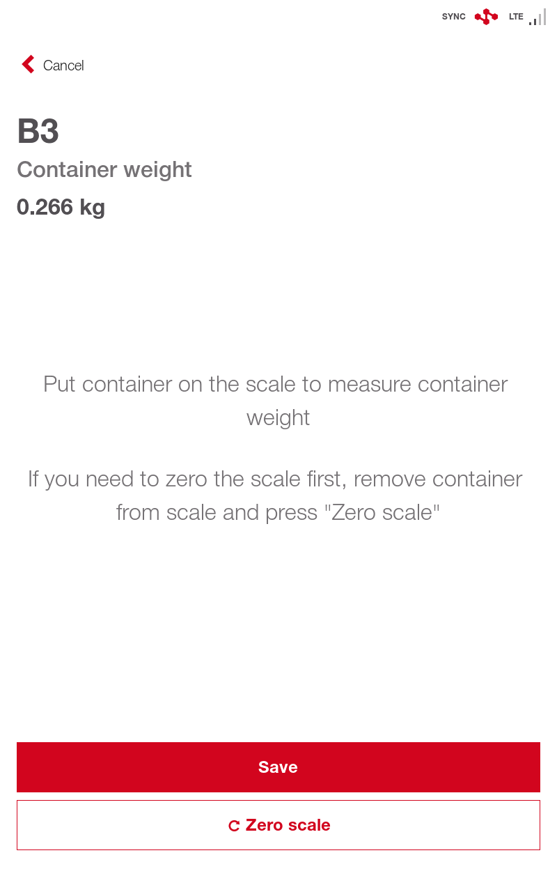

Step 2 : Set the Container Weight
  • Tap the red pencil next to Container Weight.
  • Remove the empty container from the scale.
  • Tap Zero scales to reset the scale.
  • Place the empty container back on the scale.
  • Wait for the weight to stabilize.
  • Tap Save.

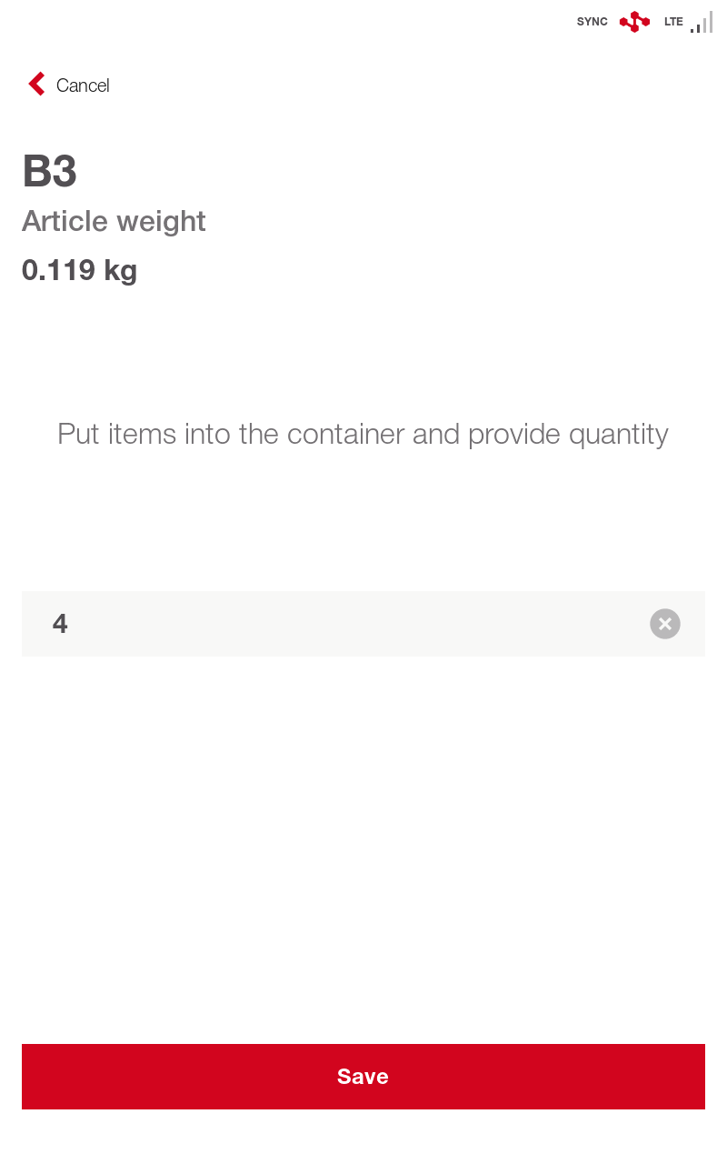

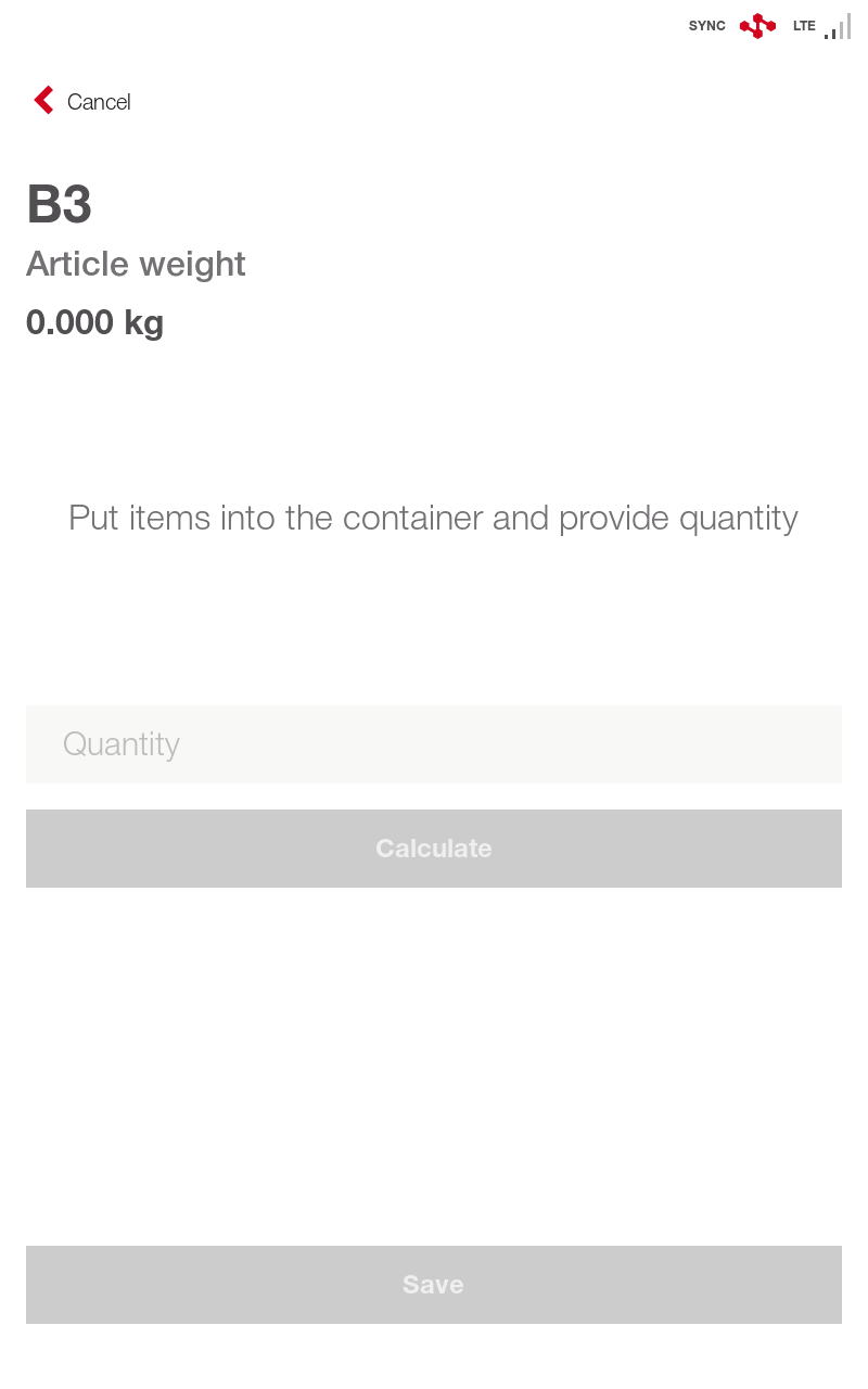

Step 3: Set the Item Weight
  • Tap the red pencil next to Article Weight.
  • Place the items inside the container.
  • The scale will show the combined weight.
  • Enter the quantity of items.
  • Tap Calculate.
  • The system will display the weight of each individual item accordingly.

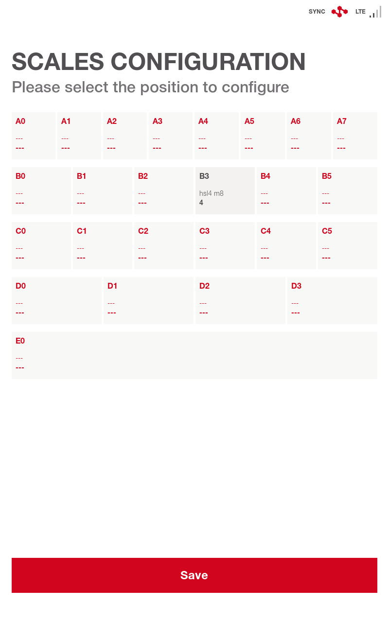

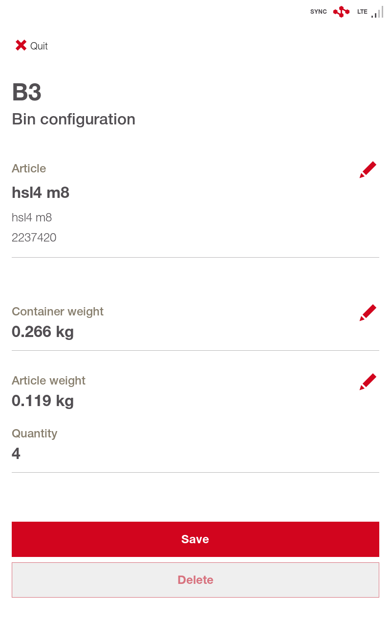

Step 4 : Save and Complete
  • Tap Save to complete Step 3.
  • Tap Save again on the main screen to finish.
  • Repeat for other positions as needed.
