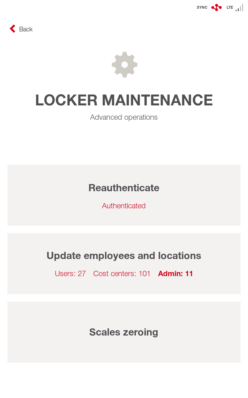

Advanced Operations
Use this option for additional updates, including:
Reauthentication - This will reset the entire locker to a factory‑like state. Use this only when the tablet shows “Not Authenticated.”
Syncing employees: How to manage the users' access to the connected locker and locations: How to manage locations/cost centers for the connected locker from ON!Track.
Zero all scales - Triggering this action will perform a mass zeroing of all scales in the locker. This means: Every container will require a fresh calibration afterwards. The entire locker will be reset to its factory‑like calibration state.

- When you add new employees or locations/cost centers in ON!Track and want them to appear on the Connected Locker, go to Advanced Operations and click Synchronize.
